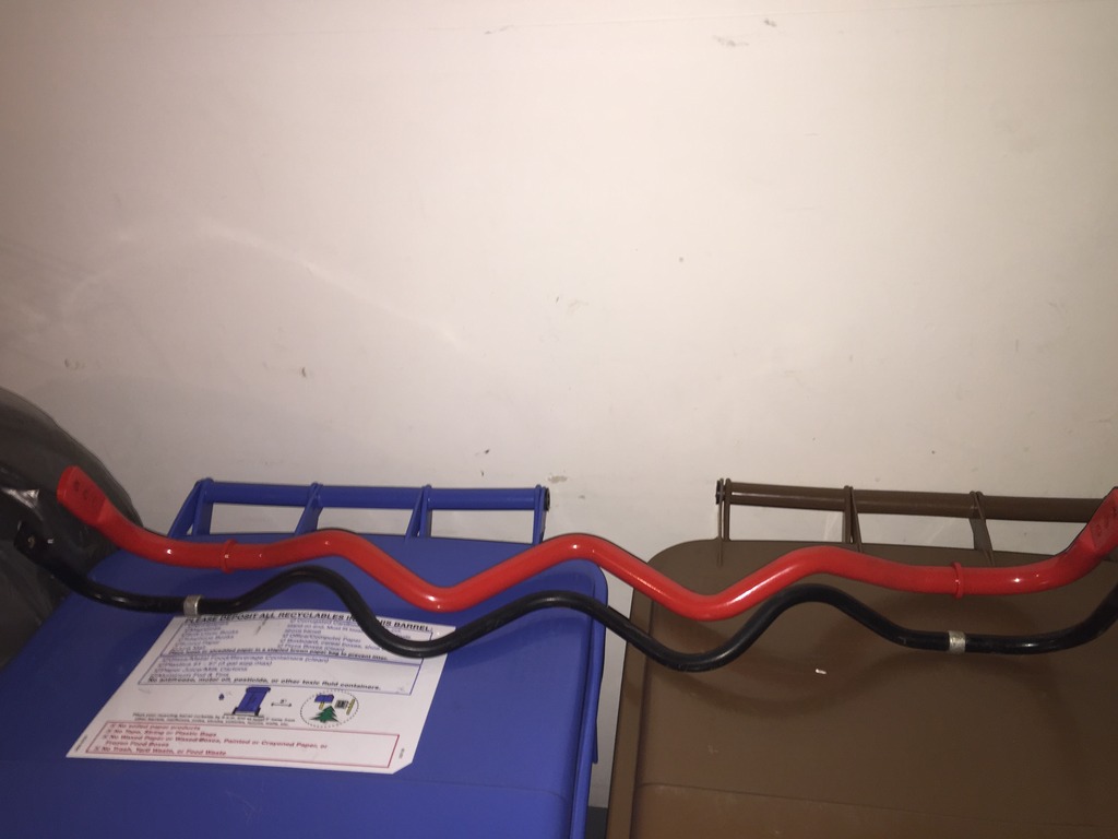

I couldn’t wait any longer so I had some free time to install the Eibach rear sway bar last night. The process took about 30 minutes once I got the rear backed up on ramps. It was pretty straight forward. I have the power tools so I made quick work of the nuts/bolts. The Eibach rear sway came with bushings and some grease packets. I ended up going with Prothane bushing lubricant (contacted Energy Suspension and had them send out 6 of the small packs - only used 3, so I have some left over).
It just amazes me how this the stock AWD Sedan rear sway bar is - I mean to read about it from others and to finally get down there and remove it…geez. The feel of the Eibach is very hefty - I think it’s 29mm or so. I used the mildest setting for winter driving, but will experiment to the middle setting in the spring.
I took the car out for a drive last night but didn’t push it - felt sturdy and noticeably different. Then I took the car for a drive this morning and jumped on the hwy with moderate speeds and turns. Really feels like the car behaves better and more neutral. took a turn at a location which used to give the car some unwanted understeer at speed, now with the improved rear sway bar - understeer is gone!
Overall, I’m happy with the immediate positive results. I’m anxious for the spring so I can get everything else dialed in - 19” wheels, performance tires, lowering springs, etc…my basement is a holding bin for all of my mods LOL.
So for those of you that don’t want to go the Hotchkis route or OE rear sport sway bar, the Eibach is a great alternative. I was able to pick mine up for $165, I’ve seen it as high as $210 at Stillen.
Eibach Part # 6393.312
Here’s a pix of Big Red next to skinny mini

Wow, that's a huge difference. Can't wait to get my Hotchkis front/rear sway bars and swift springs this Spring.

Anyone who's pushed the G Sedan into a turn knows that the car understeers. Really bad, too. Even the RWD Sport model understeers. It's a horrible and helpless feeling. But all you have to do to correct it is upgrade to aftermarket swaybars. Instantly, understeer is gone, and you can oversteer on command. (Assuming you turn off traction control.)
It's always fun to read the OMG moments from members here. Good for you, CPJ LB!
