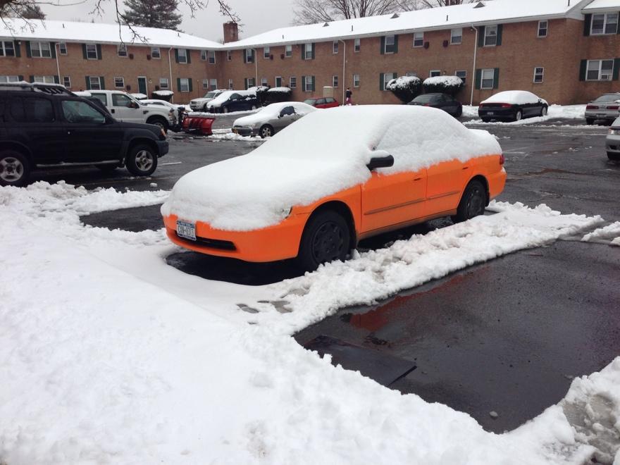

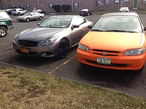

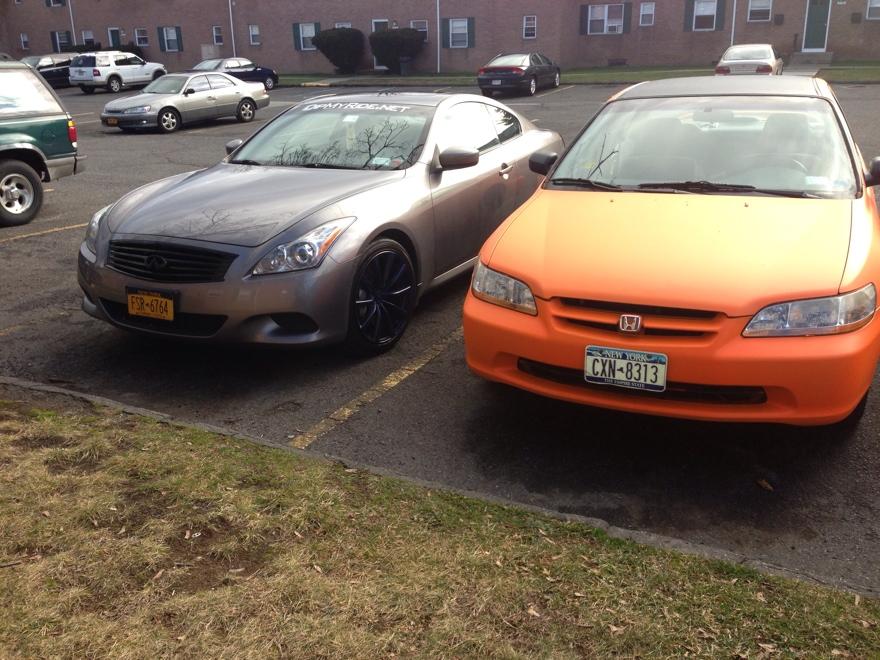

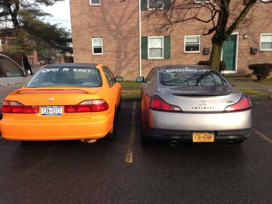

Did you use cans to dip the grille? You get a MUUUUUUUCH smoother service using a HVLP spray gun. The only thing I use cans for is the wheels since they're beat on 24/7. If dip done properly it's actually hard to distinguish it from vinyl wrapping and sometimes even paint. You can see below, my grille is painted gloss black by 180customs and the emblem is plasti dipped gloss black by me.
The G is going to be the same color as that A4 above. Don't worry I'll take lots of pics of the G when it's done. But in the meantime:
Here's my accord dipped (used to be silver: dipped matte fluorescent orange and roof matte black):
I am fully aware you guys don't like decals..I'm advertising my loacal business and it gets me sales so I'm not taking it them off any time soon.
Edit: Phone pics kinda make the color lose some hue but here's a more accurate color picture (I still need to peel the orange off the black skirts and the thing on the door):

Rocks probably won't cause peel. The plasti dip itself is pretty strong. Like you said you can peel it with your fingernail but you have to use a little force. Of course someone can come up to it and peel it but they can also key your car. It's better to have that extra layer of protection especially if your car is outdoor kept in an apartment complex like mine where it's more succeptible to door dings and stuff.
When you spray it out of a gun, it does have a much smoother texture to it. Not sure if this affects its general structure but it does look a hell of a lot better!
So far on my Honda I've been through a car wash, done highway driving, and even scraped snow and ice off very roughly with a brush and its still flawless. One bright side is definitely not worrying about swirls or anything in your paint. Plasti dip is rubber so it has more tolerance to rocks and debris because it can flex and bend.
