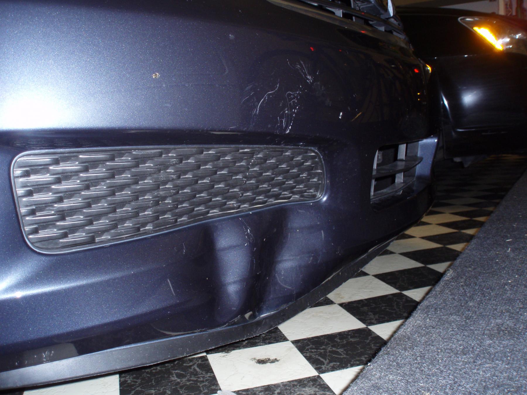

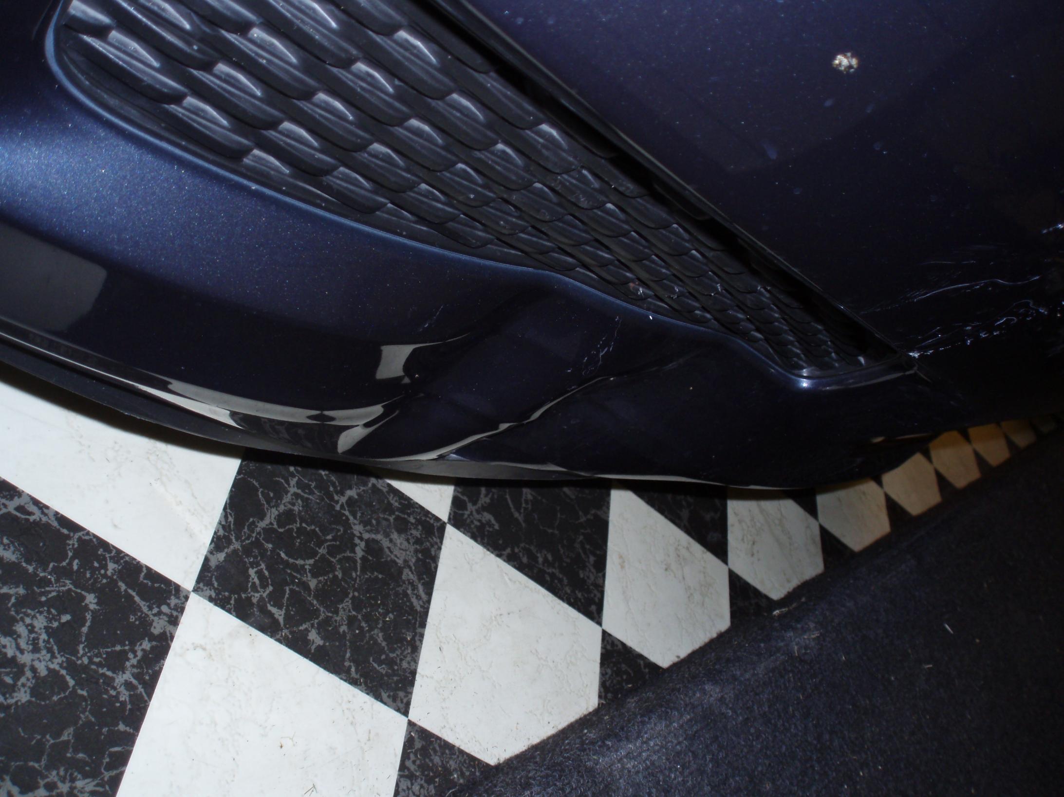

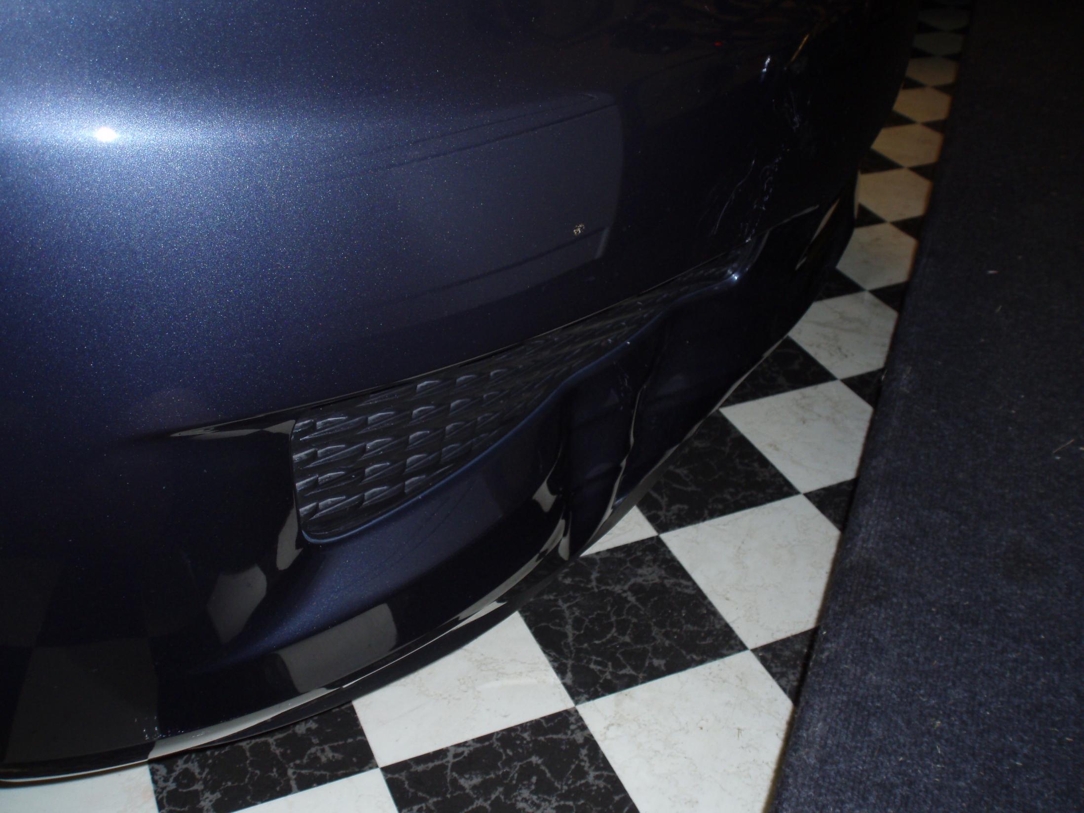

So, I purchased my G37 about a month ago from my local Infiniti dealership. Brand new, Blue Slate Sedan with beige Interior. This car has been a pleasure to drive, but I had not taken it on the highway for a long stretch yet and my buddy thought, "Hey man lets take the G to OKC and let it breathe on the highway". I thought, "Ok, sounds like a good idea". This conversation I know regret deeply.
To make a long story short, on the way home, a large 18-wheeler blows a tire in front of me (I however did not see this). The car in front of my veers to the right to avoid the tire and before I knew it, WHAM!, rubber hits my fender. I thought nothing of it and drove home thinking that it did minor damage when in fact, it did a good amount of damage.
My question to you all is how much do you think it would cost to fix the front fender? It looks to me like its going to be a major job to replace the entire fender as it appears to be one piece, what do you think?
Anyway, I have attached some pictures for your perusal.

Ouch. Looks like you'll have to replace and paint the front bumper cover. I'd guesstimate maybe $800 or so.

new bumper cover (to be painted) and new grille insert.
it's actually cheaper to replace the bumper and paint it than to try to fix what you got there.
maybe 1000 overall

Ouch man. Sorry to see that. I noticed you said your in okc, what part if you dont mind me asking. I'm in the Edmond area (in norman at school right now). I had to have mine replaced and painted also. Did you get it from Bob Moore? Even if you didn't I'd take it to there collision center. I made the mistake of going to a place called Pucketts Auto Collision and the fitment and paint could be better. My friends dad's got a 04 G35 in midnight blue and had his rear bumber done at Bob Moore collision center and they did a top notch job. Paint match was perfect and it looked like it never happened. I'd guess it will be anywhere from 800-1000. Let me know if ya need anything else

I have hit those freaking retread truck tires before (not a blow out). The retread peals off like a banana and it happens so fast you can't do much to avoid them. Sorry it happened to you, but it is at least a cosmetic repair and nothing structural.

What I would do is use a Blow dryer and aim it at the dent. I'd also use a suction cup to try and pull it out. If that doesn't work, leave it in the sun for about half a day(personal preference), and it should come out like a charm! Any other scratches I'd leave the Scratch Shield Paint to handle. Hope this helps!

Sorry, but there is no way you can pop that out and have it be perfectly smooth or not have creases. And that scratch shield paint is more for tiny little haze and swirl marks, not full blown scratches.

Yea I would have to agree, the scratches on it are pretty bad. In fact, the damage to the car may be more extensive than I what appears. When I ran over the tire there was a loud noise as it exited out the rear. I'm starting to wonder if it may have damaged anything in the under carriage as well. Good thing I have comprehensive.

Take a heat gun to it and push from the back. You can pop the dents pretty easily, but it may still have to be replaced. It may have not been creased if you are lucky. After you pop them if there are no creases, then you can get away with just repainting it. If it is creased then you will have to buy a new one, paint it and install it. You are easily looking around 1000 dollars.
