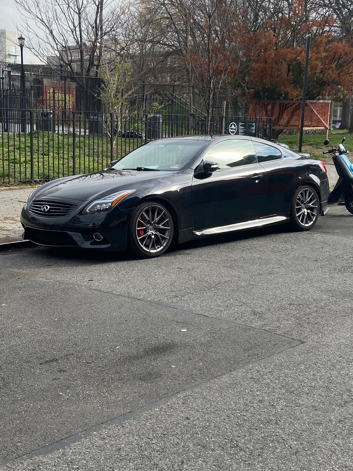

Hey all, currently purchased a G37x coupe about a month or so ago, about 200k on the car. Well maintained for the most part. However the car went into limp mode recently and after scanning the car I got the dreaded P0524 code. So I’m currently planning to put a low mileage VQ in it at RAD in Queens. Since the car is out of commission for the next week or so and I’m dropping it off Tuesday, thought I’d try and ask around for info on VR 7AT swaps. The team quoted me at about 4.5k total for the trans swap, but I reckon I can get it done for cheaper. I was swapping in the trans eventually to prep for boost, but since the motor is gone, figured I’d do both at once. Any help or places to search are appreciated, especially those who have swapped their trans in and around the tri-state area
(obligatory attached pic of the G as she is rn)
