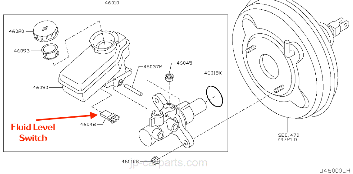

In looking at various parts diagrams and images, you should be able to slide out the old switch and pop in a new one:
The only potential issue would be seals/ o-rings and making sure they are intact.
I do not know if the switch can be replaced with the master still connected to the car. There is VERY little space to work in that area and none of the factory manuals state any methods to remove just the switch. Keep in mind that brake fluid will destroy painted areas if spilled.
Either way, I think replacing the whole master just for the switch is overkill and not necessary.
Thank You for your very informative reply. I have scoured the internet for someone else who may have had this part replaced and literally find Zero. Very odd, gotta get another opinion from a different mechanic I know.

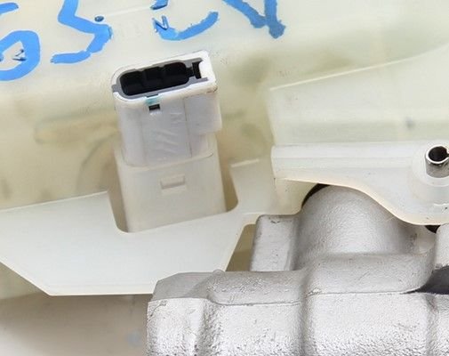

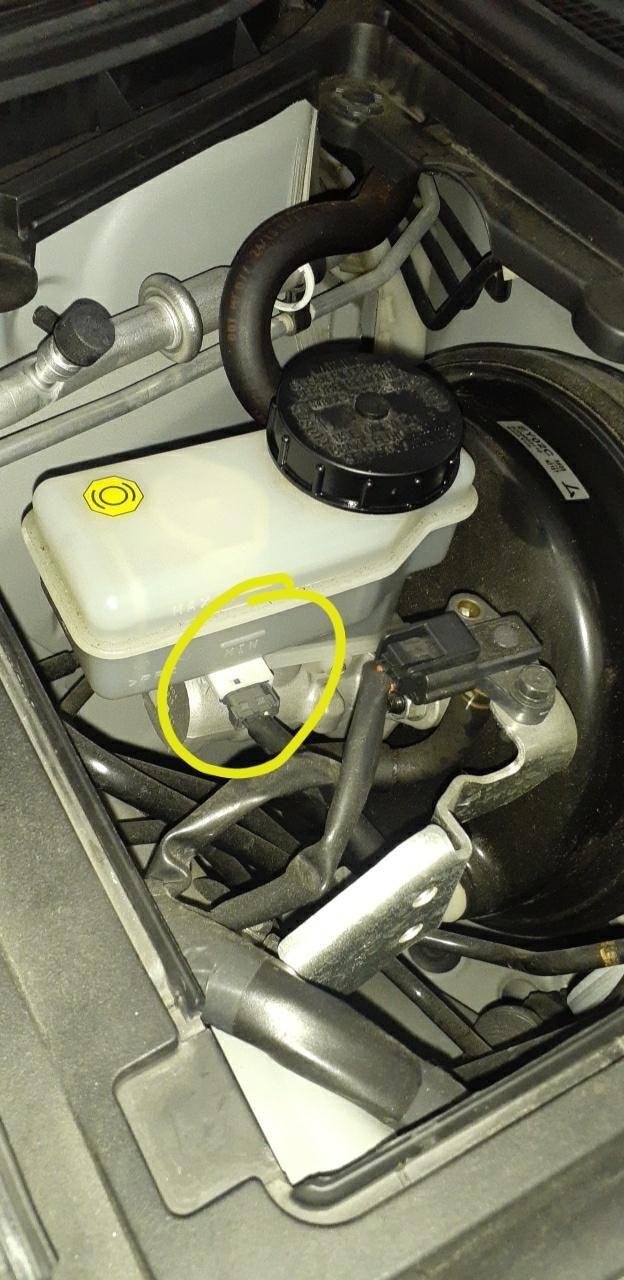

Looking at the picture, it seems to just clip in.
I investigated mine and it seems accessible. I also noticed the sensor wiggles in the socket so i'm not too sure how - or if - it seals.
If its the same same as the G-35 then according to this post brake fluid sensor replacement - G35Driver - Infiniti G35 & G37 Forum Discussion its is a contact sensor and doesnt make a mess when its replaced.
Good luck and keep us updated!
