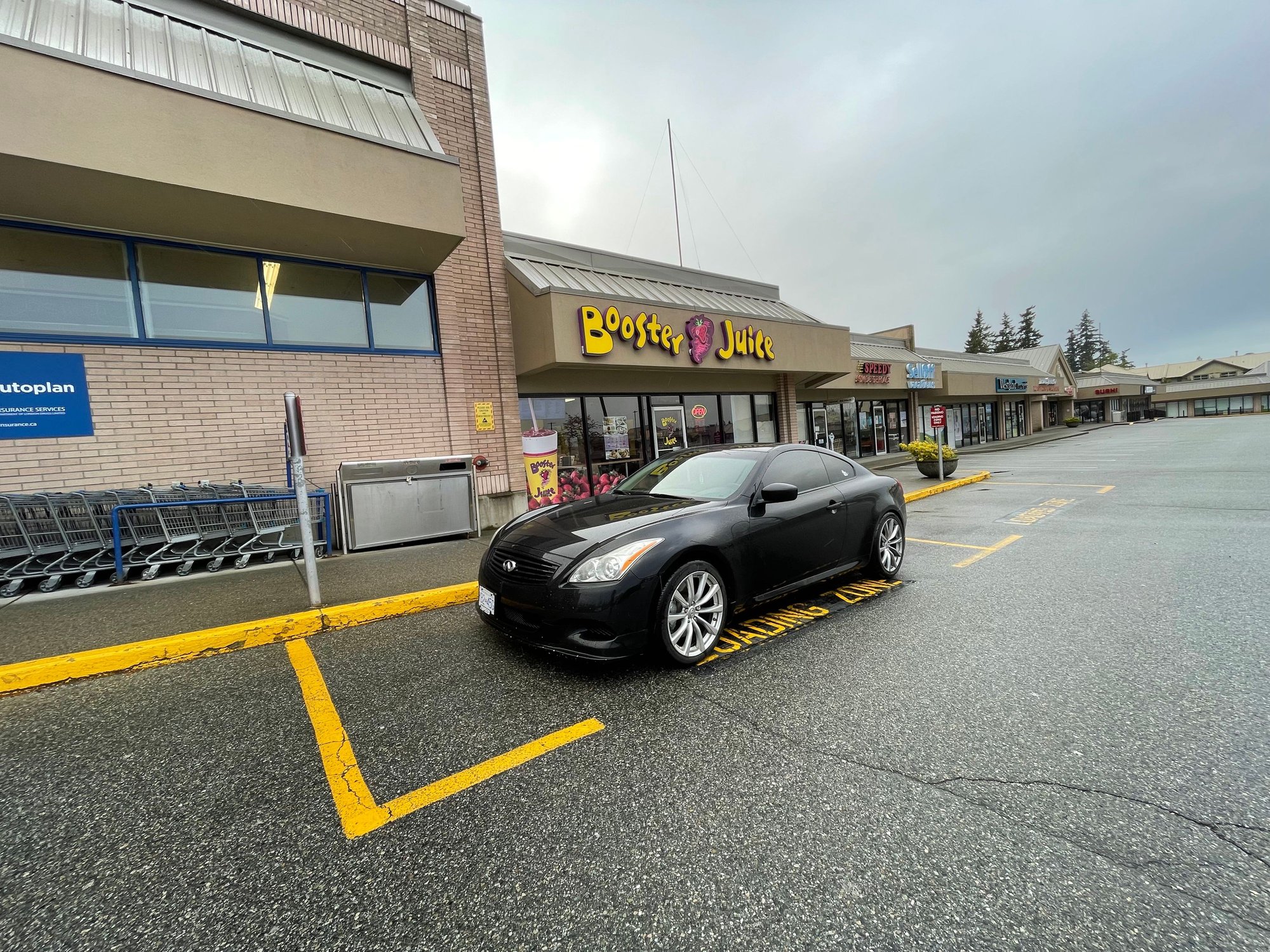

/story. Thanks for reading this far. Tried to be as detailed as possible! The whine sharply increasing in volume over bumps is probably what gets me the most. Just seems really odd. Could the rear subframe bushings be getting loose and moving, causing the pinion angle to change and cause the whine? Seems low mileage for that, but 6MT's are a lot harder on driveline bushings than autos due to the constant clutching in and out. Any and all answers appreciated! Always happy to learn something new. Added a pic of my bish to make up for the text vomit.

No text vomit found, that was a very well worded first post. Welcome to the forum, Slabba428.
With exception to this mystery whirr, it reads like you've got a fantastic car there. So if blame for this noise becomes increasingly focused on the rear diff, perhaps this is enough motivation for an upgrade to shorter gears, and a diff rebuild with new bearings. It's not an inexpensive mod, but it's so worth it.
