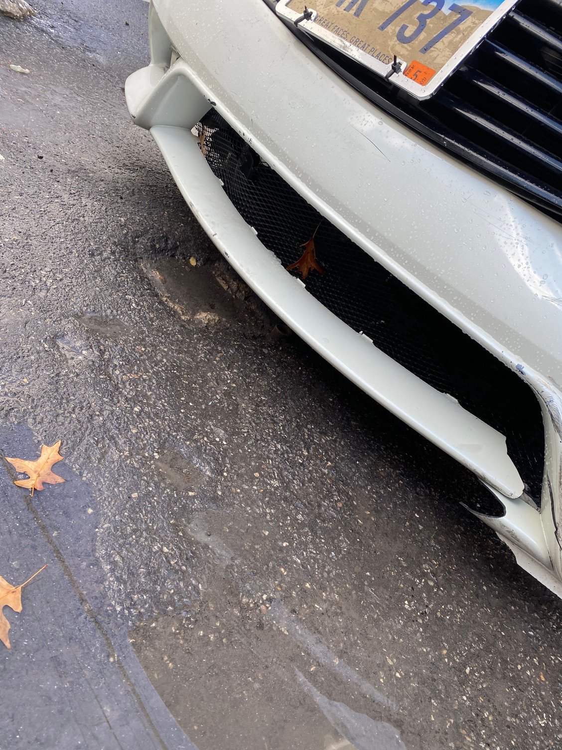

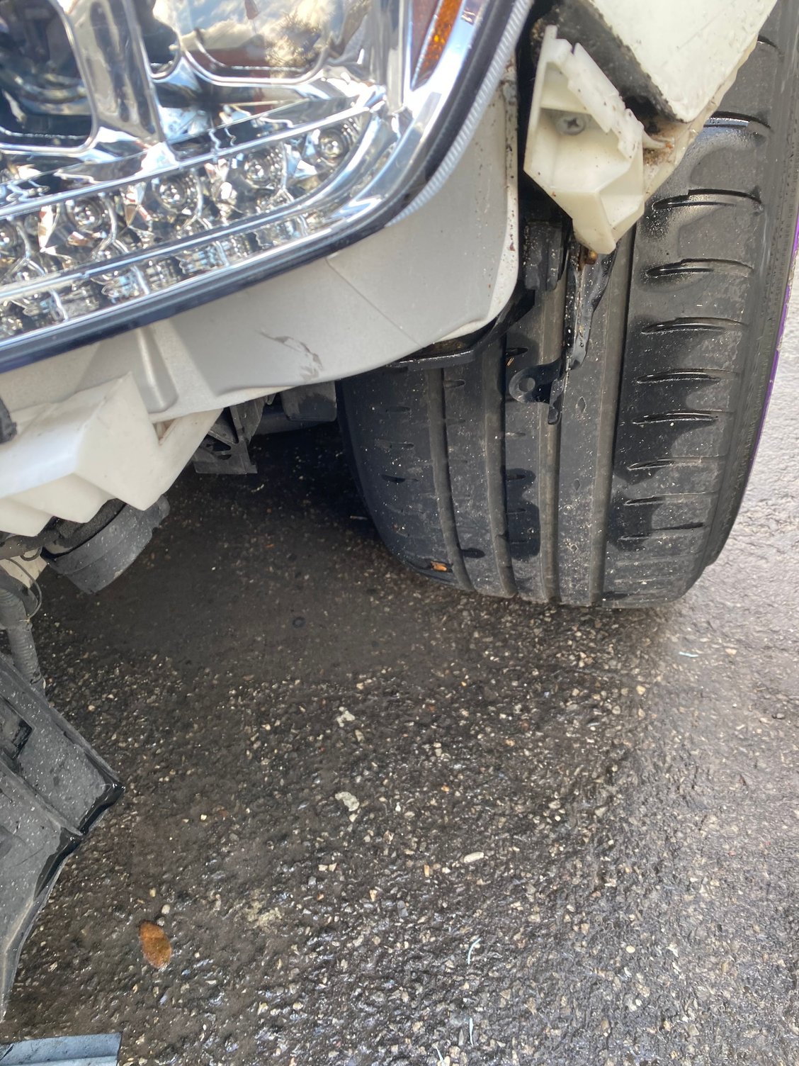

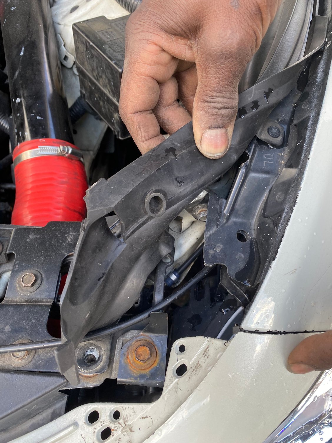

Wassup ya I cracked my bumper ordered a new one and got it painted now when I wanna get it installed the mechanic is still me I need stiffener brackets but I have one on the drivers side already and I bought one for the passenger side but he is telling me I need two more is this true ? I also got the metal peices that I am missing

Yea you're missing the plastic pieces that hold the bumper tight to the car in the engine compartment. Left, 62059JL00A. Right, 62058Jl00A. It might say sedan when you search but it fits the coupe too.

Don't know if the mechanic still has the car but you can install the bumper without them until you get them. You'll just have a small gap where it meets the fender. You can put them on yourself because they just install with a 10mm socket.
