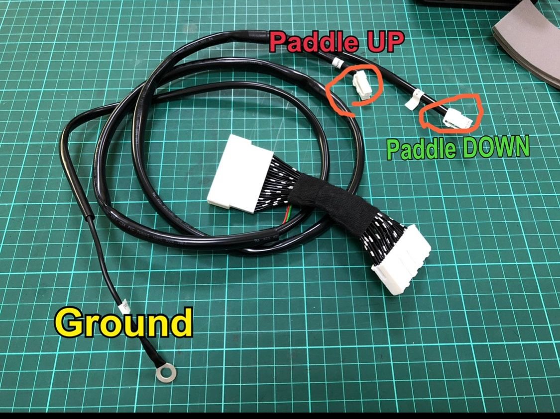

I own a 2008 G37 Coupe Journey. I ordered the paddle shifters for my car, only to find out that my car does not come with the wire harness to plug in.
Wondering if anyone in the SOCAL area has made their own wire harness before and if anyone would have an interest in doing mine? I am not a mechanic or technician, therefore I would prefer someone else with experience do it.

@Oscar Zejdlik I also had this problem on my 08 Coupe. I had to search around for a bit as I was going to wire up my own harness for it. In my search I had found out that there is someone on the EX/FX section of the iS forums that make a harness for the paddles. I think his username was rex0926. Anyway, I asked him how much and he sent me one for about 100 usd with shipping. I payed him via paypal and it came from Taiwan in about a week. This was roughly 2 years ago and his post about these were about 3 yrs prior. You could look for him and message him to see if he stills makes them?
That was the harness photo he had sent me a while back. Install was pretty easy and I have not had any problems with it! Hope he is still around, If I happen to find his email, I will pm you.

Thank you SO much for the reply on this. I was beginning to lose all hope in installing these bad boys. I will look for him

Oscar, if you had read the post, you would notice that the vendor is not a member of myg37.com but rather a member of Infinitiscene.com (hence the "iS forum" BxG3? stated).
A simple Google search and I found the guy. His screen name is rex9271 on Infinitiscene.com. And, yes, he is in Taiwan.
Here is a link to his classified listing for the M37 Paddle Shifter Kit. You will have to create a account over at Infinitiscene.com and you can send him a direct message that way. As far as paddles go, whether it is the EX/FX, M, G, or early Q50/60's.. they are all the same damn thing. I am sure he can hook you up- for a price.
