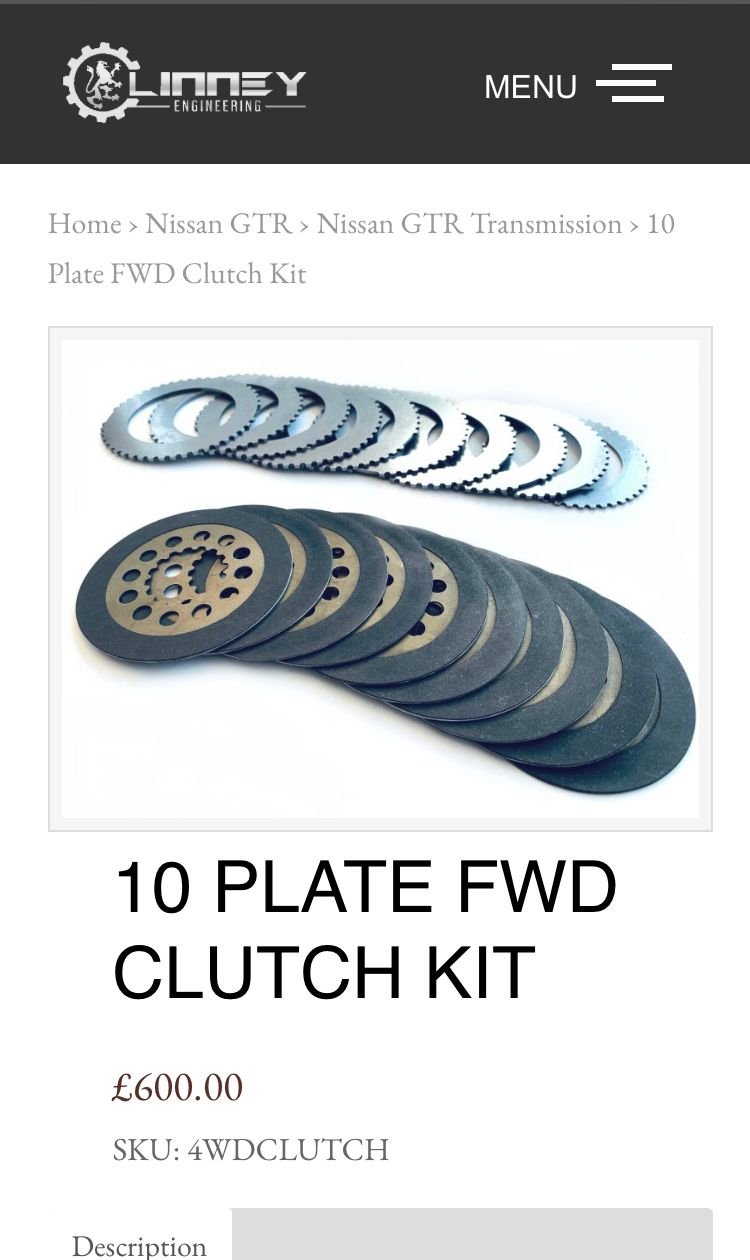

Posts: 126
These are upgraded and added clutches for the transfer case

The GTR clutch packs is a no. Why? The R35 GTR uses a type of trans axle in the rear just like the Corvettes so it's just not going to work.
As far as the front diff, the drive shaft flange is different meaning you'd probably have to change the yoke flange to the G one and at this point I wonder if its better to just swap the internals. Now looks like the R35 front is a 2.9 which wont work. You'll have better luck with other nissan/infiniti differentials to obtain the gearset you want however you can already tell you'll be better off modifying your factory one. Here's a thread with some data from Matt, hit him up since he's AWD and is venturing into the 12s.
Even though the G is a skyline and share similarities, you need to treat the G like a separate entity. I'm confident both differential can take the power with some good driveshafts. 800awhp can be a hell of a challenge the engine would probably be needing to be pushing close to 1000 HP to be able to give you that however I'm certain you see less than this. Why? you can count 1000hp VQ37s with your hands only. At this power the diffs should be the last of your worries, the trans WILL give up prior to.
