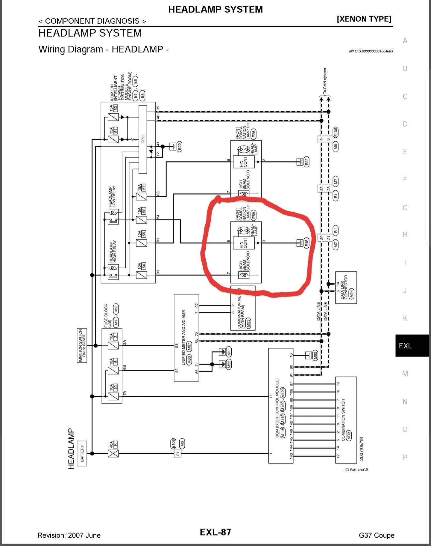

Hey guys. I just bought one of my dream cars. 08 g37. (Obviously). And the owner before absolutely did NOT take car of the car. Got it for a steal tho so its worth it. ANYWAYS in all i just need help figuring out what connects to what on the ballasts to the headlights. Everything on the driver side were directly connected to the headlight. So i had no previous knowledge. So that one doesn't turn on at all. The passenger one flickers. And i would love some help. THANK YOU

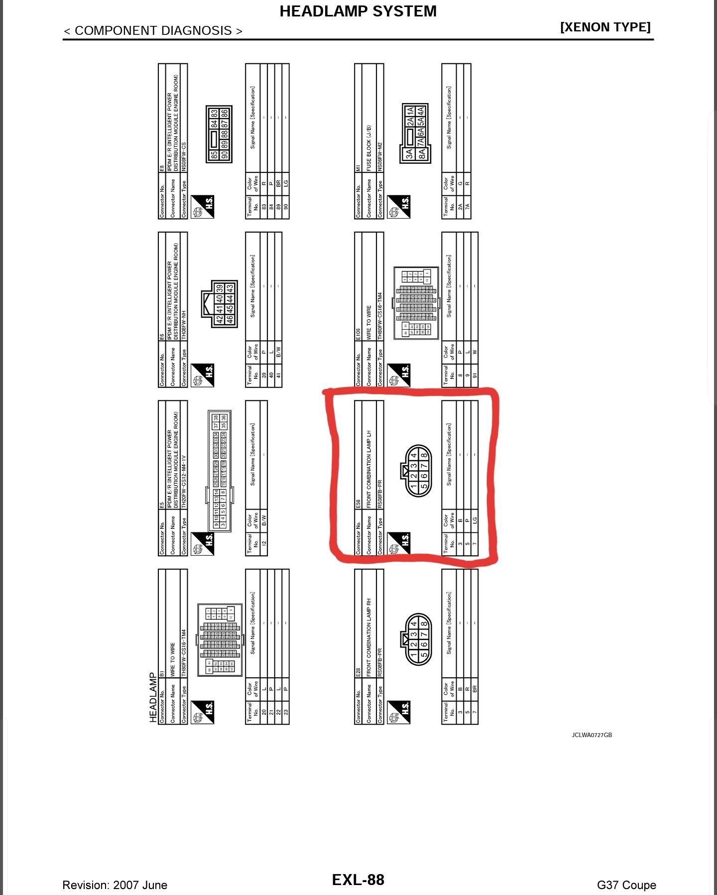

First, welcome to the forum and congrats on your new toy.
For starters, I suggest you go here and download the factory shop manual for the car. For your headlight issue you will need section EXL (Exterior Lighting) but I strongly recommend you download all sections. They will come in handy, trust me.
I am attaching two pics from the FSM outlining the headlight (HID) only. Technically, the "ballast" only has two (2) wires going to it: Pin #3 (BLACK wire) for ground and Pin #5 (PINK wire) for 12V+.
Keep in mind this is only for the HID/main headlight. Other diagrams will show the wiring for the fog lights, turn signal, and city/parking lights.
Not going to overwhelm you at once. Get the diagrams, look them over, and start putting the pieces of the puzzle in order. As much modding as I've done to the electrics (steering, AV, etc.) in my car, they are pretty robust. Just take your time and don't hesitate to ask for help.
