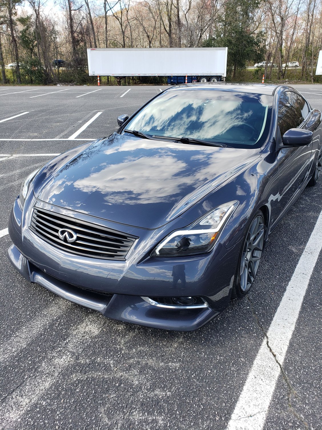

I just bought my 2008 G37s about 3 weeks ago and I bought it like the pics advertised... But I noticed that going over speed bumps or getting my car wash at those automatic washes are impossible!!! I need to lift it up about 2 inches...or so... It has after market EIBACH lowering springs.

You could just get stock AWD springs. Those would be the tallest OEM option.

Car looks good. Keep it as is and learn the ropes of driving a lowered car. I’m lower than you are and have no problems.

I have eibachs too. I dont go to automatic car washes anymore, not because too low, but more because they are terrible on the paint and they scrape up my wheels. See if there’s a handwash place near you or if there’s a touchless or self service bay.
Most speed bumps i approach dont do too much, even if i go at them straight on, but i slow down and approach slow. Try approaching at an angle.
it’s really nice as it is, but do what you gotta do.

Get some inexpensive coilovers like Tein Basics. It will save you money over higher end kits by forgoing adjustable damping. If you mount them at full extent, it will be lower than OEM, but higher than what you've got here. If you're wanting advice, I wouldn't raise it more than a 1/2" where it is right now.
That's a real pretty Coupe. The wheels look great in gunmetal against that blue, and the calipers really pop in gold. I even like the body side molding... you don't see that often, but it looks fine on your Coupe.

Add a second layer of rubber spring pads

Wheels sure do look good on his car though, don't they? Gunmetal against blue with gold BBK... fantastic combo.
