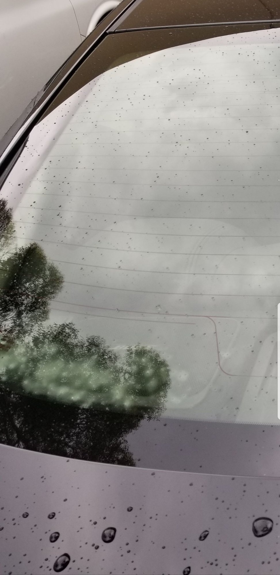

Hello people,
So I was noticing that my rear windshield gets so foggy that sometimes when I'm driving, I can actually see streaks of water/ condensation going down it. And when I haven't been driving my car (like in the following posted pictures, bottom corners), it'll fog up even while just being parked (it was a relatively cool day, around 50 degrees F and slightly raining).
I've also had a problem with my doors leaking water when going through a pressure wash/ hard rainy day, where it'll drip down the top speaker area of the door in a line down to the bottom speakers, both driver and passenger side. I've taken it to a dealership and after they did a "paper test" and presumably some window adjustment, it kind of helped with the amount of water leaking in, but not 100% completely. And on top of that, now I have some type of air noise when driving 80+mph down a freeway near the bottom left window sill of the driver door.
Do you guys think it's from some type of humidity being able to seep in even with the window/ door closed all the way?
Thanks in advanced.
