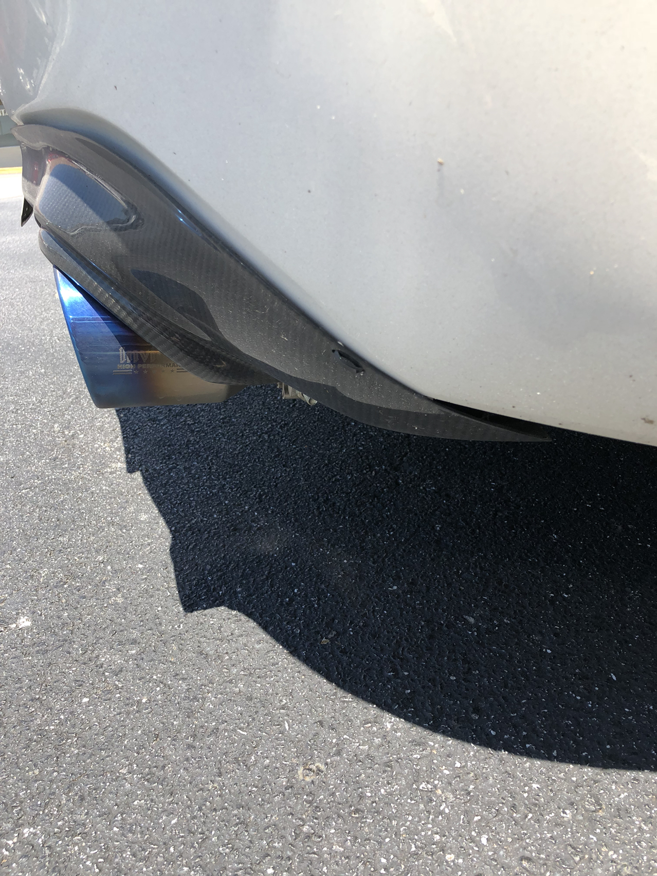

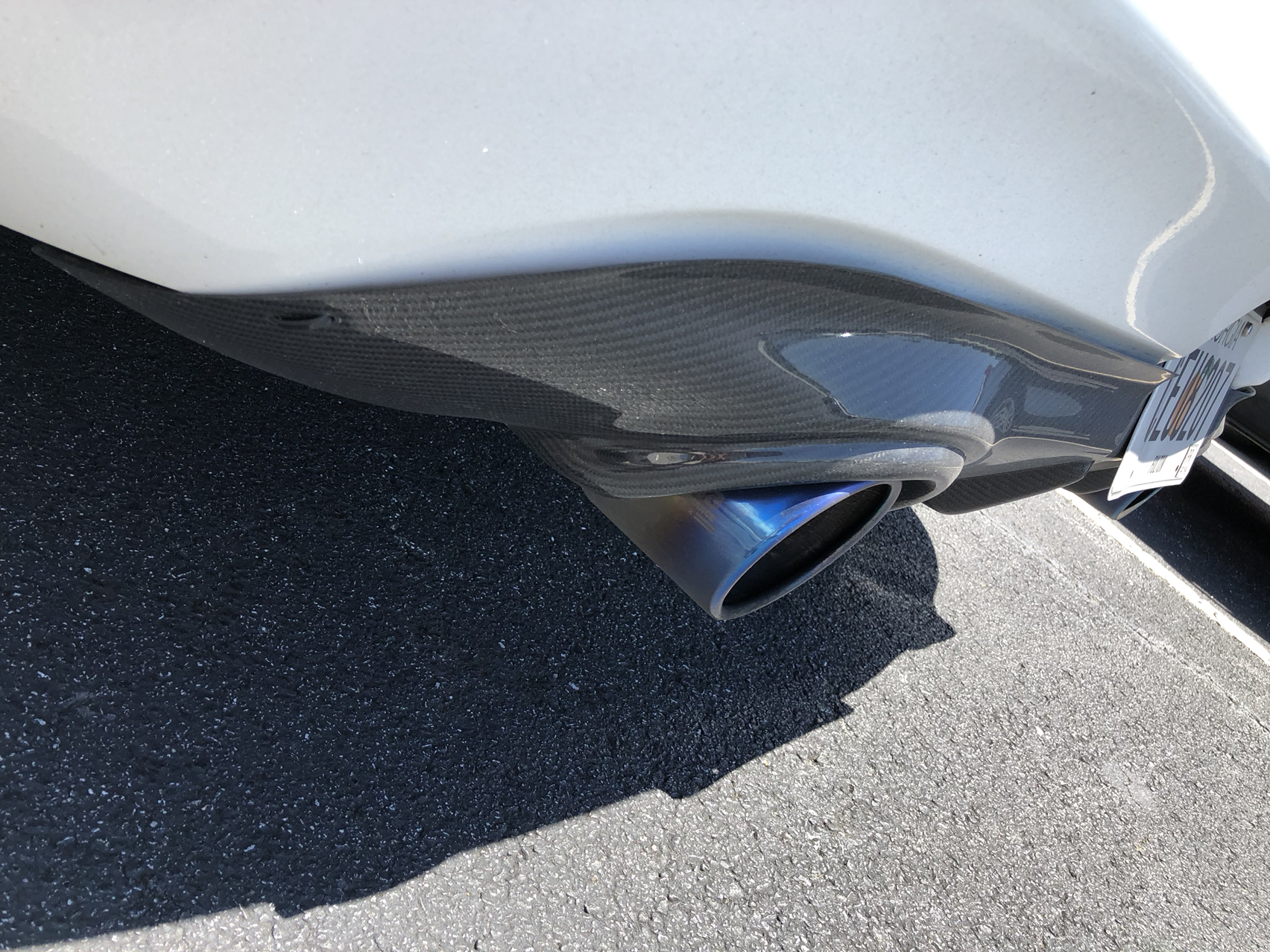

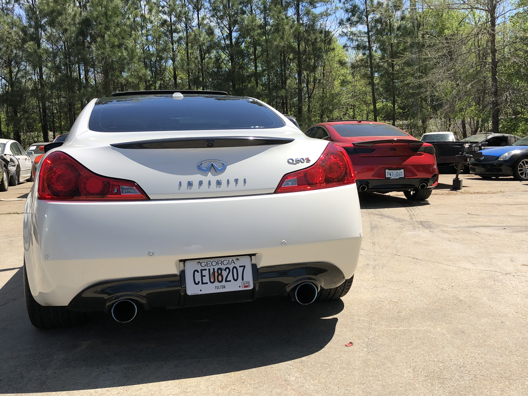

Here is my "ebay" rear diffuser. Fitment was decent but the diffuser curves a little bit sharper than the bumper top to bottom so even with the strongest 3m tape it wouldn't sit completely flush. I ended up drilling and using 2 black zipties in the middle on the far left and right to keep it secure. Looks good to me for much less and without the autokits lead time that seems consistently long. I can take some closer pics at lunch.

I have installed 2 screw behind license plate which can't be seen on the AutokitX rear diffuser for more support on top, 3m tape will separate after time because of heat and water.

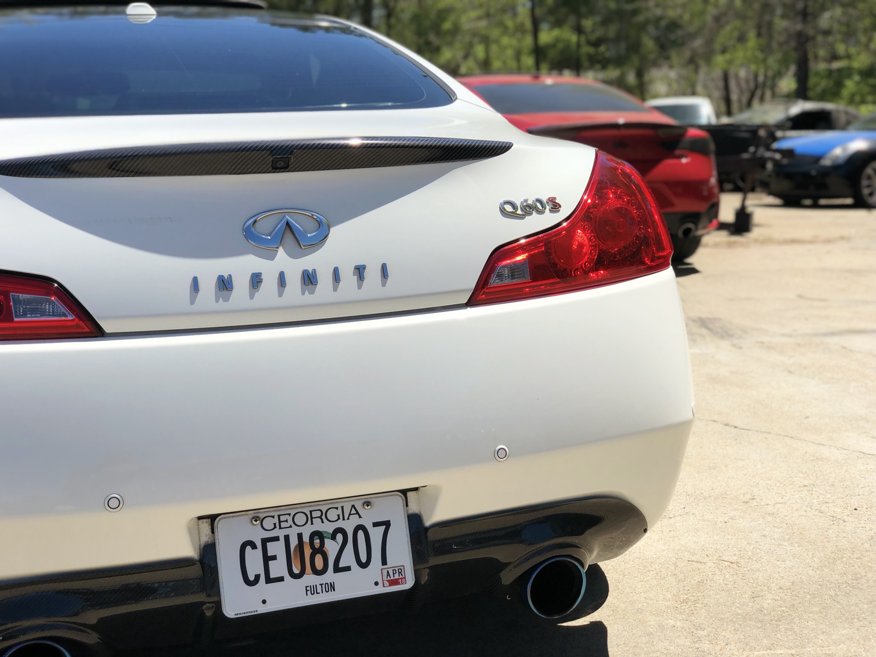

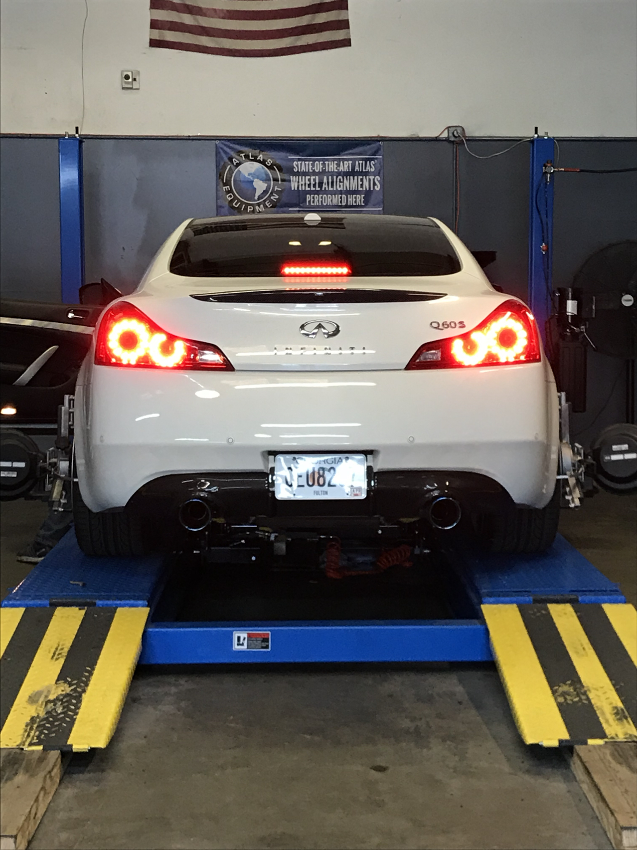

You can see where I added the zipties to keep it from pulling away. Not really noticeable but I've had no issues with it pulling away and the finish has held up well for almost a year.
