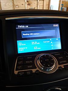

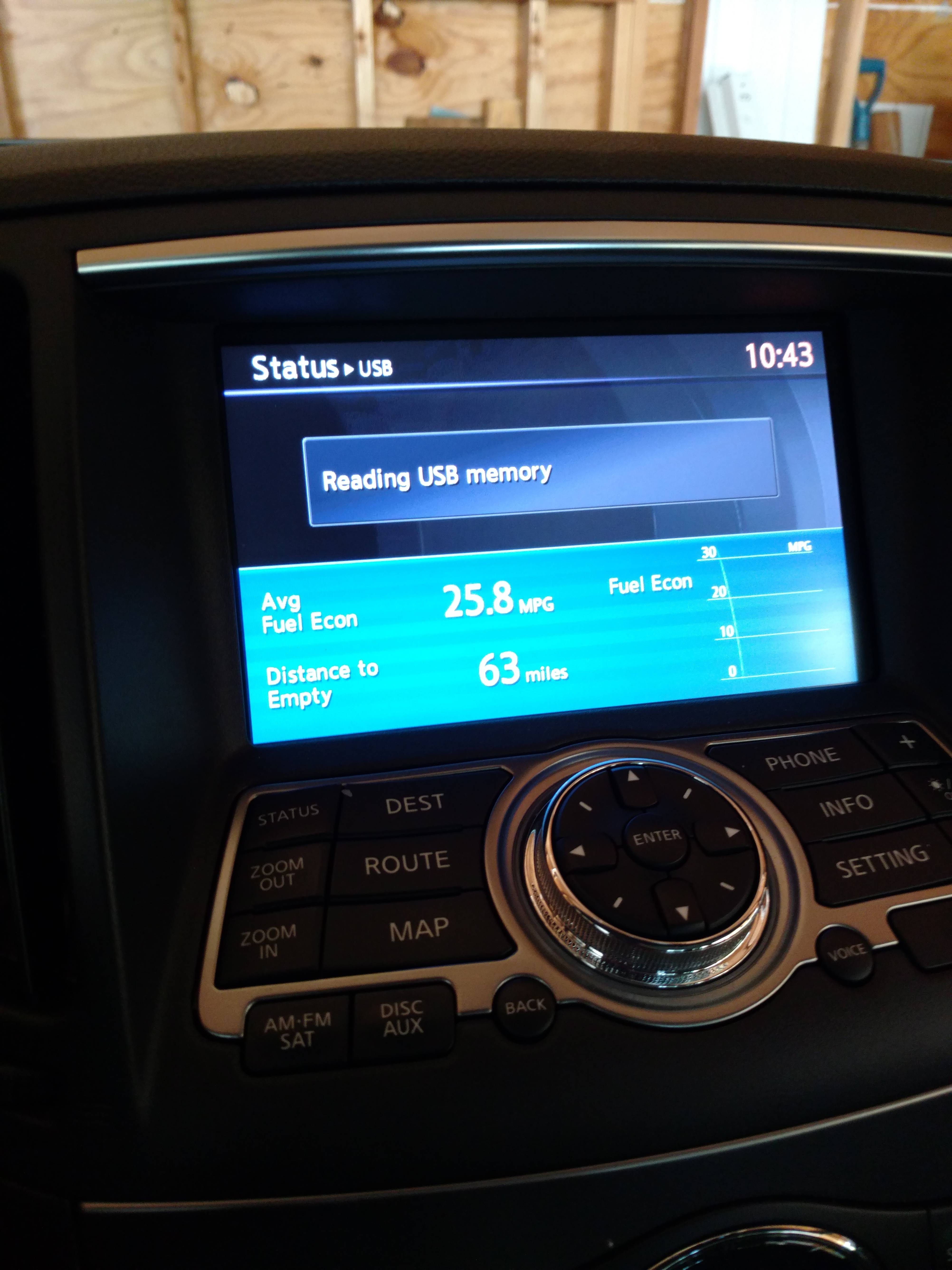

Real world mpg after my 4xx mile cruise last sunday.
Calculating mpg the old fashion way I got 25.9 mpg.
This included plenty of hwy miles but also lots and lots of backroads, corners and elevation changes using gears 3-5.
