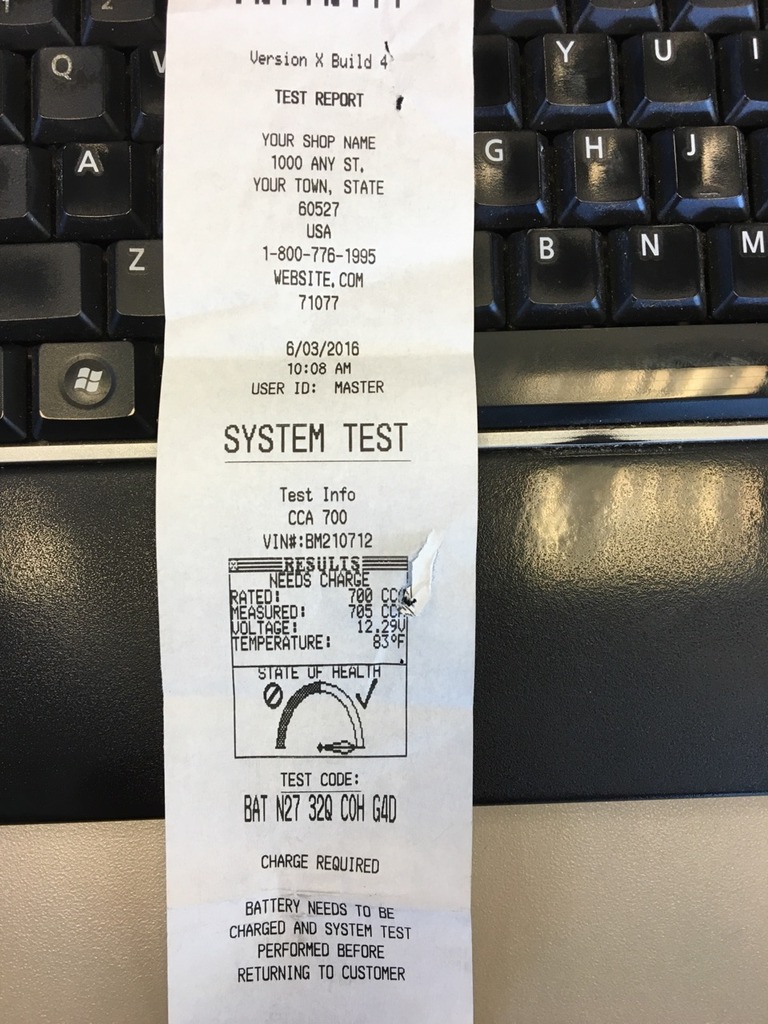

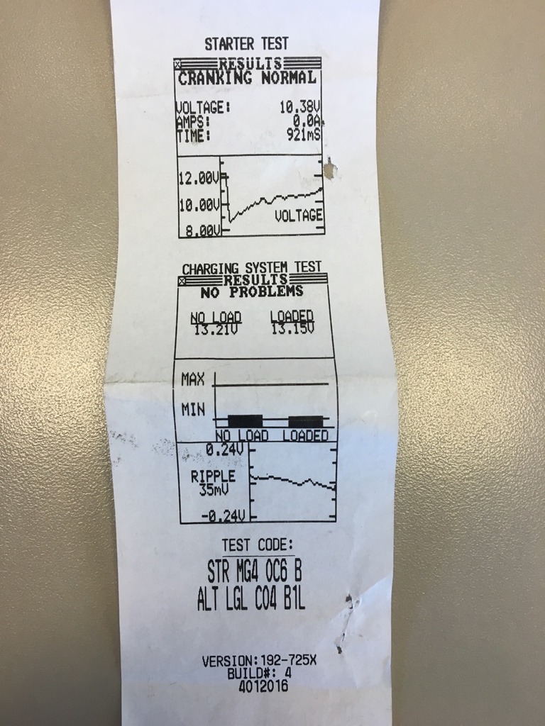

Like the title says, for the past few months my G has had some very irregular volts. I first noticed it when I would come to a stop light. About a second after coming to a complete stop the car would sound like it was trying to stall. I noticed the RPM's dropping as well, maybe to 350. The car has not stalled as of yet. I took her into the dealer after Autozone tested and said the alternator was bad. The dealer performed a test
and said the alternator is good. They replaced the battery. Basically I was told there is nothing wrong with the car.

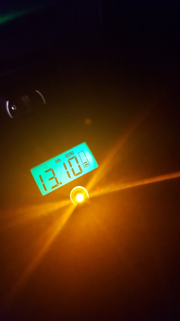

I can coast in neutral for a mile or 50 feet, but when I come to a stop about a second later my RPM's drop and the car almost stalls. I borrowed a buddies volt tester that plugs into a cig/12volt.

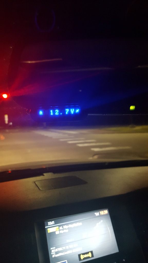

I then thought, what if this voltmeter is off. Here is my radar detector hardwired to the 12volt. (to be fair the meter and radar are measuring the same source, but I can move the voltmeter to the true 12 volt in the arm rest and still have the same volts)

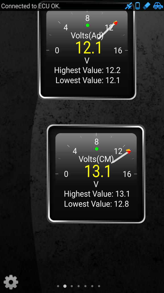

And finally I remember the torque app can measure volts.
I can roll the windows up and the same does struggle a bit. My buddy said it could be fuel, but I have gassed at many different stations and usually use Shell, will sometimes us QT or Racetrac. Always use premium. I have tested the volt meter on my mother's evoque, my buddy's M5 and an Infiniti SUV from the dealer's loan car department, all with a steady voltage.
Synopsis: Car has low and highly fluctuating voltage. Car almost stalls when coming to stop. Help me figure out what it could be. Dealer is aware of the continued issue and is of no help, even though I have extended warranty.
