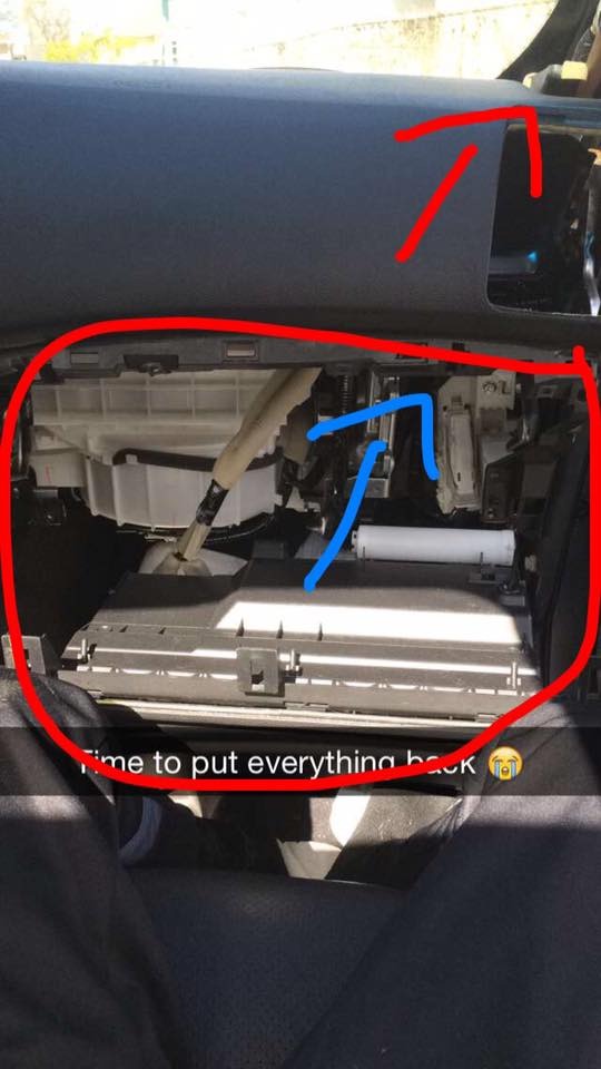

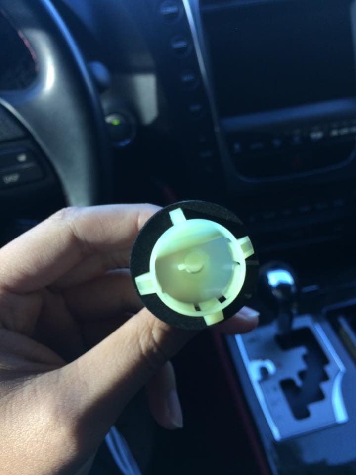

There is a condenser drain in the passenger footwell area.
In my case, it was the sunroof drain grommet on the firewall that needed to be replaced. Dealership billed for $600+, covered under my warranty.
The blue arrow indicates the location of the grommet. This is the grommet itself:
