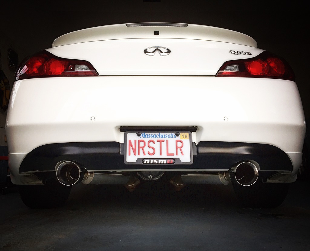

Tanabe axleback is nice, I have it and it sounds really nice and is def. a head turner. They look really nice as well.

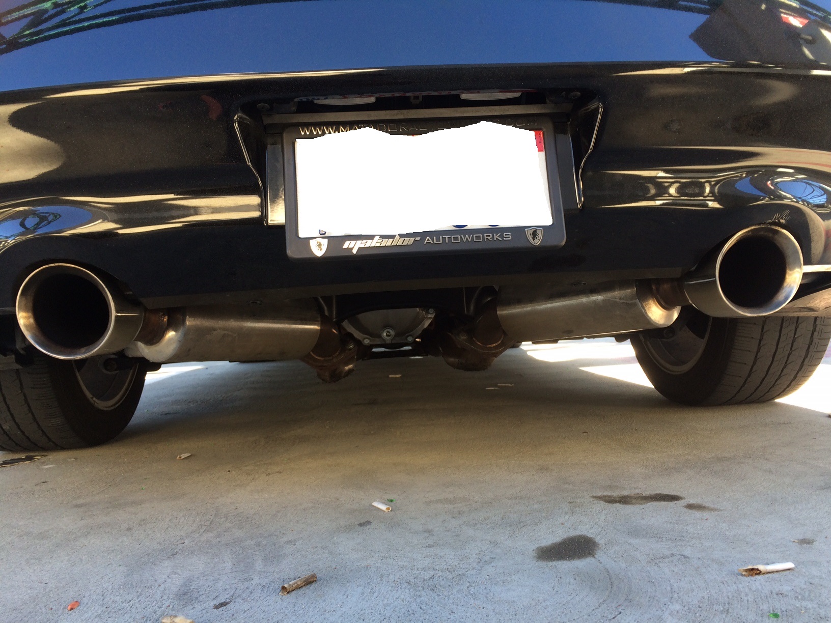

If you have an axle back with no mufflers......what exactly did you buy?
Do you have just the 2" extensions on ? Post some pics please.

Well "loud" is quite subjective, I'm not really sure what the person means when they say "loud", to me that means something other than stock? I think the Tanabe's are loud, louder than what I expected or had on my previous coupe (magnaflow catback). But then again my definition of loud is different.
I have a topspeed pro 1 axle back. And these pictures are before i put on the extensions. The exhaust pipes were too short and were burning the bottom of the bumper and thats why i got extensions welded on. The topspeed pro 1 axle back is for 08-13 g37 coupes and even though the engine is the same, the piping lengths are different as I was told by a representative from Topspeed. At first I was content with the sound but now it only sounds good on certain days for some reason.
