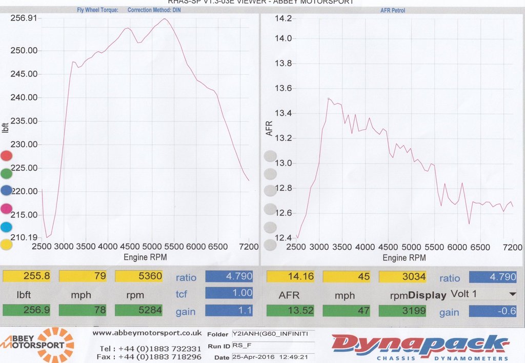

Ecutek tuning and some simple exhaust mods
I spent about $1000 on exhaust mods with AAM and about $600 on Ecutek tuning, ended up with 345.5 horses
Note this plot is showing flywheel hp (hub dyno figures adjusted to display 'at flywheel'
Name:  2014-04-25%20Moderated%20Scan%20of%20bhp%20amp%20torque%20dyno_smaller_zpsytn6rx7m.jpg
Thats pretty good....at the wheels that would be around 395 at the crank.
So a 65 HP increase...do you know your AF ratio that they tuned you to at WOT...?
What were you exhaust mods....headers and HFC?

Already adjusted to flywheel so only 25hp gain
No, the plot has already been adjusted to flywheel hp so it's about 25hp gain, but I'm still very happy with it as the car feels much more responsive (Abbey Motorsport use a hub dyno and the plot has been moderated to display flywheel)
AFR plot here:
Name:  2014-04-25%20Raw%20Scan%20of%20Flywheel%20torque%20amp%20AFR%20data-smaller_zpsf57a7wq2.jpg

Exhaust mods were AAM HFCs and AAM Y Pipe, and a bespoke back box (made by JP Exhausts in Macclesfield - a long way to come for any of you guys but local for me!)
AFR plot here:
Okay that makes more sense ....I thought maybe these G37s must be pig rich to do that or they were running you lean.
