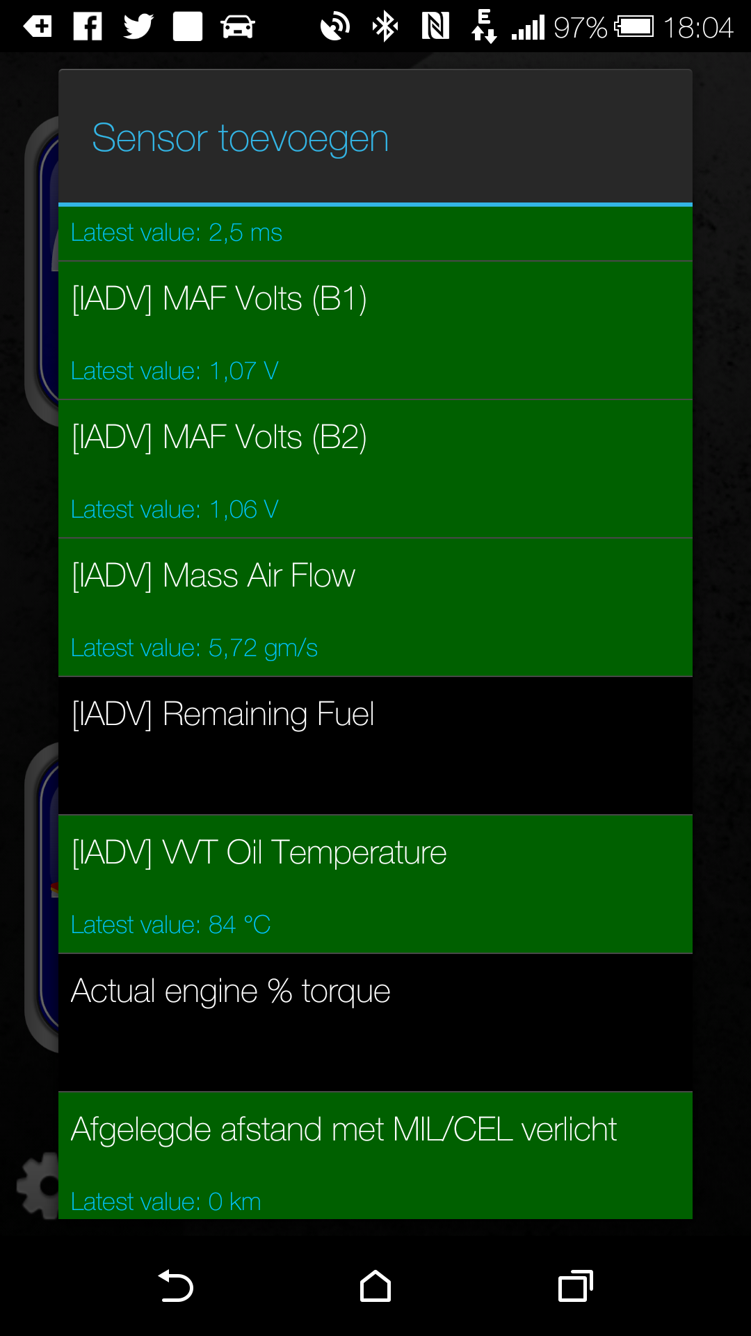

That 's not completely true. Yes Torque only reads the default sensors... by default. When you download the Infiniti extension you are able to read out the Infiniti specific sensors. One of these sensors it the VVT Oil Temperature.
See the Torque page below for the plugins.
http://torque-bhp.com/wiki/Plugins
For me this works on my G37s coupe from 2008 with the bluetooth iCar OBDII tool from Vgate.
http://www.vgate.com.cn/en/iCar%202%...tooth-240.html

Se screenshot, it's the Dutch version but I don't think this is translated.

I re scanned for additional PIDs (engine 0) on the advanced LT version but it gave me an error message " could not release exclusive lock. Please restart torque. " showed an additional 11 PIDs. I'll give torque Admins a call and see what's up. What's your refresh rate?

In my "manage custom OBD PID" list there 25 custom PID's. In the menu the plugin is called "advanced EX for Infiniti", maybe you have a different one?
Refresh rate I don't know, I have to connect to my car. I will come back on this.
