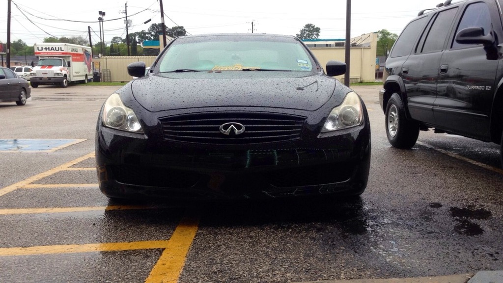

Is the 2008 Non sport coupe just destined to never have a lip made for it or anything ? I've seen threads with merchants trying to get a sale going and nothing happening jw if anyone has had any luck ? If so you'd save a life by replying with a link lol thanks G fam

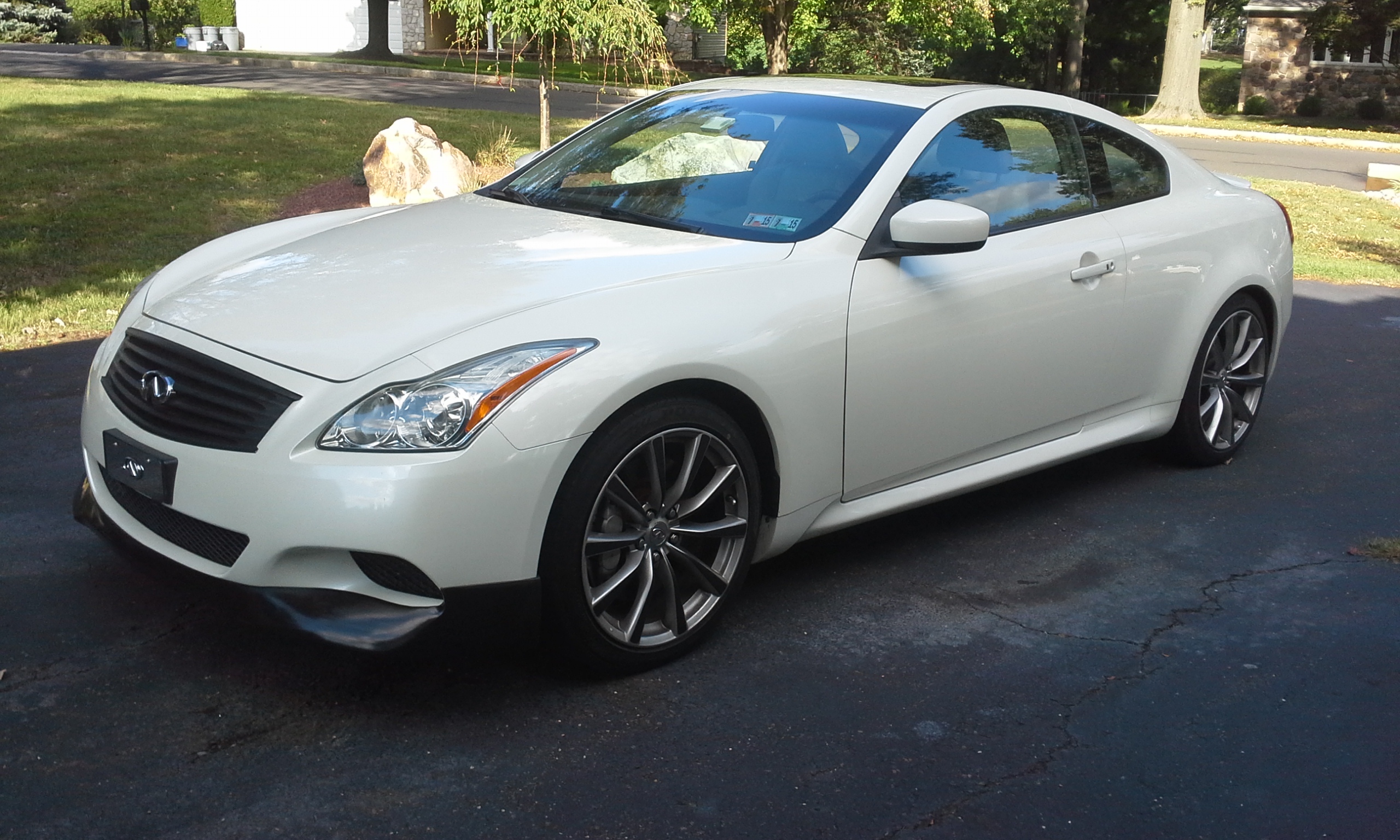

There are Rubberized black Polyurethane lips for $100. Don't paint it...Use 3M tape with 3M prep and it will work nicely Just get the right one. A hrad material is not good because it will break if you bump anything like in a parking lot...The rubbery one is better and easily replaced if you mess it up....I keep it nice with the protectants you buy at the auto store.
Put screws at the wheel wells.
Apply the tape to the lip first NOT THE CAR..., leave a little red tail peeled to pull the plastic off.
Fasten the sides to the wheel wells ..First...then get it in position at one end after you peel about two inches and then , peel the red tape tails while you press into position.If you have a buddy to help, it's easier yet. Make sure you use the 3m prep 94 Primer in little tubes from Amazon. Super stick that way.
Good Luck
