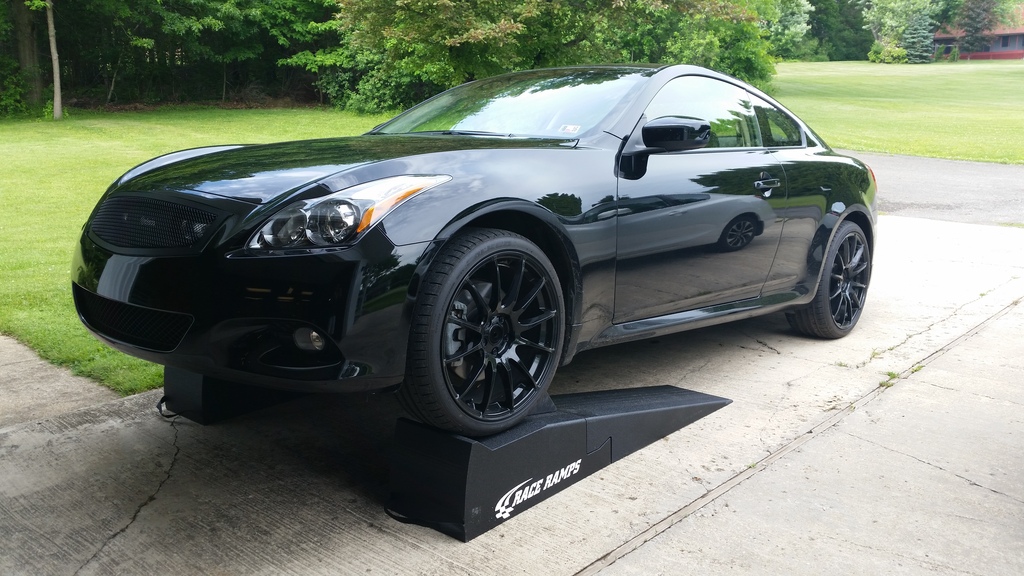

Old Jul 14, 2015 | 08:12 AM
i heart ricers's Avatar
i heart ricers
Banned
Joined: Feb 2015
Posts: 658
Likes: 42
Old Jul 14, 2015 | 09:52 AM
InfinitiFreak's Avatar
InfinitiFreak
Joined: Aug 2005
Posts: 1,148
Likes: 36
From: Houston, TX
Originally Posted by i heart ricers
That is what I use when I change the oil on my G37S. Works great and plenty of room.
Old Jul 14, 2015 | 10:53 AM
Glenn2008's Avatar
Glenn2008
Joined: Jan 2013
Posts: 585
Likes: 39
I have the 10" (4 piece) Race Ramps also, they work great. I also purchased the 12" wheel cribs an alternative to jack stands. If you do buy the wheel cribs, you'll also need the 24" low lift jack from Harbor Freight to get the wheels off the ground high enough to place the cribs underneath. I had Rhino ramps for years, but they raise the wheels 6", the additional 4" under the car makes a huge difference. I've also replaced the plastic under car panel with the Z speed aluminum panel. It has two screws to remove a door to change out the oil/filter. One other mod I made was install a Fumoto valve to drain the oil. Makes life easier/cleaner.
