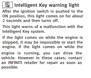

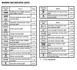

For you folks who don't have acrobat reader
page 2-15 of the '12 owner's manual
Probably a good idea to at least have the pdf on your phone if you don't carry the book in the car.
To the OP, from what I'm reading, this issue could potentially leave you stranded.
