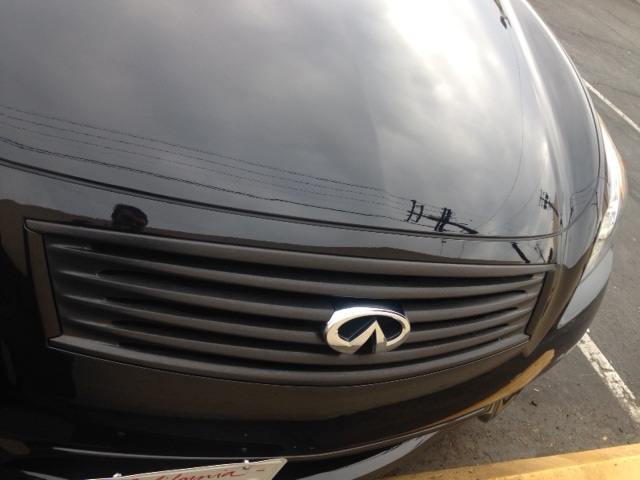

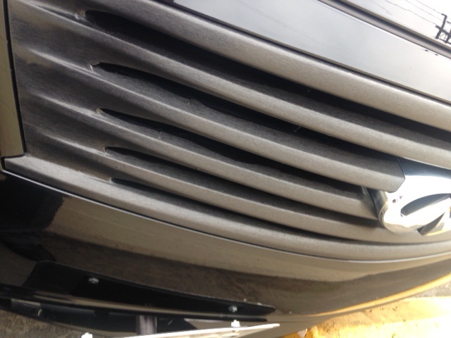

Good Morning, i've finally built up the cajones to DIY vinyl wrapping my grill and it came out horrible. I waited 3 weeks for the wrap, my gloss black ripped on me when i was stretching through the slats, and i was left with no choice but the brushed color i had gotten for the interior, overall its horrible in my thinking wish i took it to a professional, i've been lurking the DIY thread involving blnewt and the vinyl pros but i certanly am no pro! if anyone knows any shops around LA that can do a professional job please let me know!

What material did you use? 3M?
Using a quality vinyl is paramount in achieving good results. The fact that you said you waited 3 weeks to get vinyl makes me get the feeling you bought no name vinyl from China (or a very bad seller). Cheap vinyl is very difficult to work with and can tear when stretching. If this is the case, I recommend purchasing 3M Scotchprint 1080 and giving it another shot.

Oh wow, then I'm not sure. 3 weeks seems like a long time to receive a product, perhaps there were extenuating circumstances.
I have had good experiences using 3M vinyl to conform to shapes using a good amount of heat and patience. The grille is an intricate shape though, so maybe it's worth having a pro wrap it for you.

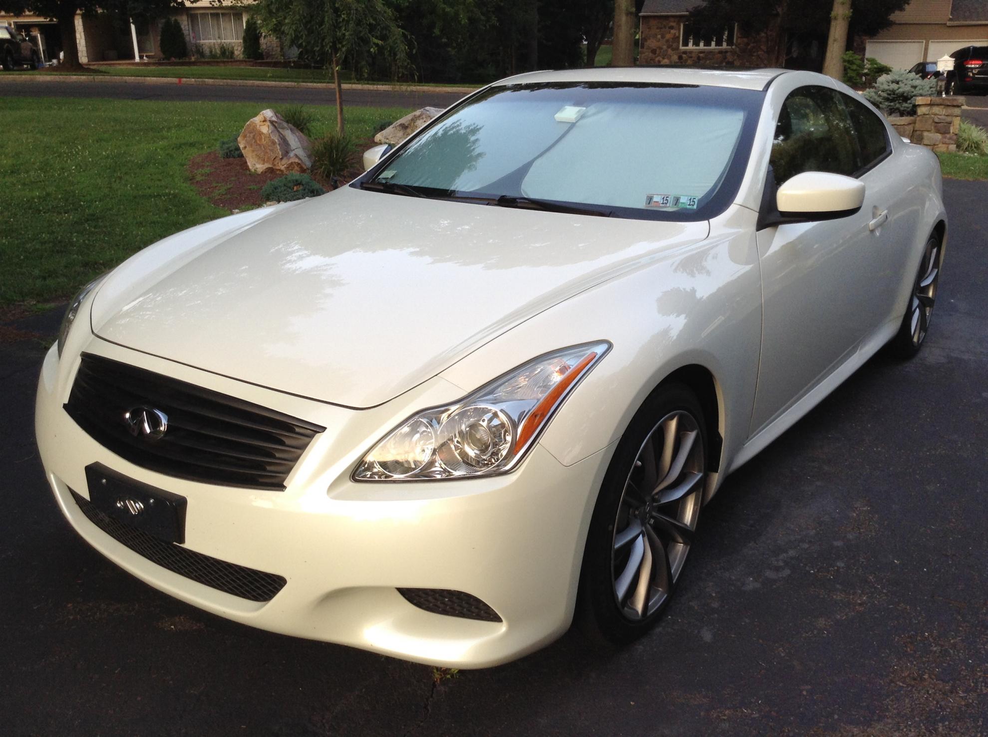

The thinner the vinyl the better...but why go to all that trouble when you can Plasti-Dip the grill with Spray and be done with it. I did it in April or May and it's just great. I hear you can peel it off and , if it chips, respray the section. So far no chips. I put 5 coats on and it's super. Took an hour. $6.00
Simply mask off with tape and a little newspaper....do the coats with 10 minutes in between . Not too close , just like a dusting coat each time....Long strokes...like painting a model car.... and any overspray on the body will rub off with your finger.
So simple..Tape off the emblem too. It works great.
I bought 4 cans and only used almost 1. Guys here have done their wheels too. That's in Philly where it snows.

Plastidip really only works if you are interested in a matte finish. I have seen multiple people post very unsatisfied results when using the glossifier. The vinyl will always withstand chips much better (assuming its a quality brand) and you will not have to refresh the grille every oil change from rock chips. One final differentiator for vinyl is that you can get it with textures and/or patterns to look like brushed metal, carbon fiber, etc. and it looks VERY realistic.
It really comes down to personal choice and what look you are going for, but these are a few of the common reasons people choose vinyl over Plastidip regardless of price and installation effort.
