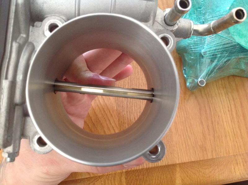

Not for me? So you're saying the CNC TB's I sell and personally have installed on several vehicles around town plus the buyers I've sold to are just the luckiest people in the world! Damn I should play the lottery!! You're buddy had other problems, period.
O look, another perfectly running set on my buddy's g37 where I opened the bigger brand new butterfly plate.

Every ported set I've sold and installed including mine stabilized in seconds. I have a 13 370z and it took milliseconds. Two 08 g37's took like 1-2. These cars are extremely smart and fast learning with their on the fly adjusting or whatever nissan calls it. I'm sure mine was just faster because the processor or changes nissan made over time was just better in 5 years. I have zero worry of touching the butterfly because unlike most posts I see everyone just spits info back out they read somewhere. I don't do that! I have 100% hands on knowledge.
