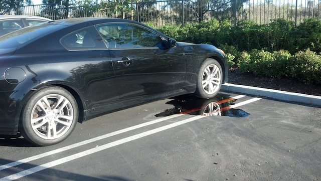

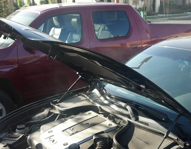

I took my vehicle to the the local Walmart for a routine oil change and tire rotation a few months ago.
Eighteen days later, I was driving to a friend’s house from my office. As I approached my destination and slowed down, I noticed white smoke rising from the hood of G coupe. Within a matter of seconds, the smoke increased dramatically to the point of it billowing and being vented through my car's ventilation system into the vehicle cabin. The smoke smelled very strongly of burnt oil and I immediately parked the car, shut off the engine, and got out of the vehicle, coughing and choking from the copious amount of smoke.
Once outside the car, I noticed that oil was dripping from beneath my car and forming a pool on the pavement. I would estimate that this dripping continued for roughly 10-20 minutes before it eventually slowed and stopped (see pics).
I had the vehicle towed back to Walmart the following morning. Prior to towing the car, the tow truck driver inspected the undercarriage and indicated that the drain plug was missing from the engine. The employee at the store who inspected the vehicle also acknowledged that the drain plug was no longer installed but rather rolling around loosely in the underbody shield/cover.
I filed an incident report at the store and spoke to a supervisor who seemed guarded but apologetic. They filled the engine back up and fired the car up. Seemed to drive fine. Refunded the service costs and offered a free subsequent oil change (yeah right!) I had to get to work, so I took off, knowing I will follow up on the issue later.

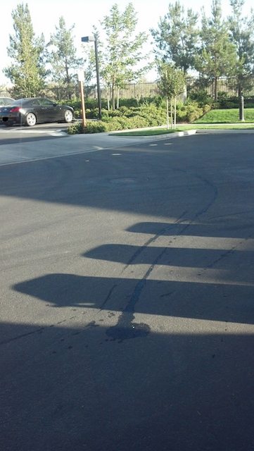

After the incident, I saw that my car had left a noticeable trail of oil on the pavement along the path I had driven. I traced and followed the oil trail for roughly 3 miles, until it was no longer possible because the trail entered a freeway. It is therefore obvious that I was driving with a missing or loose drain bolt for at least 3 miles, but possibly much more. Motor oil was leaking out from the running engine this entire time (i.e., on the highway).
Anyway, I complained to Walmart, who forwarded my claim over to their claims handler, a company in AR. They indicated that unless any tests show that there is definitive damage or excessive premature wear to the engine, they will not be paying for any damages. Speaking to som third party shops, it seems compression and leak engine tests aren't really designed to capture the type of damage that might result from oil starvation.

You should've asked them to drain your oil and measure how much came out to get an idea of how low you were running for a piece of mind. The Walmart guy will tell you it only lost an insignificant amount and won't be a problem but you're practically driving a ticking bomb now. Not trying to scare you, but the VVEL needs the oil just as much as your bearings in the VQ37. Best of luck.

about going to Walmart.Actually, I did ask that. It was pretty much bone dry according to the tech. But some of it did drain out after the car was stopped already. I guess the best guess would be to estimate how much oil was in that puddle, which would be the amount that was left in the engine before it was shut off.

I think an option to consider is to pay Infiniti to inspect the engine first then take the findings to Walmart. I really don't think driving with such low oil level will NOT harm the engine. My uneducated guess is 5-7hours? of labor. If the internals are damaged, you'll probably get a new engine on their dime rather than on you. It's something to consider if I were you.
The good news is that your car is fine. You'd have to run it with no oil at all for some time to do any real damage. The puddle there shows that there was still quite a bit of oil in your engine even after you stopped.
The best you can likely hope for is that they document it well and you'll have something in writing in the event you have any issue later. I really don't think you will.

OP, hopefully you were just mildly cruising your G during this episode, that would be another thing in your favor and like BB mentioned, there was a fair amount of oil puddling under your G so it wasn't bone dry. If your motor wasn't running hard & hot then your much more likely to be in the clear.
