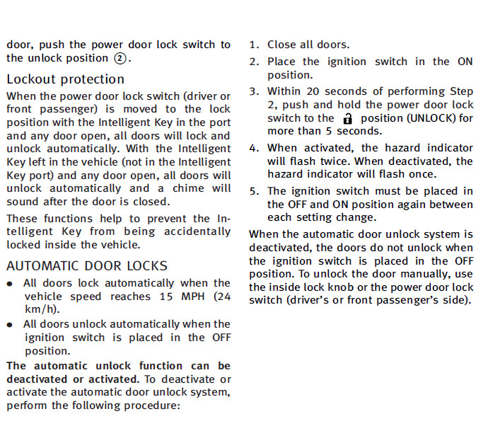

How do you deactivate the auto door unlock feature when you turn the car off?

Here you go..to enable/disable

That's interesting. Do you know how to get the doors to lock automatically? I have a 08 g35x sedan.
I imagine you would just follow the instructions that DPNx714 was so kind to place above...
The procedure outlined activates and deactivates this feature.
