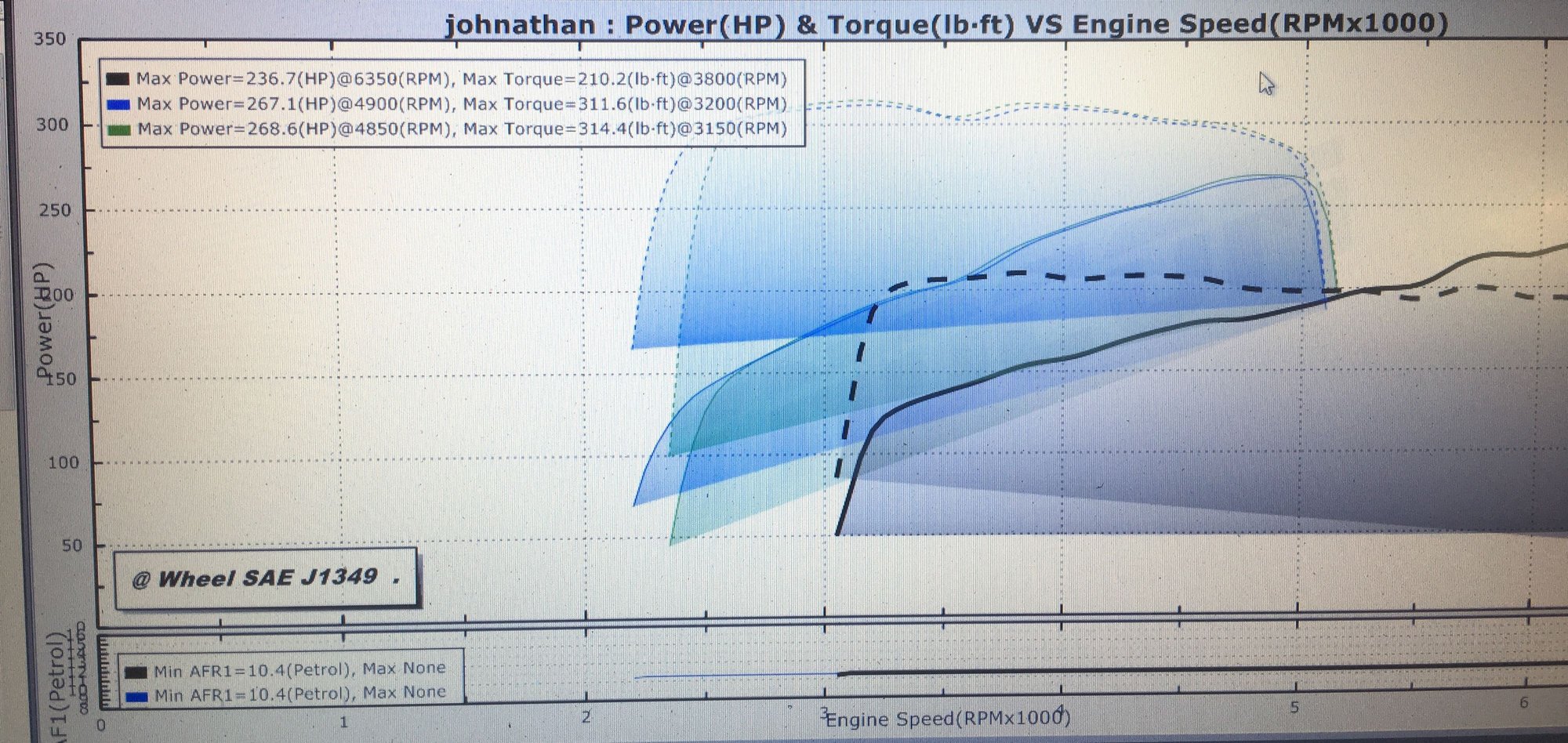

I have just a tomei muffler not even the Y-pipe yet and my car made 268hp/314tq
The first pull was on 5th gear and made 236/210 the next two were from 4th gear and I have a 7AT btw but I was amazed when I saw those tq numbers because I've never seen a g37 make that much torque even fbo ( Also have a stillen grounding kit )

That isn't a g37 dyno. That looks like an sti or Mazdaspeed dyno result...something boosted. Wtq readings are not correct

The torque numbers are incorrect. You didn't actually make 314 torque. It's also a mustang dyno which is why the HP numbers are also low.

This is my 2011 g37 7/AT I have video proof but I can't find a way to post a video on here and right after me a nismo 370 went and put down 277hp and 290tq

I know it was a mustang dyno that's why I didn't care for the hp numbers but I'll eventually dyno on a dyno jet and post new numbers
