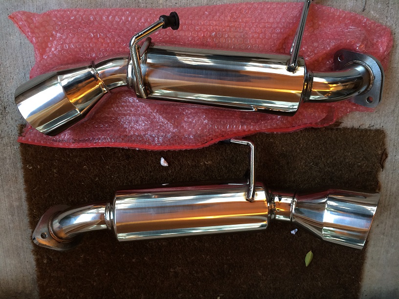

As the title says, I have a top speed axle back coming in this Monday. Stay tuned for experience from start to finish (ordering to install).
UPDATE: 2/27/2014
-Order the axle back on 2/20 for 269.99$ shipped. called directly and spoke with George, who personally handled my order, and made sure i got the one with the beveled tips. emailed me the tracking info within 2 hours of payment.
-received the package on 2/24 mid afternoon via UPS. comes nicely packed.
-pics of quality: good welds, solid feel, not that heavy, definitely a bonus for weight reduction over OEM exhaust.
-Installed 2/28. note that i started soaking the bolts w/ PB blaster on 2/25, once on2/26, and last on 2/27; 3 days prior to install. on 2/27 after a few mins i took a steel wired brush and brushed the threading of the bolts and around the nuts to get whatever rust/debris off. this helped alot bc my friend, whos a mechanic was able to initially turn 3 of the nuts with a ratchet wrench and some leverage. the 4th was being a PITA, so he took a torch and heated it up and it came off with little resistance after. an impact gun is your best friend during this install!!!!!!!!!!!!!
-we fitted the driverside first. after we attached it to the hangers and bolted it on properly by doing the left and right bolts a little at a time, we noticed the tip was touching the bumper. we corrected the "touching" by gently pulling down on the hanger arm thats attached to the car. (indicated by arrow)
-next was the passenger side, it went on and fit perfectly, with no "touching" issue.
-lastly we checked for leaks. none.
-drove for about 45mins to an hour, to break it in. it was that long only bc i got put into a trance by how deep and burrbly the exhaust note became. its definitely louder and yes there is drone; ONLY if your in a higher gear at low speed. but its nothing to be concerned about bc the exhaust is simply amazing. BEST bang for your buck.
-got home and inspected the fitment. the driver side still doesnt sit like the passenger, but it doesnt bother me. ill get to it next time im at the shop.

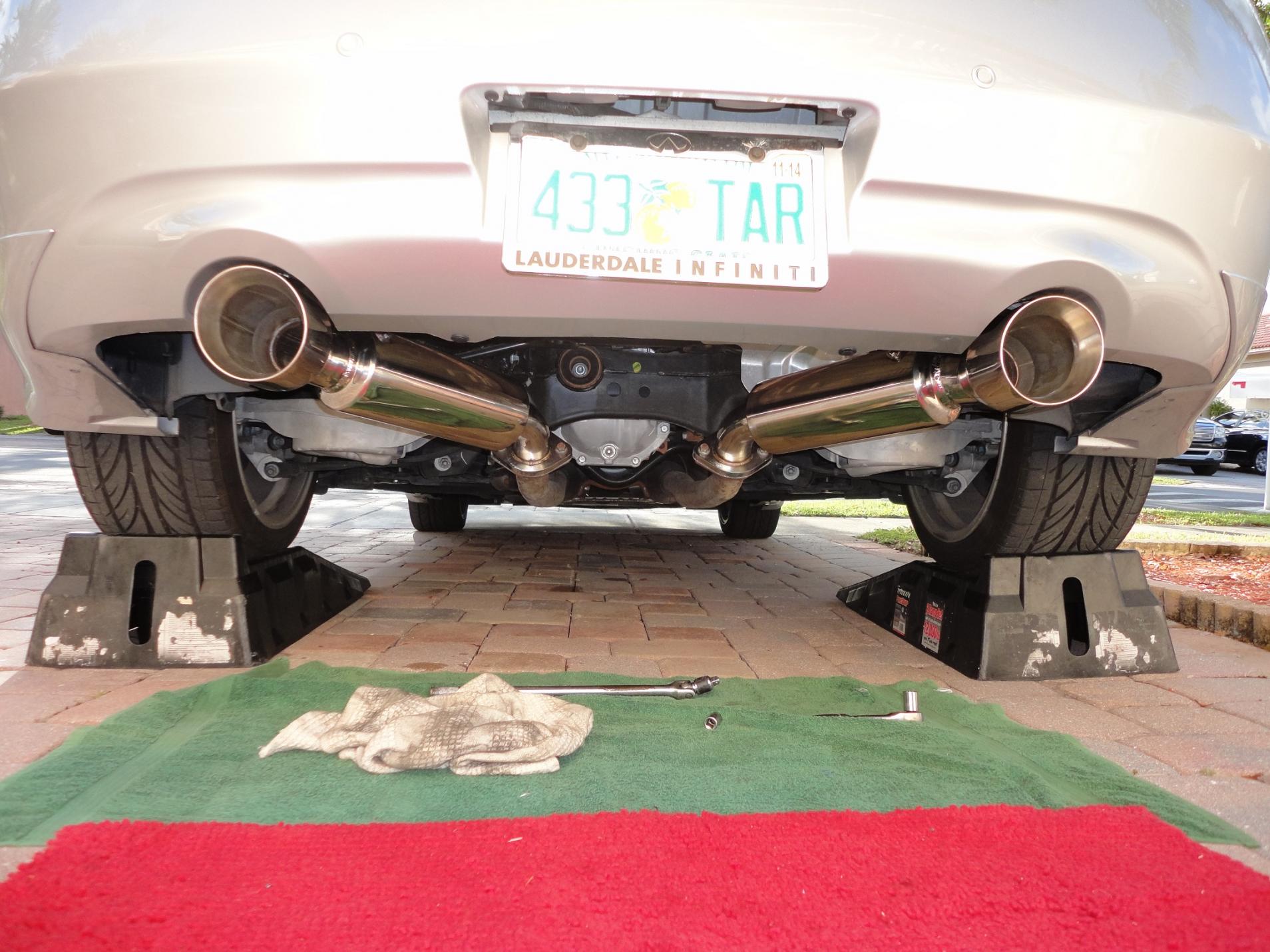

Dude I got the same exact exhaust off Ebay for $190 shipped. Mine looks just as good. They are straight through mufflers (if you can call them mufflers) so they do produce quite a bit more sound.
Attached Thumbnails Top speed pro1 axle back ETA 2/24/14-img_2765.jpg   Top speed pro1 axle back ETA 2/24/14-dsc00411.jpg
