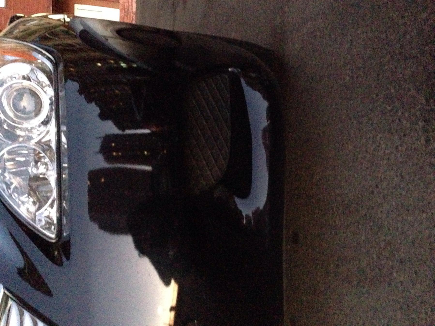

I understand that this things are different,right?
Fog lights are so expensive bud

And will it looks good with ipl front bunper and non rear ,skirts?thx
