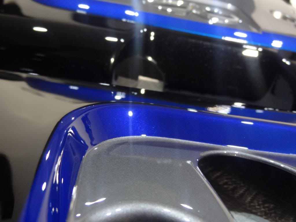

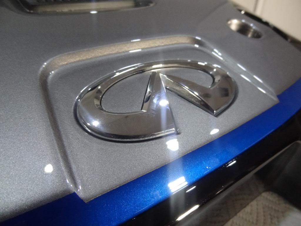

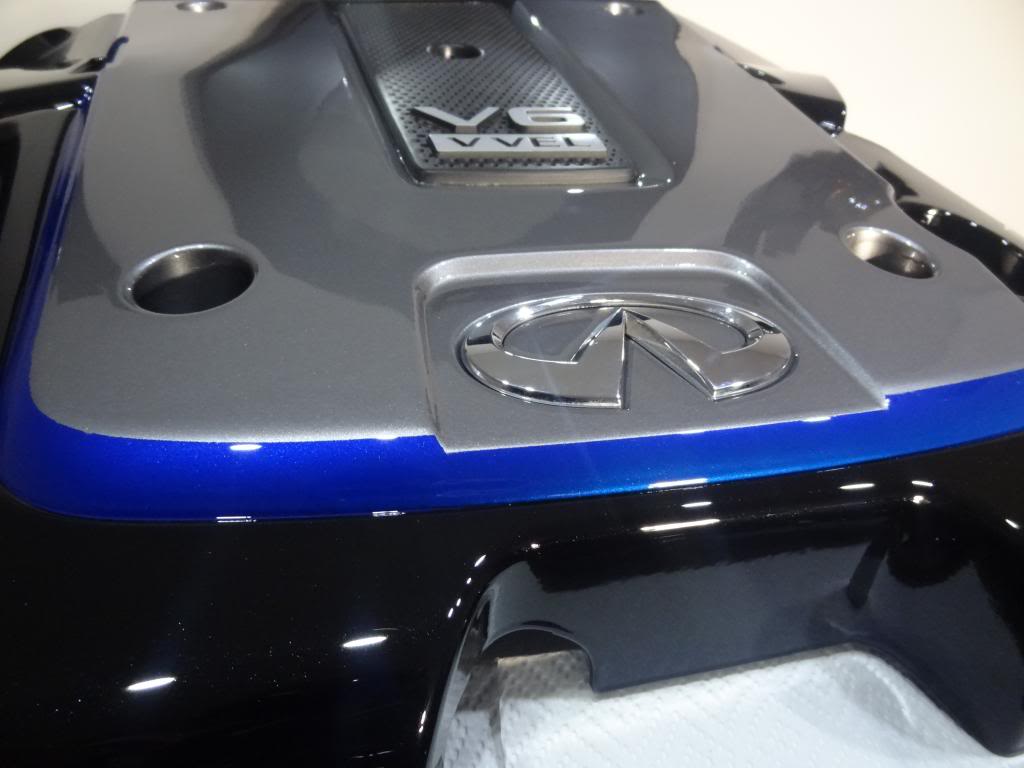

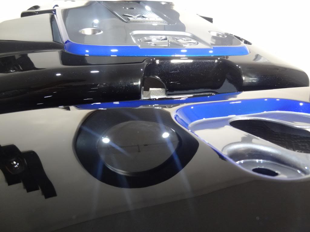

Platinum graphite, pearl blue, and a black pearl

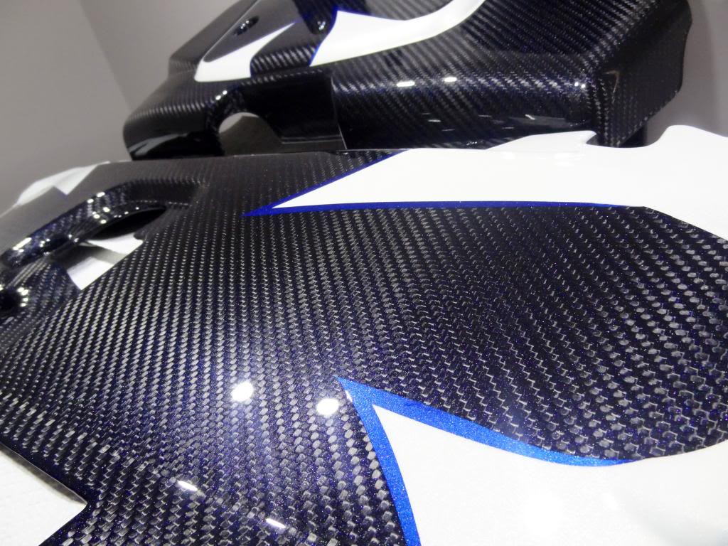

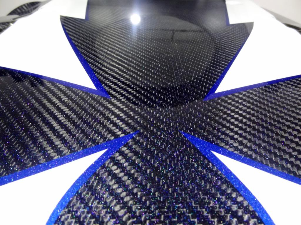

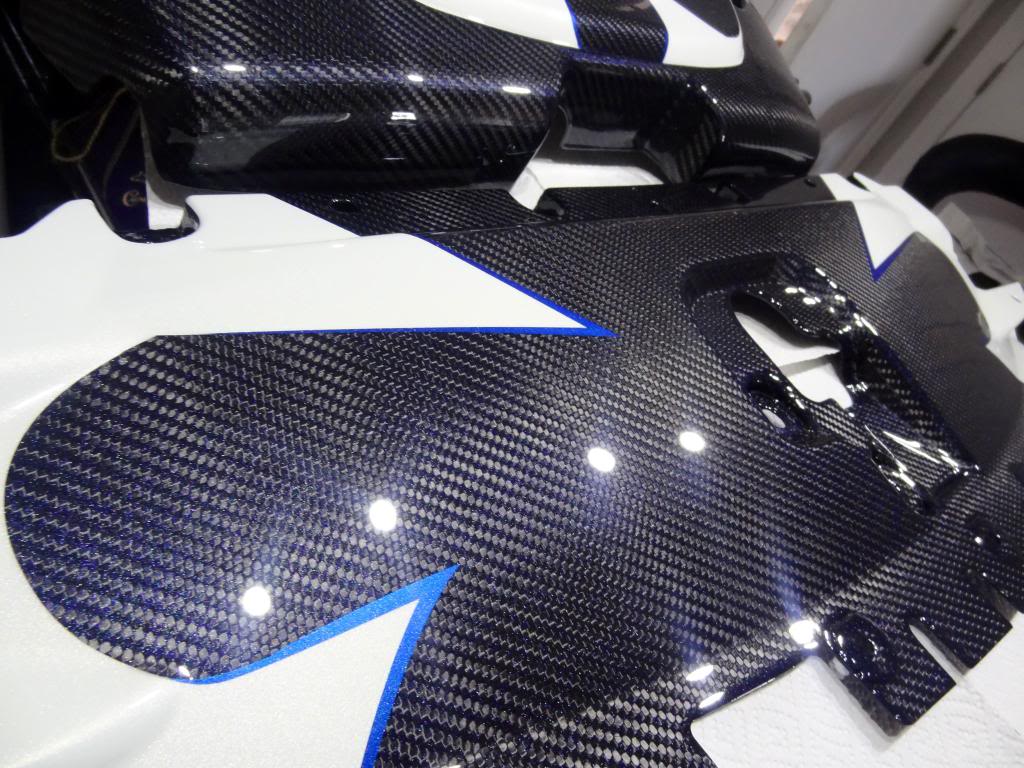

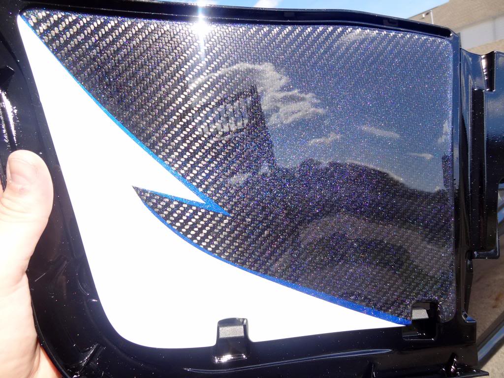

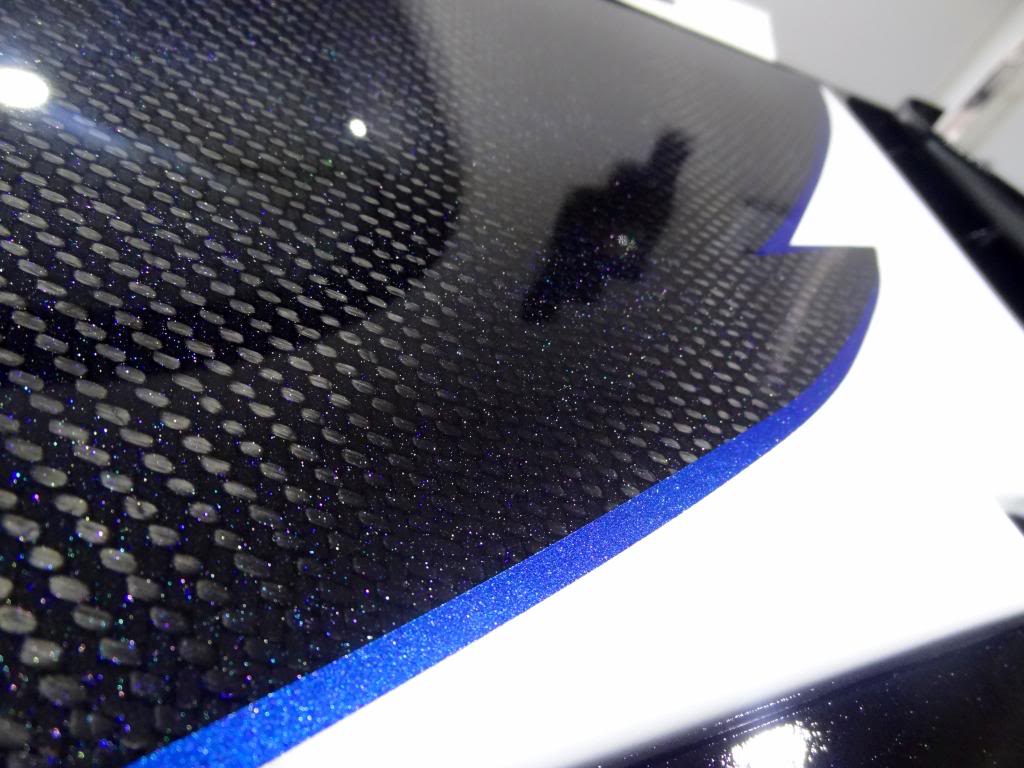

Status elite cf parts, moonlight white pearl,cusco blue pearl, and white and blue pearls overtop of all in clear.

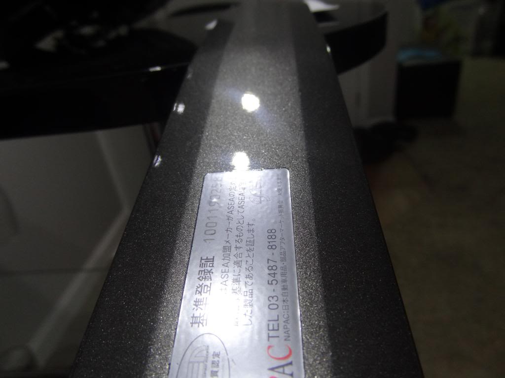

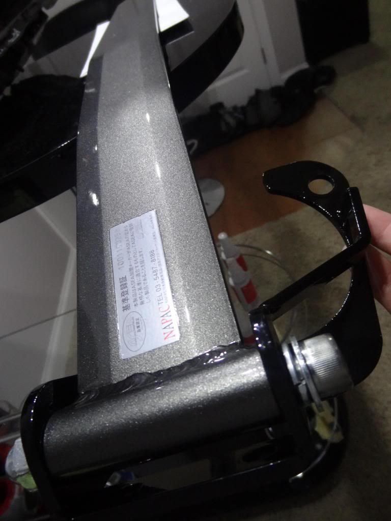

Gunmetal cusco strut bar with black pearl mounts

Wow, Got much spare time on your hands? Engine cover looks good though.

love the cusco strut bar. I want that in reverse with black tubes on the intake tubes and gunmetal filter covers on my stillen. Great work.

How did you paint up the engine cover? Looks real nice, I could go for that.
Old Nov 26, 2013 | 07:34 PM
JPSBLACKG37's Avatar
JPSBLACKG37
Posts: 555
Likes: 85
From: Columbus Ohio
I don't use cheap materials lol all is done in a spray booth, and every part is painted twice to kill the ugly plastic texture

I don't have a spray booth but I do have a nice compressor and spray gun. What brand of paint did you use and what type of prep went into it before you painted?
Old Nov 26, 2013 | 07:51 PM
JPSBLACKG37
Posts: 555
Likes: 85
From: Columbus Ohio
I use spies hecker basecoat and Dupont Chromaclear. the engine cover gets thoroughly cleaned then sanded, then adhesion promoter applied, then sealer basecoat and clear, I normally do the darker color first, and give it like 5 coats of clear. once its fully cured ill sand it smooth then tape off and do any second and third colors then reclear
