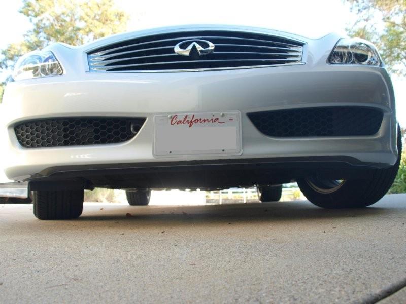

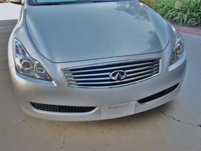

G37 liquid platinum CA front license plate bolted on
Did the dirty deed on 5AT liquid platinum color...used some scotch tape to hold in place tight back to curve of bumper, (top of license at line perceived between top of lower vent areas, yet 3/8" above bottom of bumper chin), penciled thru license plate top two holes, used sharp nail to dig center of penciled circles for starter indentation, 7/64 drill, 7/32 drill, 1/4" large head bolts x 1/2" long screwed thru, dropped plastic cover under radiator area, about 10 bolts holding that up, put washer and nut behind bumper, tightened up firm to bend plate to curve of lower chin / nose area. Dealer wanted to mount above the vent area, tilted up on nose with provided black plastic bracket behind...also that bracket is too long for plate. My mounting is secure, but could add two lower bolts if needed, if rattling occurs. Considered buying some new exterior grade double stick for center of plate at two points, top and bottom, but that seemed inadequate. There are some very strong double stick adhesives out there which would probably hold the curve of the bumper as well as the bolts I used, but the bolts leave little gap behind the plate. Infiniti should have put a flat plate indent in this area of the plastic below the nose tip. Or automobile manufacturers should petition for removal of the front license law...maybe i should have one on the front of my motorcycle? I think the intersection red light violators could still be caught from behind with a rear license shot at those locations. Such a waste having CHP chase speeders, when cameras would be enough. License plates could be replaced with radio frequency ID tags or invisible bar codes? I see stones have already taken a couple of paint ticks out of the bumper...what is the touch up paint routine to use? My chin has dipped too low a couple of times, but the black ABS under the "platinum" does not look that bad once the shredded plastic is removed. I will search the forums to see answers have already been posted.
Attached Thumbnails Front license plate questions-ha059192-copy-g37-paint-out-license-oly-mas-low-100pix-email-size.jpg   Front license plate questions-ha059193-paint-out-license-lower-view-email.jpg
