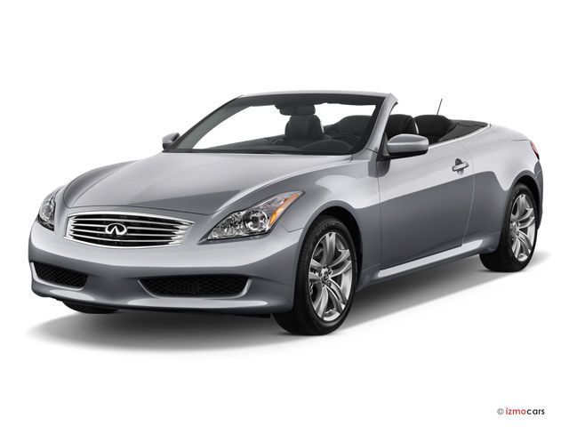

Hey everyone, I have a 2010 convertible that looks exactly like the one in the picture. I'm not a big fan of the front bumper and want to do something to "spruce it up". I'm considering swapping bumper covers, but I'm not sure which other trim line G bumpers will fit without swapping out a whole lot of other stuff.
I'm also open to a decent looking front lip, but I'm not sure which ones will work with this bumper.
If anyone has any helpful info that would be great!

No matter what bumper you go with, you will also need all the extra grilles that go into it.
The best looking OEM bumper is the IPL bumper https://www.automotiveaddicts.com/wp...vertible-2.jpg . There are a bunch of aftermarket options too like top secret https://bulletproofautomotive.com/pr...e-front-bumper or the Q50 style bumper from outcast garage https://www.outcastgarage.com/collec...60-coupe-08-15 or a similar VIS racing one https://www.outcastgarage.com/produc...60-coupe-09-15
Lots of other OEM variants too, but you will need all the bezels and grilles in addition to the bumper cover. That being said, ANY G37 coupe bumper should fit, but most will require additional bits and pieces. If you are a DIY cheapo like me, you can make your own, but otherwise, those things add up quick. If you can get one from a junkyard that already has everything attached, thats the best bet.
