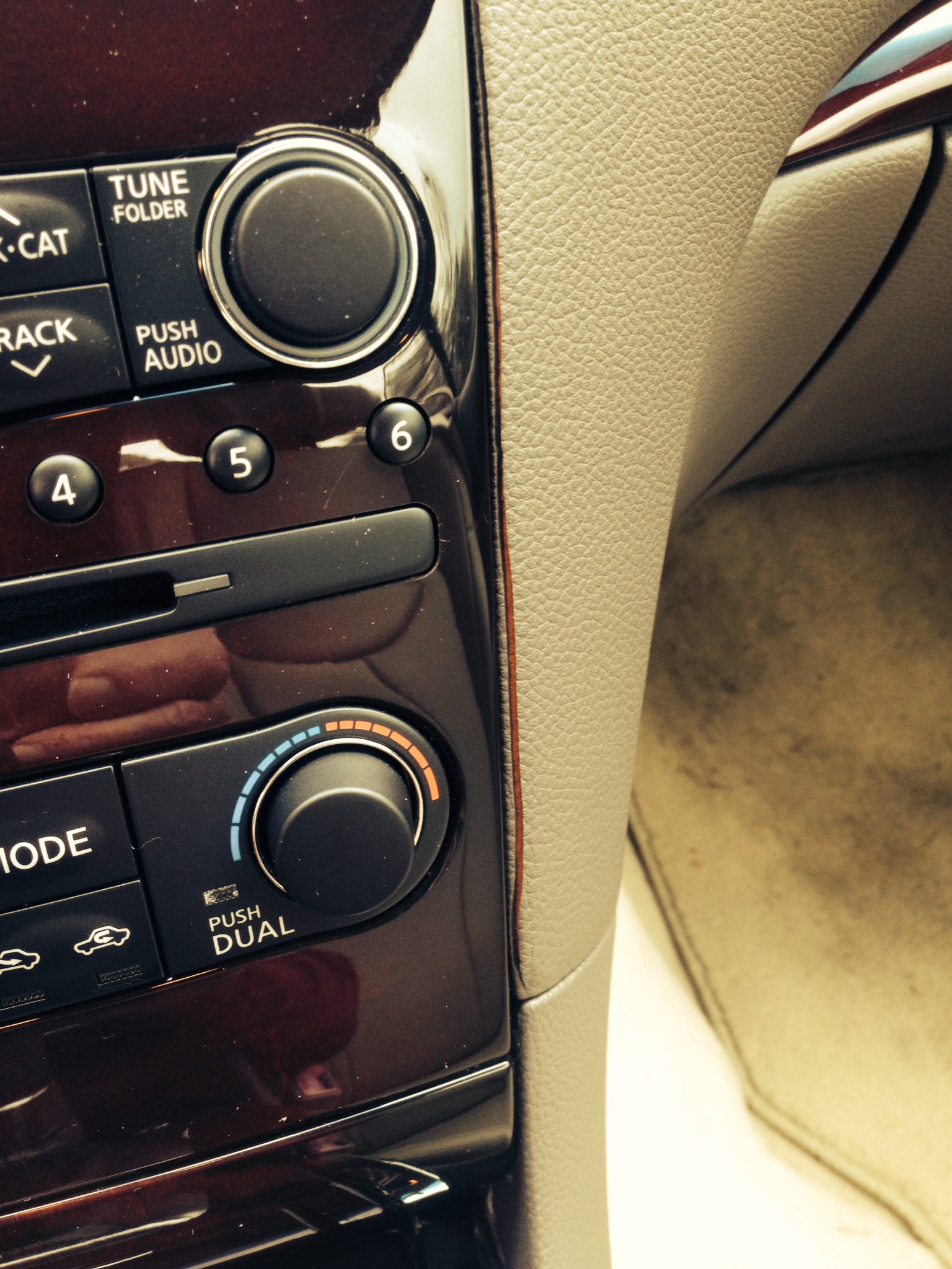

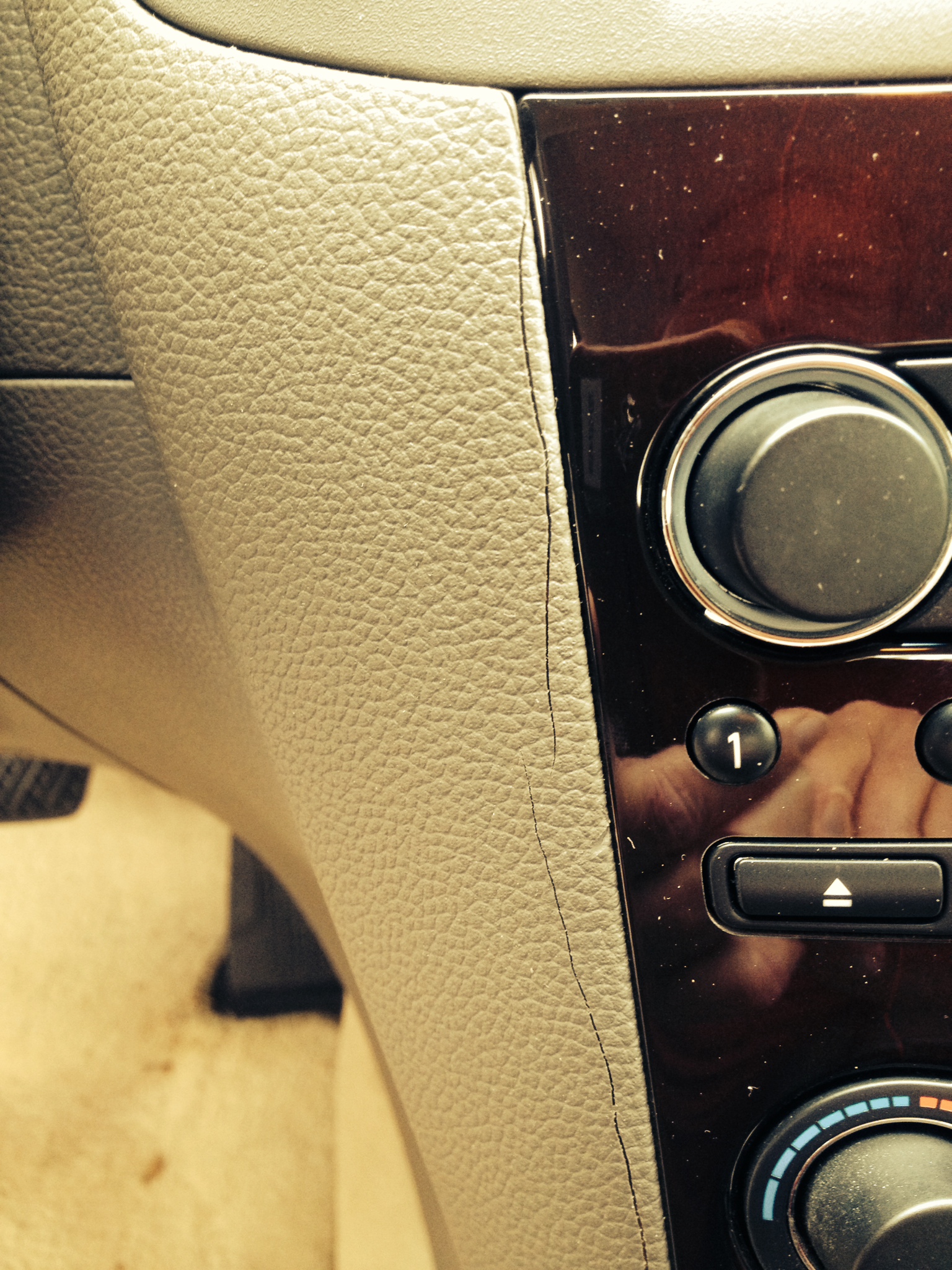

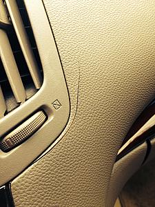

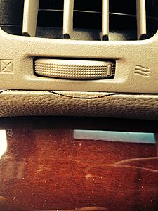

Finally able to upload the pictures. Like I have said before, I have never seen anything like this in any car I have owned, or any friends cars either.
Attached Thumbnails cracked plastic dashboard panels-photo-2.jpg   cracked plastic dashboard panels-photo-3.jpg   cracked plastic dashboard panels-photo-1.jpg   cracked plastic dashboard panels-photo-4.jpg

^NOT cool! You can see those cracks easily on a light colored dashboard.

What's also strange is my iPhone pic's changed the the dashboard fiber color since the color really was a medium gray, but the seats and carpet was the beige color. Course, the so-called wood trim was the correct color.
