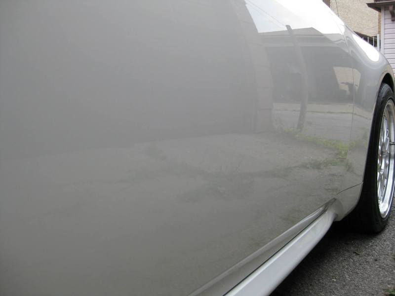

polish will remove the swirls and give the car a shine. Wax will only do so much. This is my car after a full detail. After all swirls were removed and a layer of wax was applied. Your paint will feel like glass after you clay bar it. For first time and something that's easy to use and not destroy your paint, I recommend getting a DA.
Definitely why I listed the compound and polish last stating that it's not something you want to do by hand. That would just be a tremendous amount of work (not impossible, but not practical). But if he clays, seals, then waxes, he will at least preserve the paint as best as he can without performing corrections/leveling.
