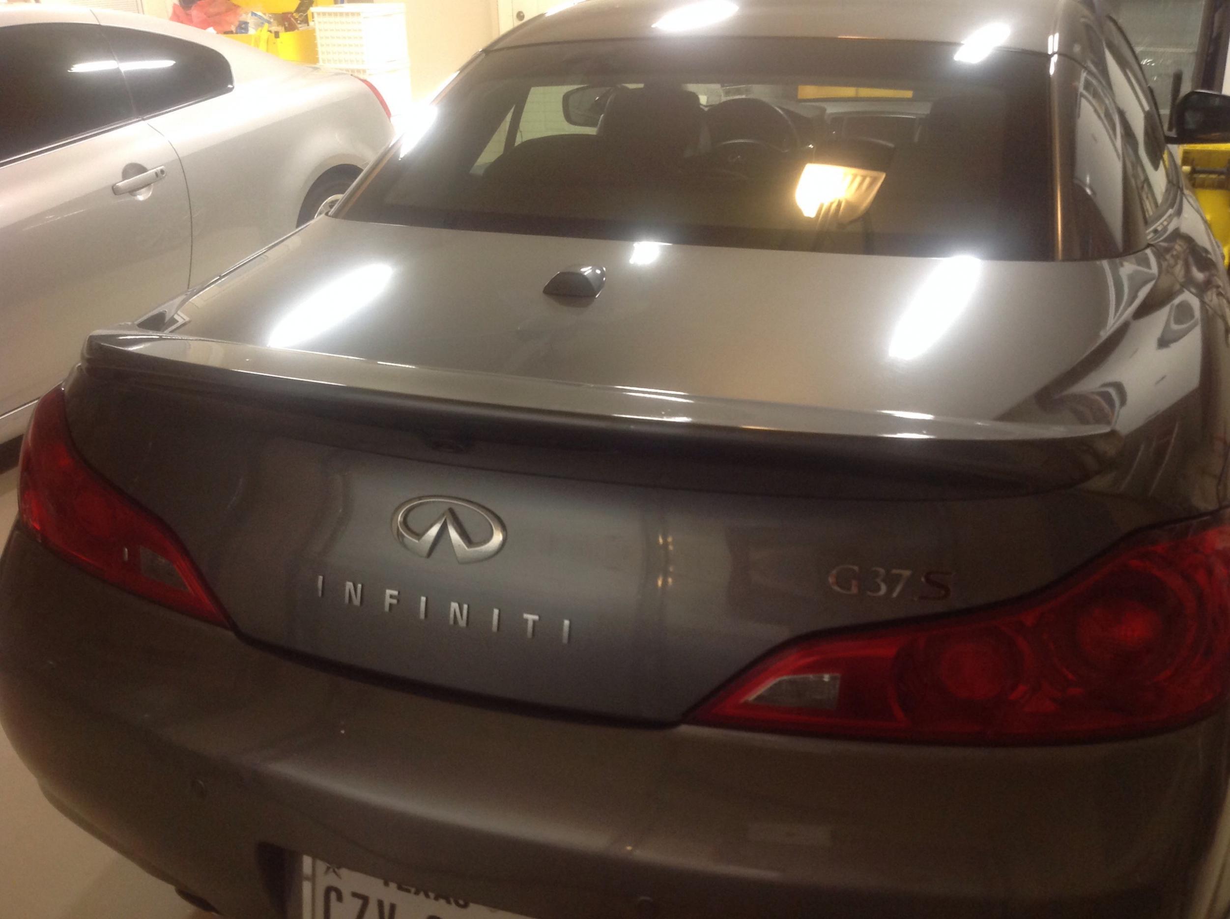

Painted it yesterday and installed today, looks great. I decided to colorsand and buff with it on the car. My wife really likes it and wants me to put one on her 09 K23 liquid platinum coupe. What is the difference in the convertible decklid and the coupe decklids?

Old Apr 28, 2014 | 10:25 PM
miketyler's Avatar
miketyler
Posts: 106
Here's a couple.

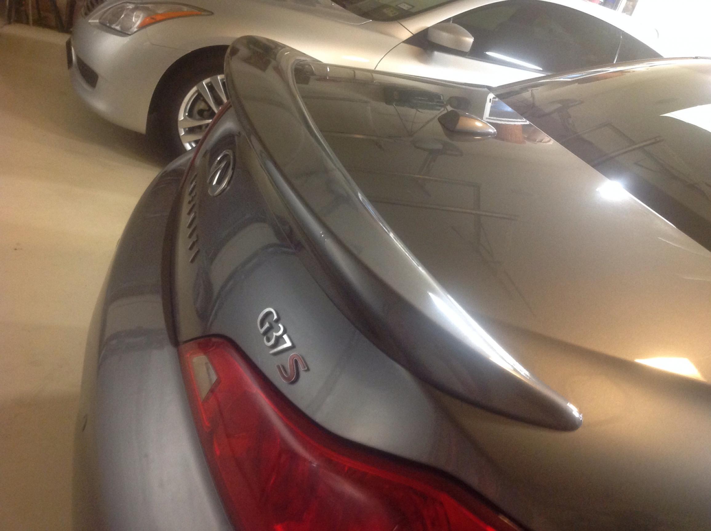

Old Apr 28, 2014 | 10:30 PM
miketyler's Avatar
miketyler
Posts: 106
another one
