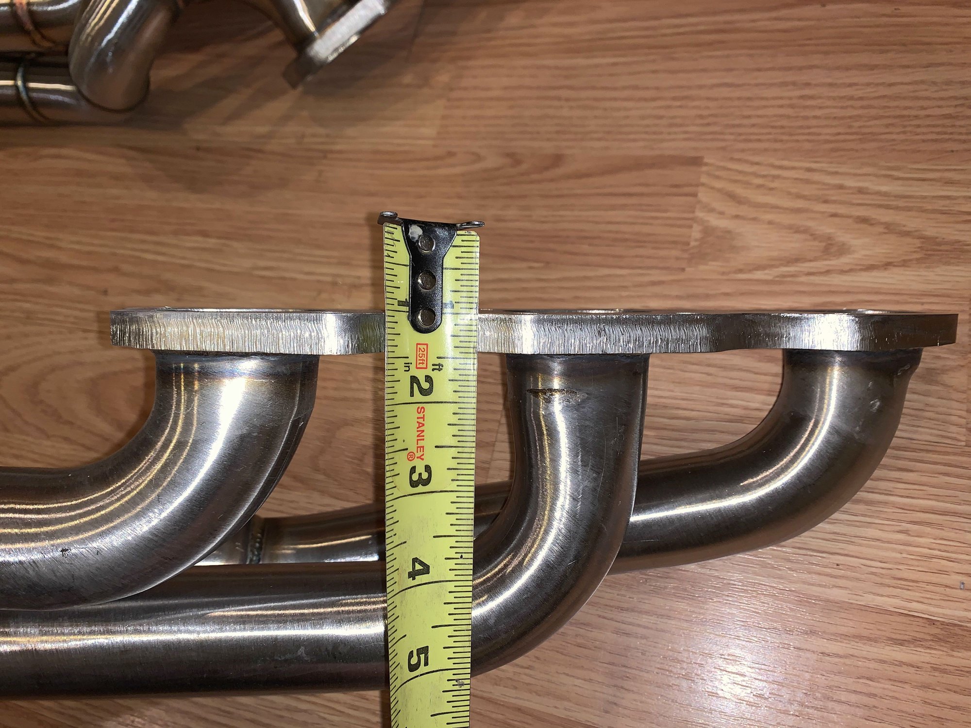

As of 2/14/21, I just received my headers and will provide an initial review along with detailed pics and measurements for anyone looking to possibly purchase these. The pics you see online are either sparse, or outdated versions.
OVERVIEW
I bought these from Import Image Racing, and they came in just a few days. Best price and free shipping. IIR lists it as only fitting 2003-2007 Gs, however CZP lists the same headers with the same part number (IS-SSHD-VQ35) as fitting for every model of G/Z, and I personally know 2 people running these headers on G37 sedans, one of them being RWD and the other being AWD.
INITIAL REVIEW

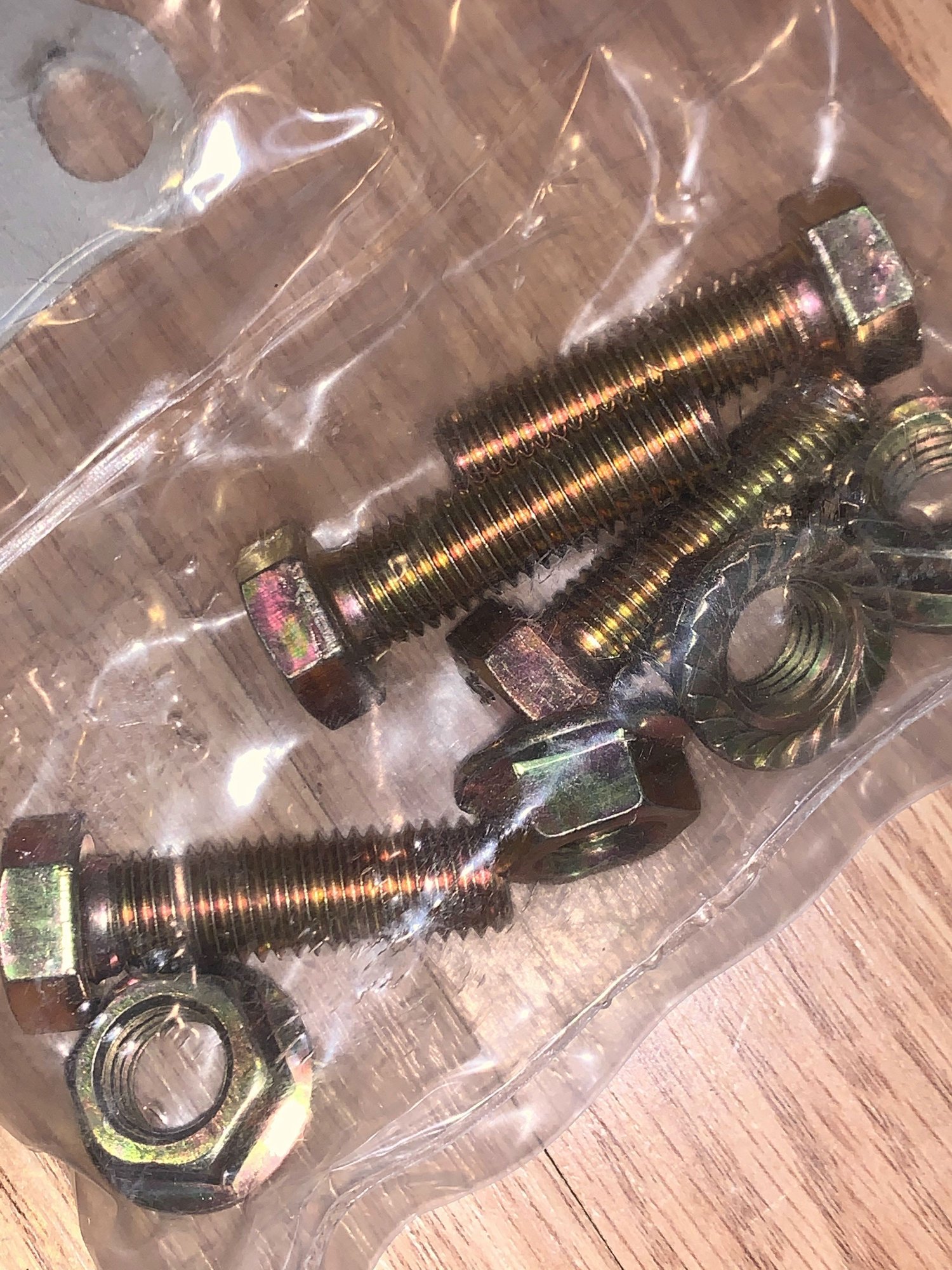

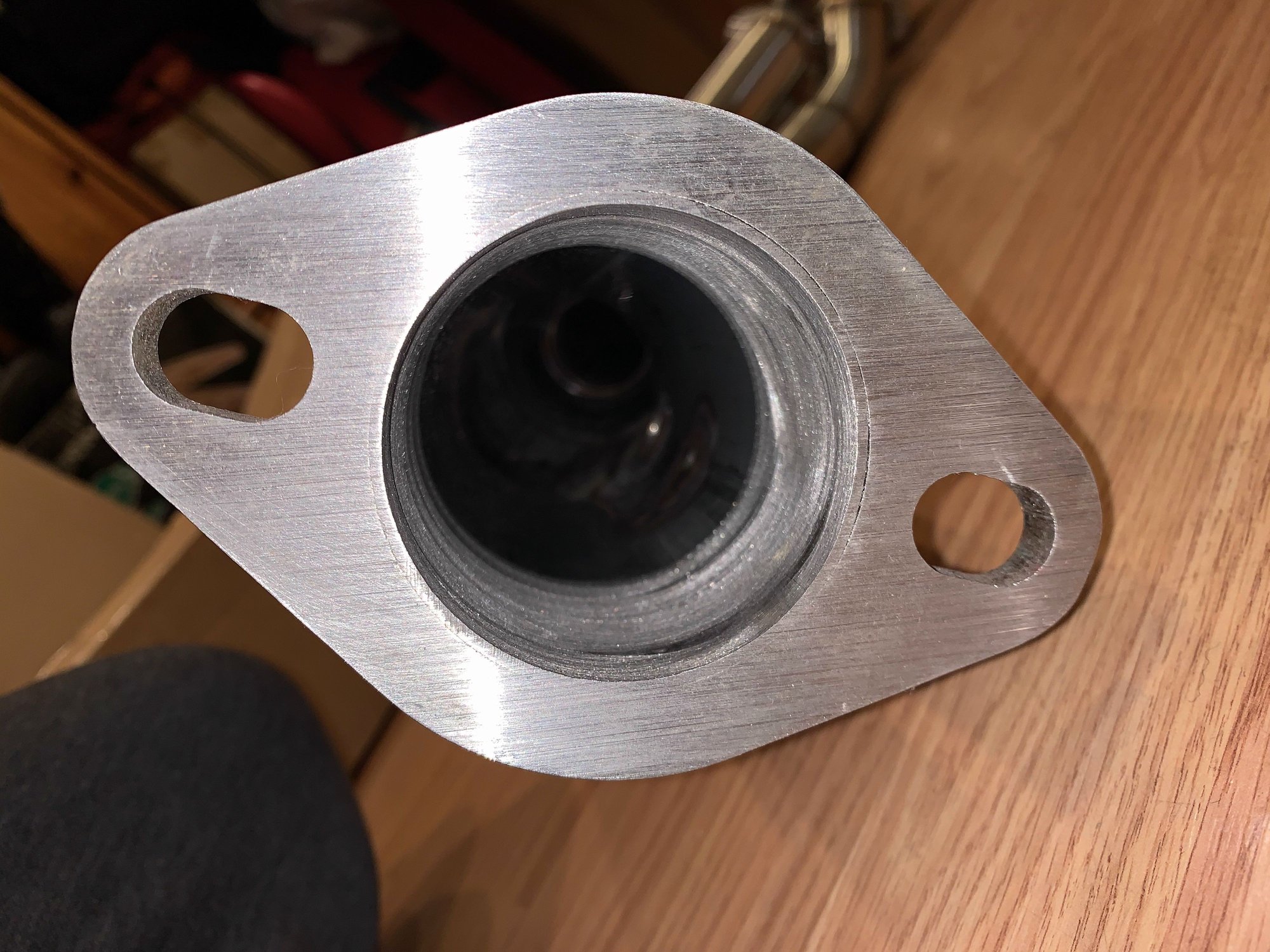

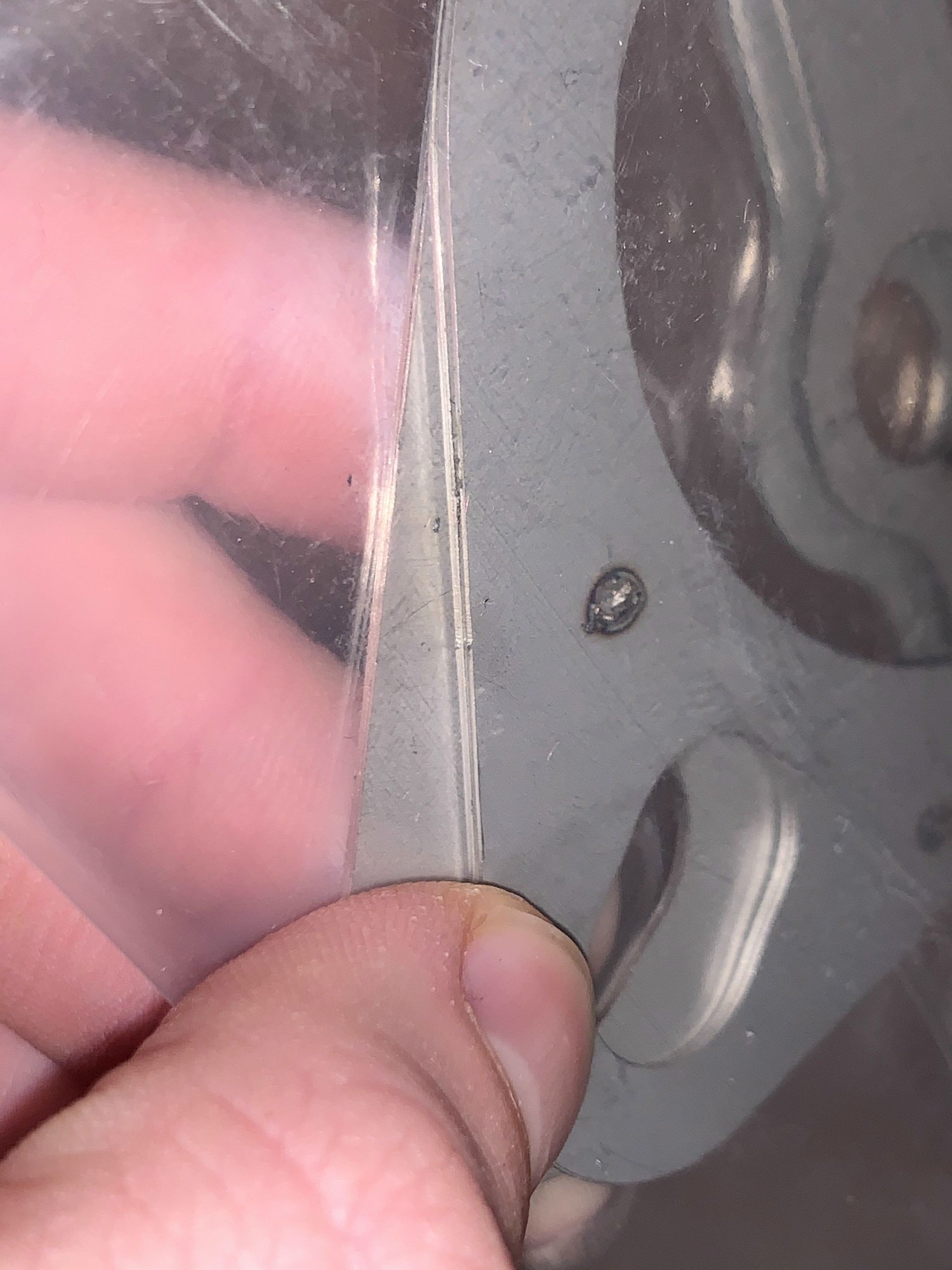

The packaging itself is very nice and secure. Gaskets are all included together in one bag along with hardware necessary to attach to the Y-pipe. Although I don't think i'll be using these gaskets. They look like thin metal sheets layered, and the tack-welded spots on them protrude a fair amount, enough to steer me away from using. I am going to purchase a new OEM one for each head. The welds look good, and the headers feel good. They aren't too heavy, definitely weigh less than OEM cats and manifolds combo. The Y-pipe opening where headers connect also isn't 2.5", it is about 2.35" or so. Not a big deal, just additional info I realized.
Another weird thing, my set had pieces of the plastic that they come wrapped in stuck between the runners. I'm not sure how it even got there but it's there lol. Will try to remove it with fishing line.
The actual headers themselves look amazing, especially for $580 SHIPPED TO YOUR DOOR.

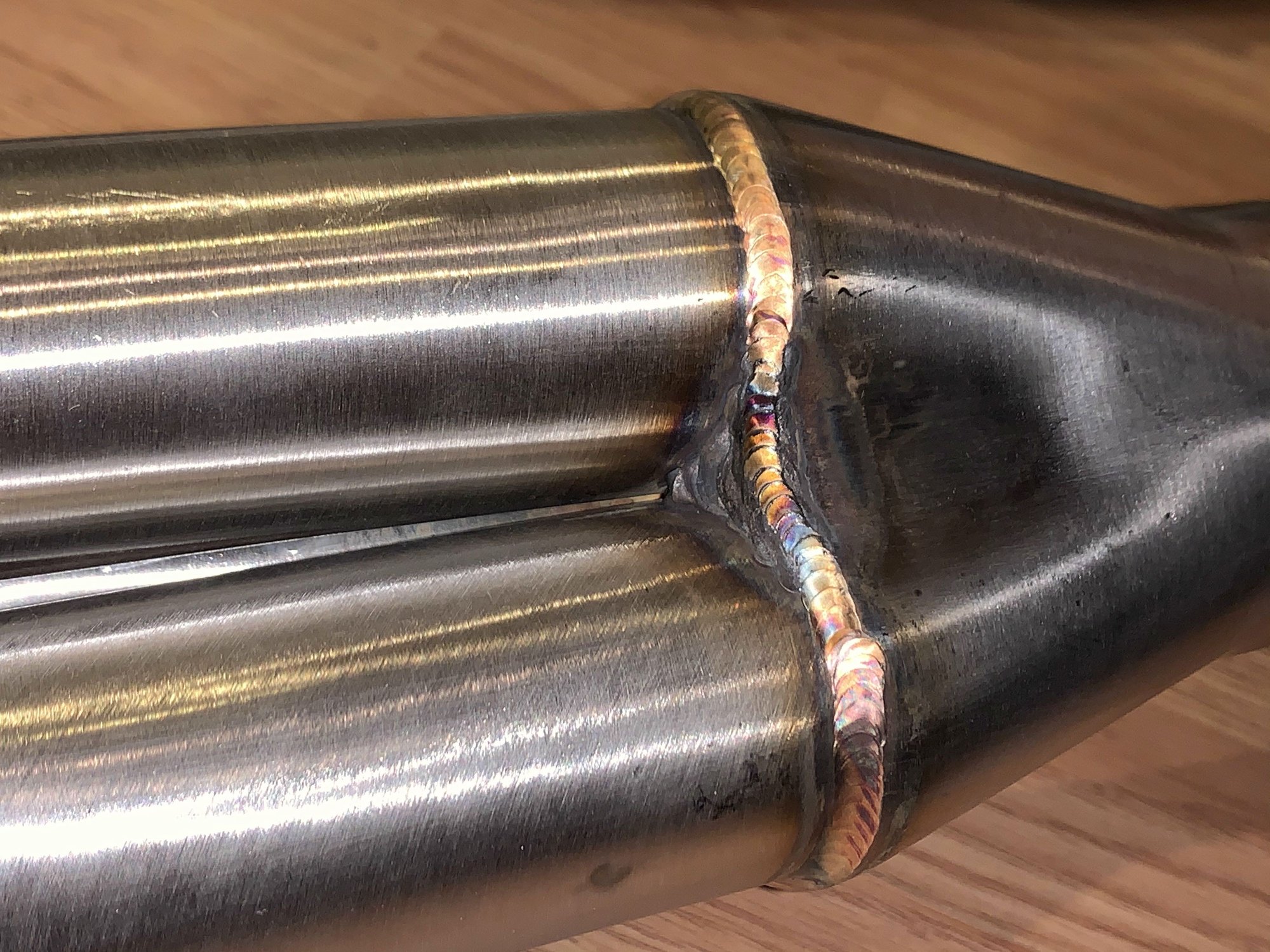

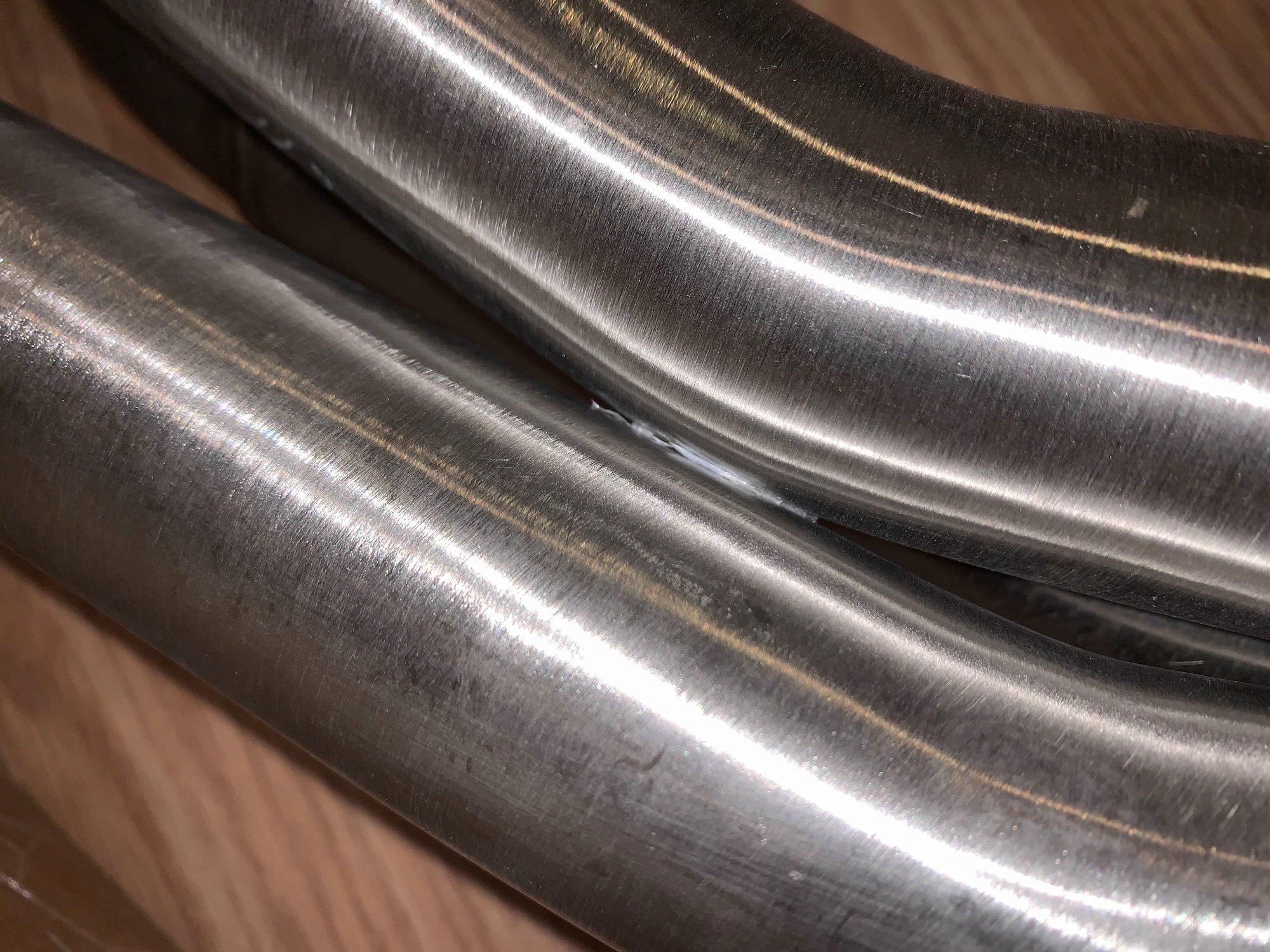

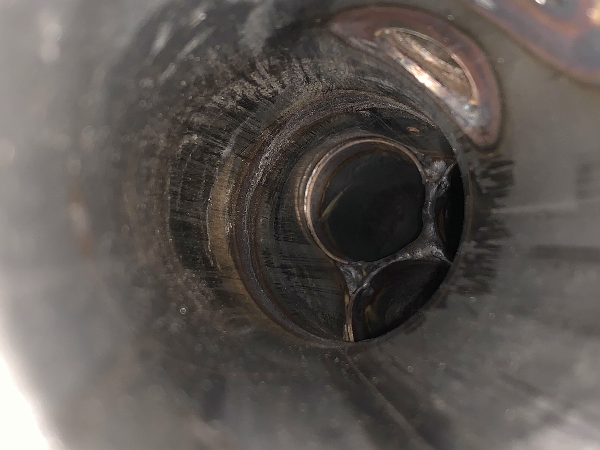

The welds look very good for the most part. There are some places such as the collector where the welds are black and blemished, and look a bit messy. I will leak test this set using my 5hp shop vac and update this post

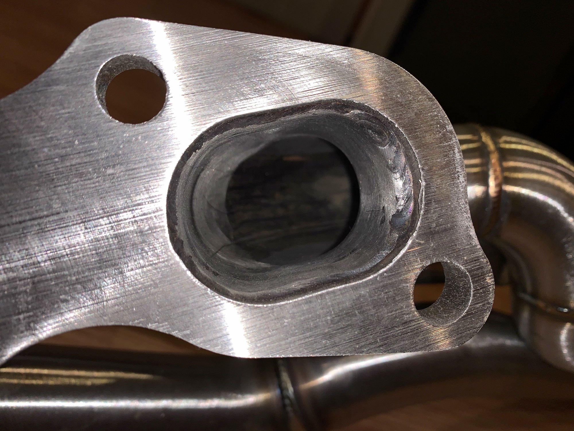

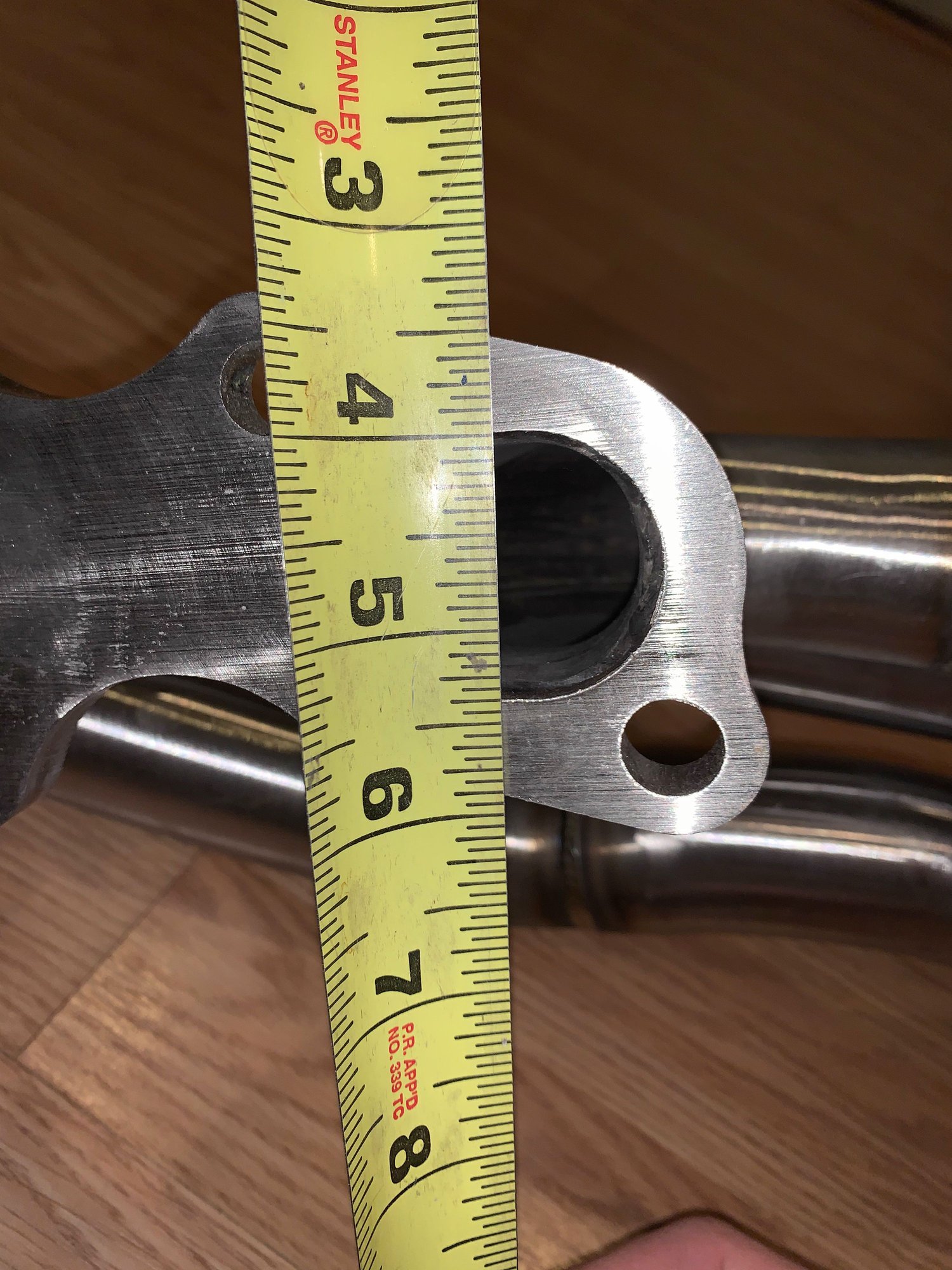

The flanges are all VERY thick. Head flange seems to be a bit thicker than the 2 bolt flange below.

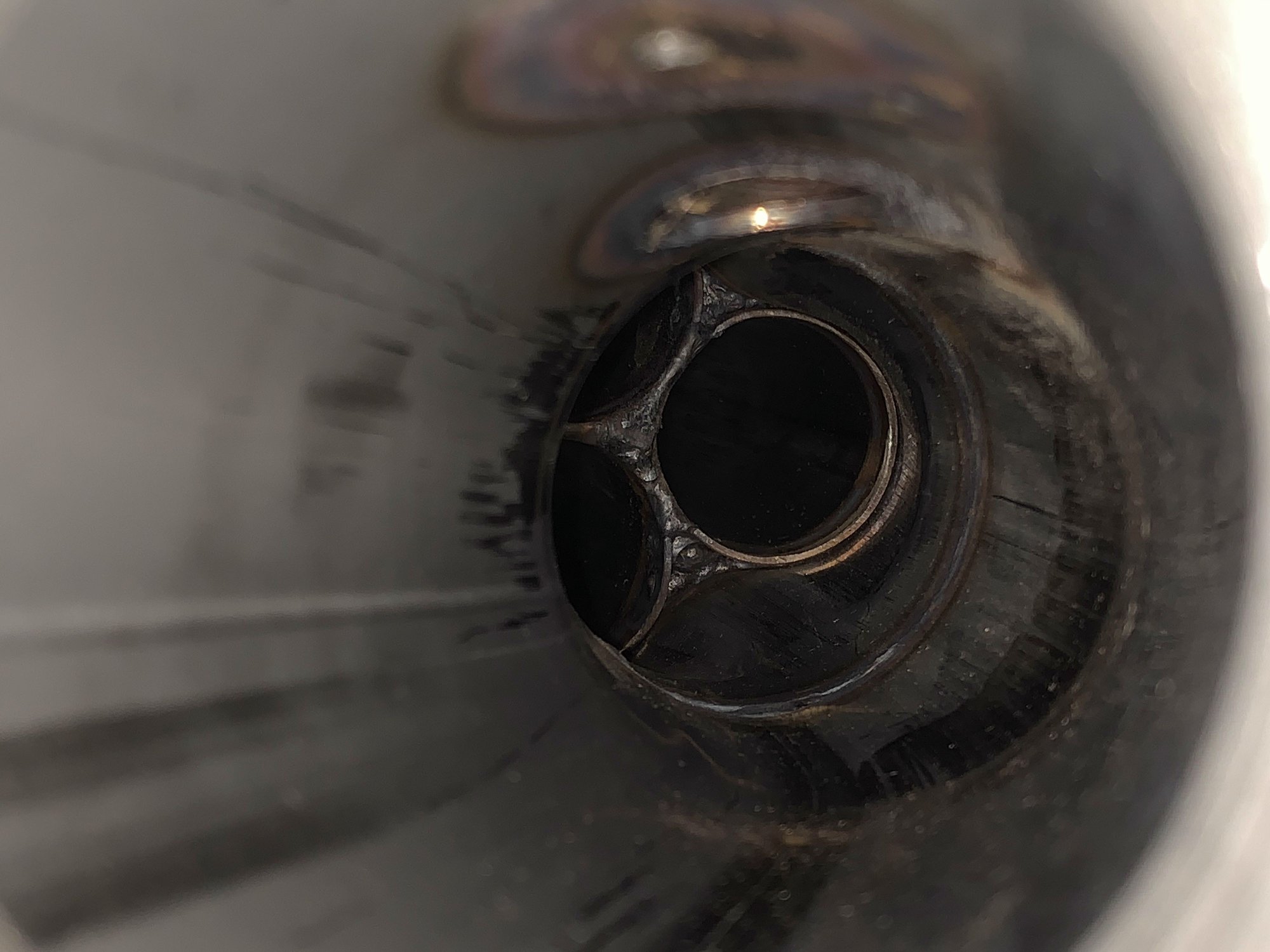

Some people have also reported that the quality of the welds inside each runner opening may be very uneven and raised. I have experienced no such issue. And I even have pics of the collector!!
O2 sensor ports all come with plugs screwed in, however, no extension wire for HR/VHR applications!! Downstream port has tiny hole to help prevent CEL. It is also raised higher than the upstream port.

2/15/21 - More pics just for fun
Raised tack welds on 2-bolt gasket
Y-pipe hardware
Clean welds neighboring the blemished looking welds between runners.
Y-pipe opening
Other collector, with inner welds shown.
You can see the plastic between each runner!! No clue how that got there!
