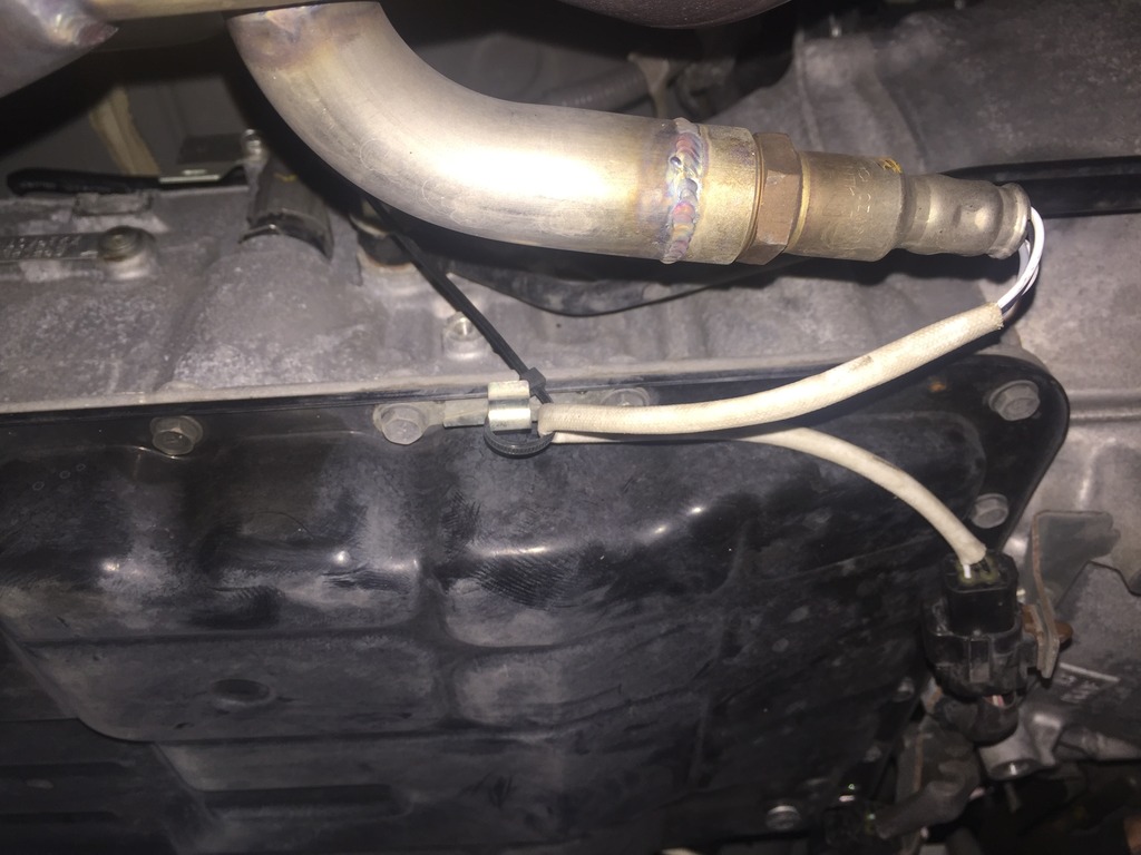

Third, due to the placement of the 02 J-bung (It's shaped like a J), the OEM 02 sensor wire retaining clips are no longer functional. You'll have to zip tie them to the clip as there isn't enough length to run them through the clip properly. I'll take photos of this later.

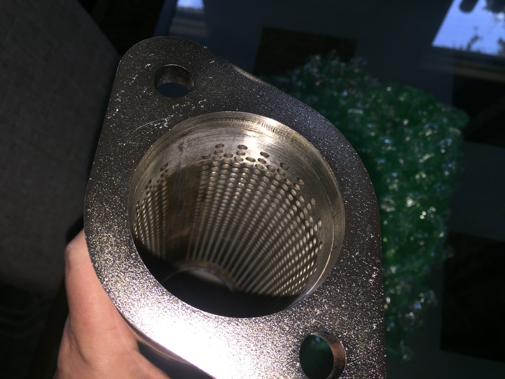

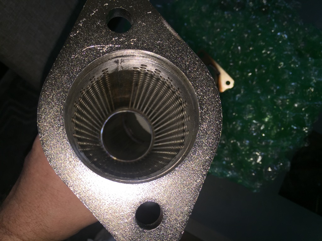

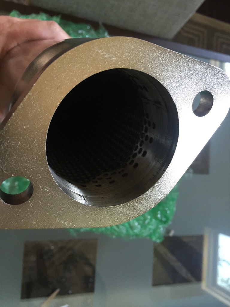

Now the good. They look to be very well-made, solid welds, the inside has been cleaned up and smoothed to help flow and they're lighter than the stock cats by a few pounds.

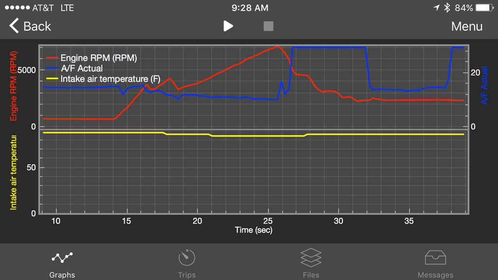

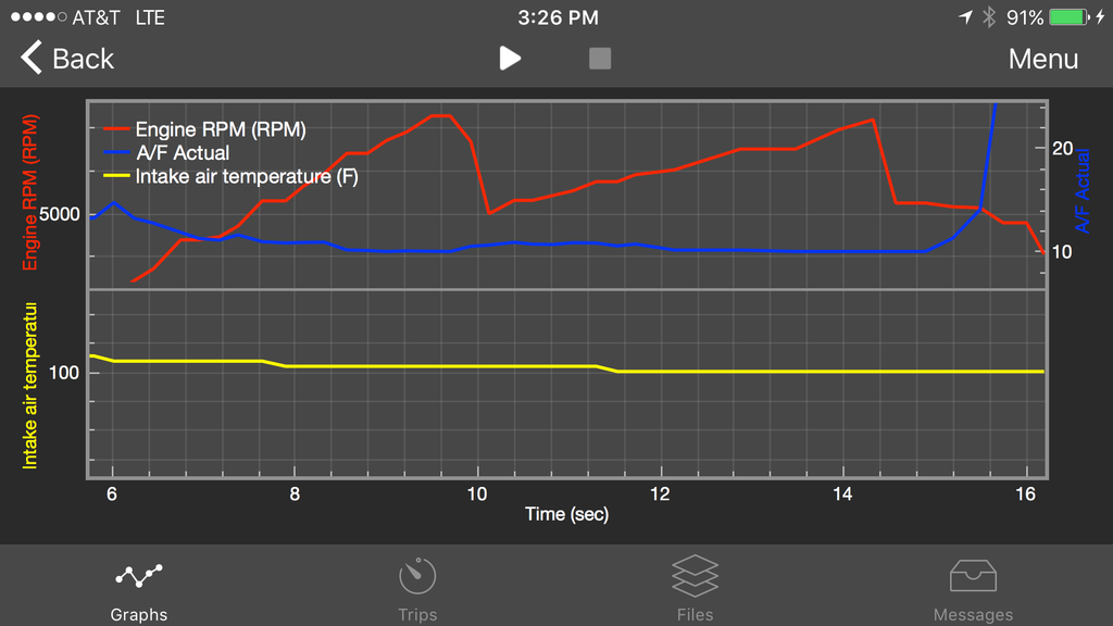

Ok I'd did some data logging of air/fuel and the FI RHFC's did lean the car out over just the Nismo intakes. It's still into the 10's by 5200 rpm and the a/f curve isn't as smooth so the ECU may be learning. This was my first WOT run to redline. Feels great in the low/midrange but falls flat up top.

Yeah am definitely going to need a tune to take advantage of these "power" mods. Hoping the zip ties arrive today so I can put them on tomorrow morning. Will take photos.

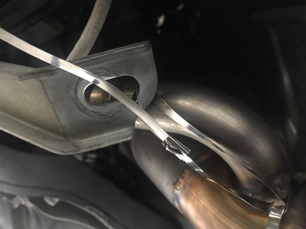

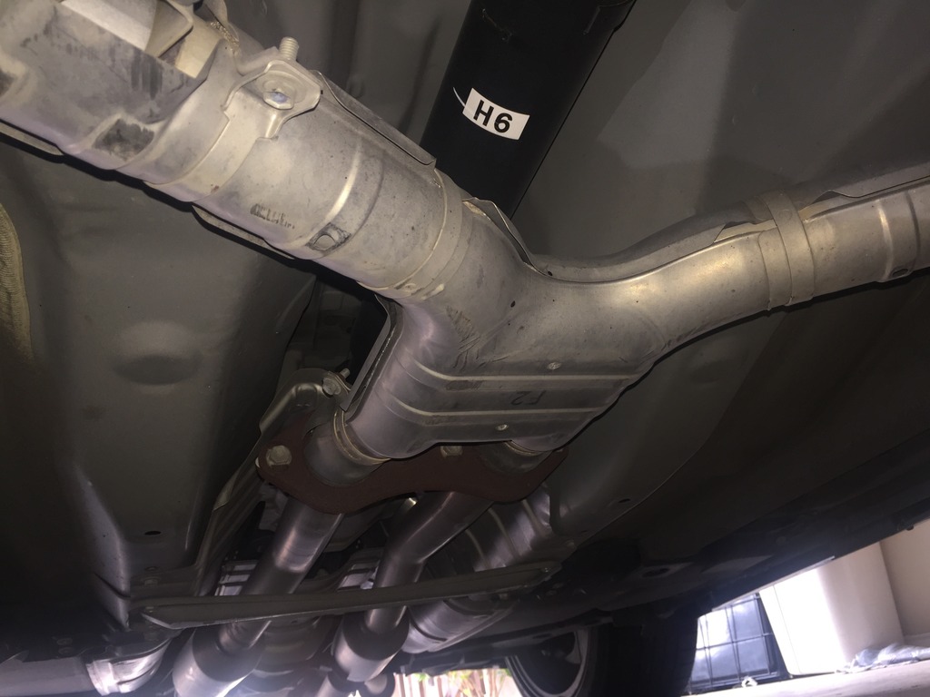

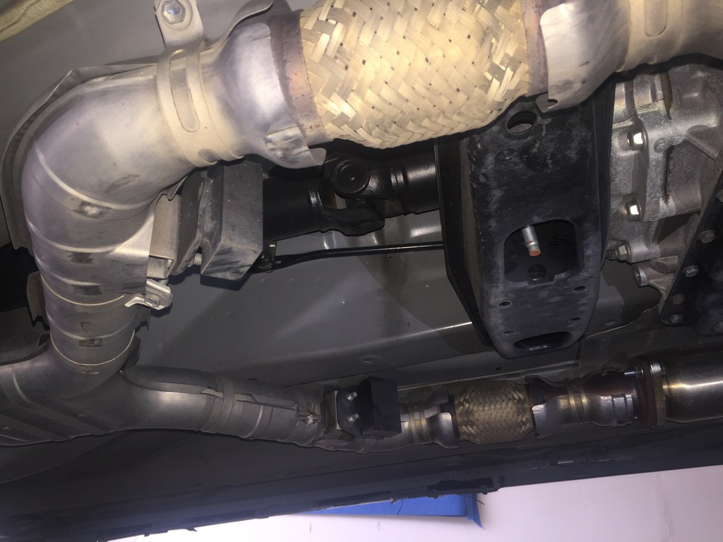

Zip ties did arrive yesterday and it's a no-go on using them in any sort of support role.
Problem number one is the end of the bracket hits the 02 bung on one side. There's a small gap on the driver's side but none on the passenger's side. Theoretically, I could finesse the bracket a bit more and open up the gap between the bracket end and the 02 bung but the zip ties aren't going to do a lick of good.
While I was under there, I made sure the cats were aligned properly with the exhaust. It was more of an eyeball job but I seem to be pretty precise when doing things that way.
I'll reiterate the car is louder on cold startup but quickly settles into a mellow idle once everything heats up, expands and fully seals. Other than the more defined idle burble, you'd not know it was modified in any way.
Zip ties. Yep, not going to do a damn thing.
Driver's side, can't really see the gap between the support bracket and the 02 housing but it's there.

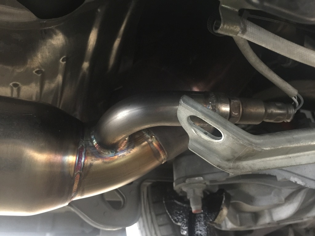

To me, it looks like there should be a bracket there, somewhere, supporting the exhaust.

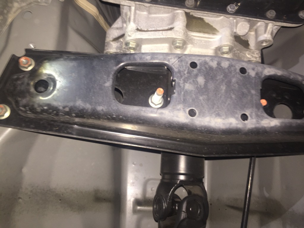

I'm not sure if they're hard rubber or plastic, but those black blocks, can't seem to see any actual purpose for them. They "look" like isolators but they're not attached to anything other than the exhaust piping.

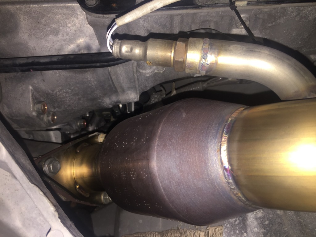

Looking up at the header to cat connection. They turned that color after two days (perfectly normal).
Here you can see where the bracket that normally supports and holds the 02 sensor harness is no longer in the right place and the wiring harness isn't long enough to loop back through it. Probably a small price to pay for no codes. Theoretically you could move it up one bolt but those are oil pan bolts and I'm not touching them with a ten foot pole. If there's one thing I hate, it's an oil leak.

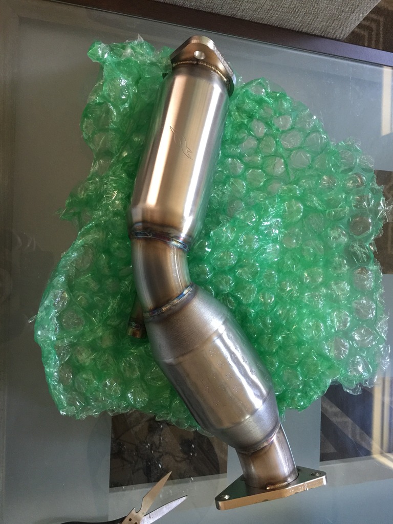

Here's a shot where you can see both the RHFC's complete with FI's logo.

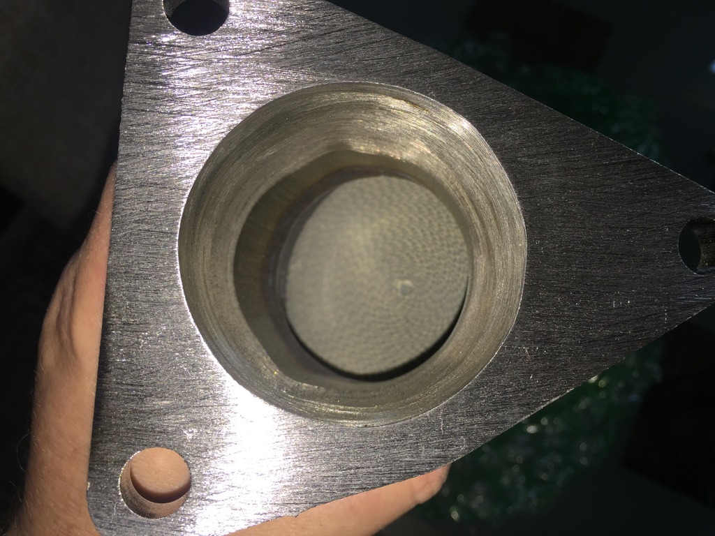

Pre-installation shots showing the ground down innards to provide unrestricted, turbulent-free flow.
I'm going to do a preliminary rating.
For performance, I'm going to give them a 10 assuming they work as advertised once the car is tuned.
For engineering, I'm going to give them a 6. I'd like to see that lip, like the stock cats, to prevent alignment issues and I'd like to see them properly designed with a bracket and more clearance between the OEM chassis to cat bracket and the 02 bungs.
For sound, 8 out of 10. I hear a bit of rasp in the video but the car isn't under load. I don't hear rasp when in the car under full throttle. Here's an at idle video, I have a second but it's still processing and I'll post it later:
Second video, the car's still not fully warmed up so I did not want to rev it much. I have a steep driveway. Looks like an up the skirt shot, LOL.
