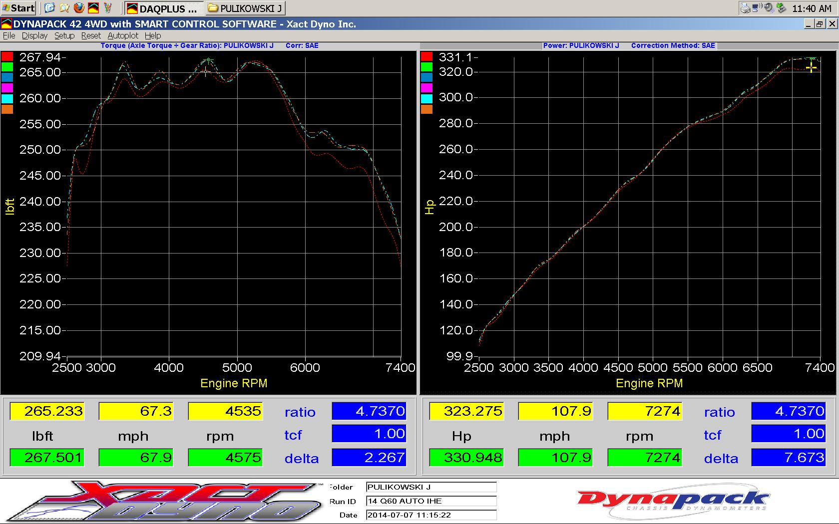

My 2014 Q60S dyno numbers
2014 Q 60 S
Stillen Cat back exhaust
Stillen Gen 3 CAI
Stillen HFC's
Stillen pulley
UpRev tune
It's refreshing to find another 2014 with similar mods as others have questioned my results.

^ wow very nice numbers. Yeah I know what you mean, even rob (my mechanic) was blown away By the numbers I was pulling pre/post tune.
