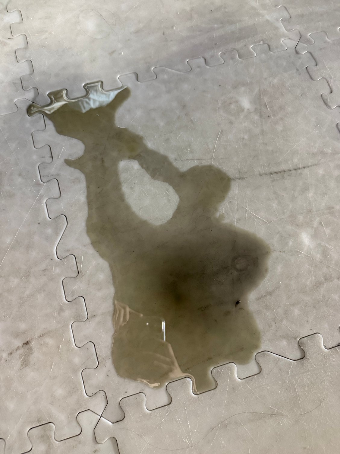

I am thinking I am experiencing CSC failure, but am a little confused as I’m reading online that it generally gradually goes out over time. Today I was getting ready to install my new RJM clutch pedal and I parked the car in the garage and got ready, left to eat and returned and my clutch has 0 pressure. It basically clicks between fully extended or against the firewall, with no play in the between. I’m confused as to if it’s the csc or not because it just happened literally out of nowhere. The car has been driving 100% fine and I haven’t been driving it hard, just went from fine to needing to be towed out of no where. Fluid was under the car too, attached below. Wondering if anyone has any insight to if it can still be the CSC even though it was instantaneous.

My CSC failed on me without warning at 18k miles, way back when it was still under warranty. I got maybe three pushes on a suddenly very weak clutch pedal before it just stayed on the floor useless. You are so lucky that it happened in your garage. I know you don't feel lucky, but imagine this happening in traffic.

I replaced my clutch, flywheel, pressure plate, JIT heavy duty CSC (has worked great for me. Some prefer JWT CSC), rear main seal in February and I was driving one night recently then parked it and was driving fine. Next morning I had MAYBE 1-1.5 inch of pressure and thought it was my new CSC but no fluid was on the ground…I remembered that I wanted to save myself a few bucks and do the master cylinder when it goes out lol that next morning it decided it was old and had enough. I replaced the master cylinder and I’m up and running with no issues
I should also add that I installed Z1’s mild street performance clutch so I knew I was on borrowed time. I recommend that clutch with a single mass iron flywheel. It will have minimal chatter and will feel slightly stiffer than stock and have just enough bite to it to have fun when you want to and with a single mass you can resurface your flywheel. My old flywheel was the oem dual mass flywheel and upon a lot of research, when they start to go, the dual mass flywheel will have vibrations which my g had and I was chasing it since I got the car. I almost cried the first time I drove my car after I had the clutch put in and there was no vibration
I heard when the CSC goes there will be fluid on the ground and no pressure. My advice is to change your whole clutch system including the master cylinder. The only thing I haven’t done yet is the lines. I will say the hardest part is the break in period on a new clutch lol let us know what you decide to do
