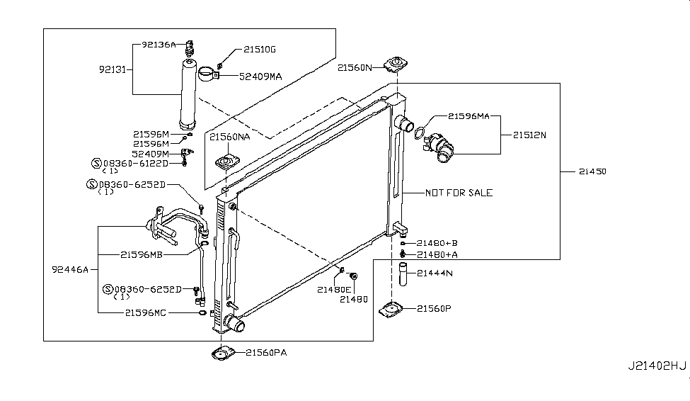

Old Dec 15, 2023 | 01:31 PM
  #26
juster's Avatar
juster
Joined: Mar 2020
Posts: 81
Likes: 19
From: Atlanta, Ga
Guys don't forget there is a bleed screw on the radiator to help get out air when refilling the radiator. Take out this screw and fill up till coolant starts to drip out of the hole then put the screw back in and continue to fill. Tried to post a pic but it won't upload. Its on the upper left hand side looking from the drivers seat. Here is a link to the pic, https://www.infinitipartsdeal.com/re...18b4cffd3f.png
