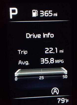

Is the OP driving in lots of stop and go traffic? Accelerate gently? With over 100K miles, the o2 sensors could be deteriorating/lazy (not responding immediately). Or as mentioned, some other sensor could be causing issues.
Most of my urban mpg in the 6mt was in the high teens/low 20's (19-21). On the hwy better at 24-25.
This is what I get in the 4 banger stinger after a highway run. This does somewhat correlate to actual calculated mpg - ~low 30's on the hwy, low/mid 20's urban.
