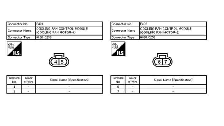

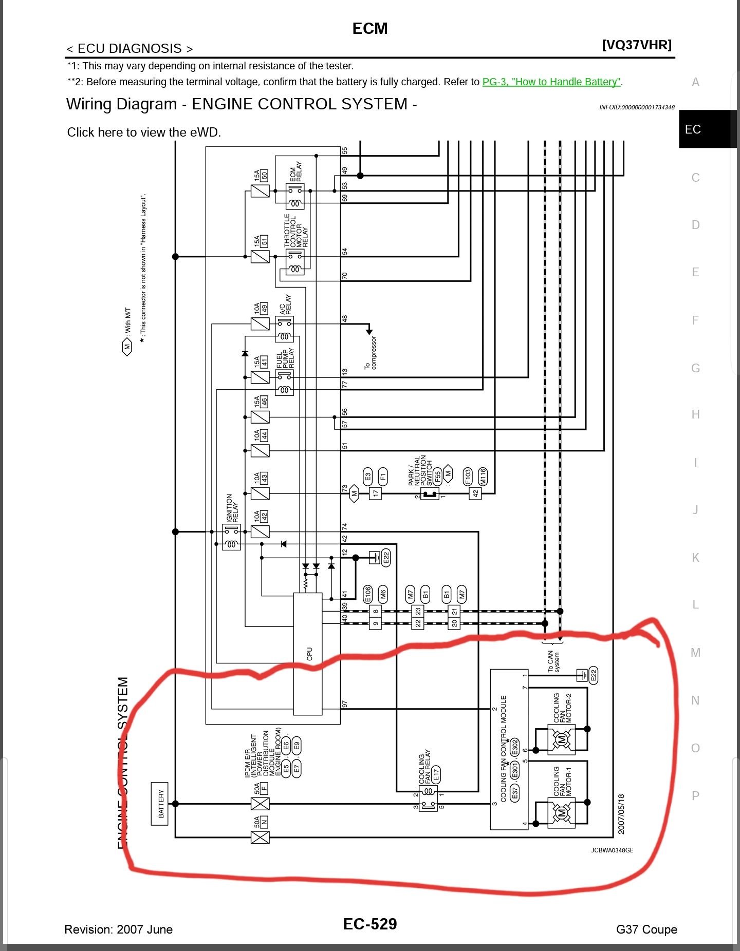

Alright so last update before I take it into the shop to get a mechanics opinion. I took my car out today to my friends place (more space to work), and I looked through the wiring for the radiator. I tested the relay box and the fuses for continuity and voltage (everything looking good in that regard), and I took a peek at the wiring to see if I could directly test the fan wiring or the fans themselves. Unfortunately, there is a plastic shroud covering any access to the radiator fans, and I dont think its worth it to take that off to check the fans, I think we have a culprit. I did the auto active test one more time to confirm everything, and its looking like the same results as before: right fan is weak, left fan doesn't spin up at all.
