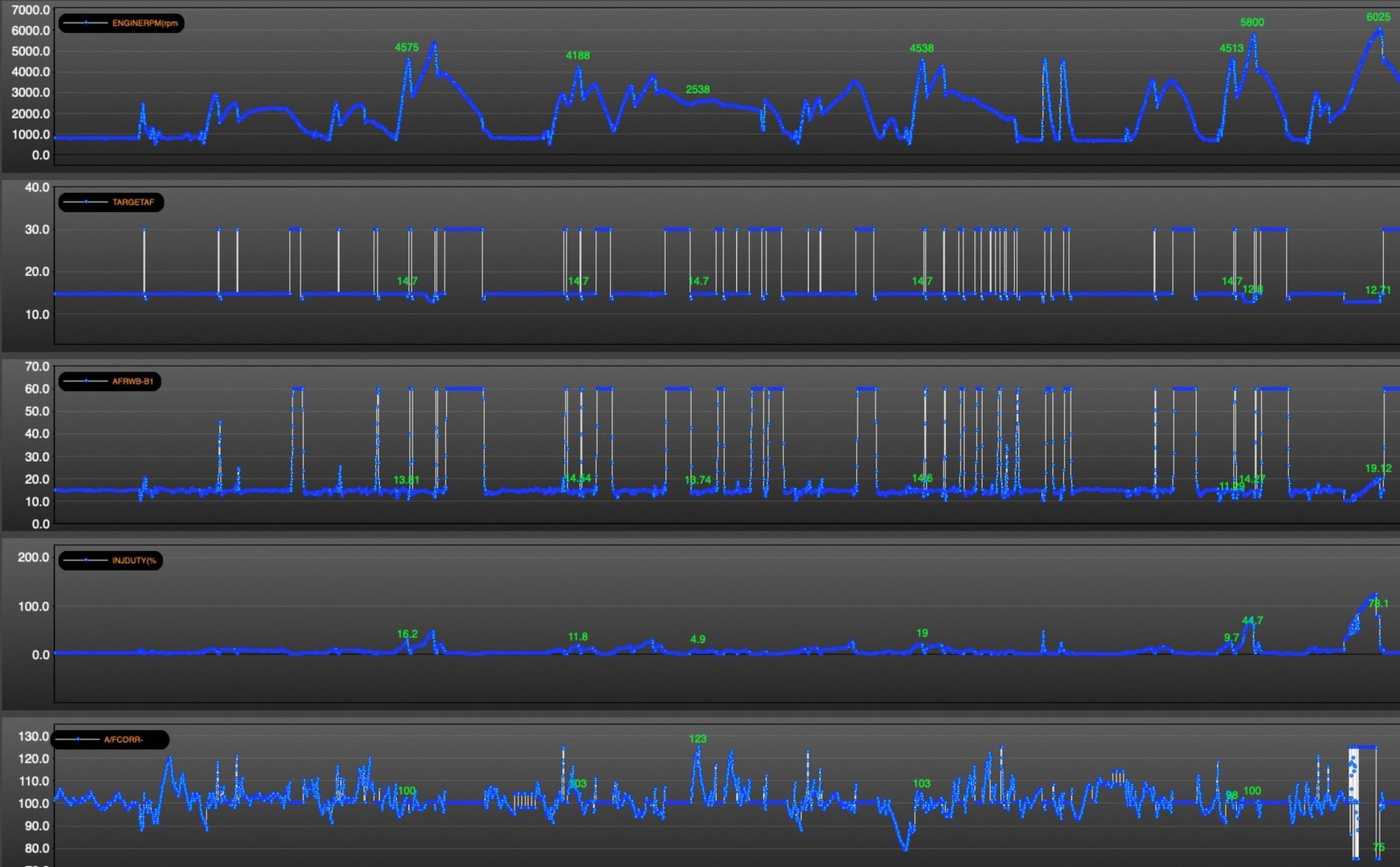

Graph Layout:
• Engine RPM
• Target AFR
• AFRWB-B1 (Measured AFR Bank 1)
• InjDuty % (Injector Duty Cycle)
• AFRCorrB1 (AFR Correction Bank 1)
Other than the weird glitch at the last run to 6000+ RPM it looks good to me:
• Target and actual AFR are close
• Duty cycle is lower than I would expect, but this is not an issue due to target/actual AFR being close. This may be due to the higher volume pump increasing fuel pressure above stock.
• Not shown: Long term fuel trim is good. Min is 90 and max is 104
