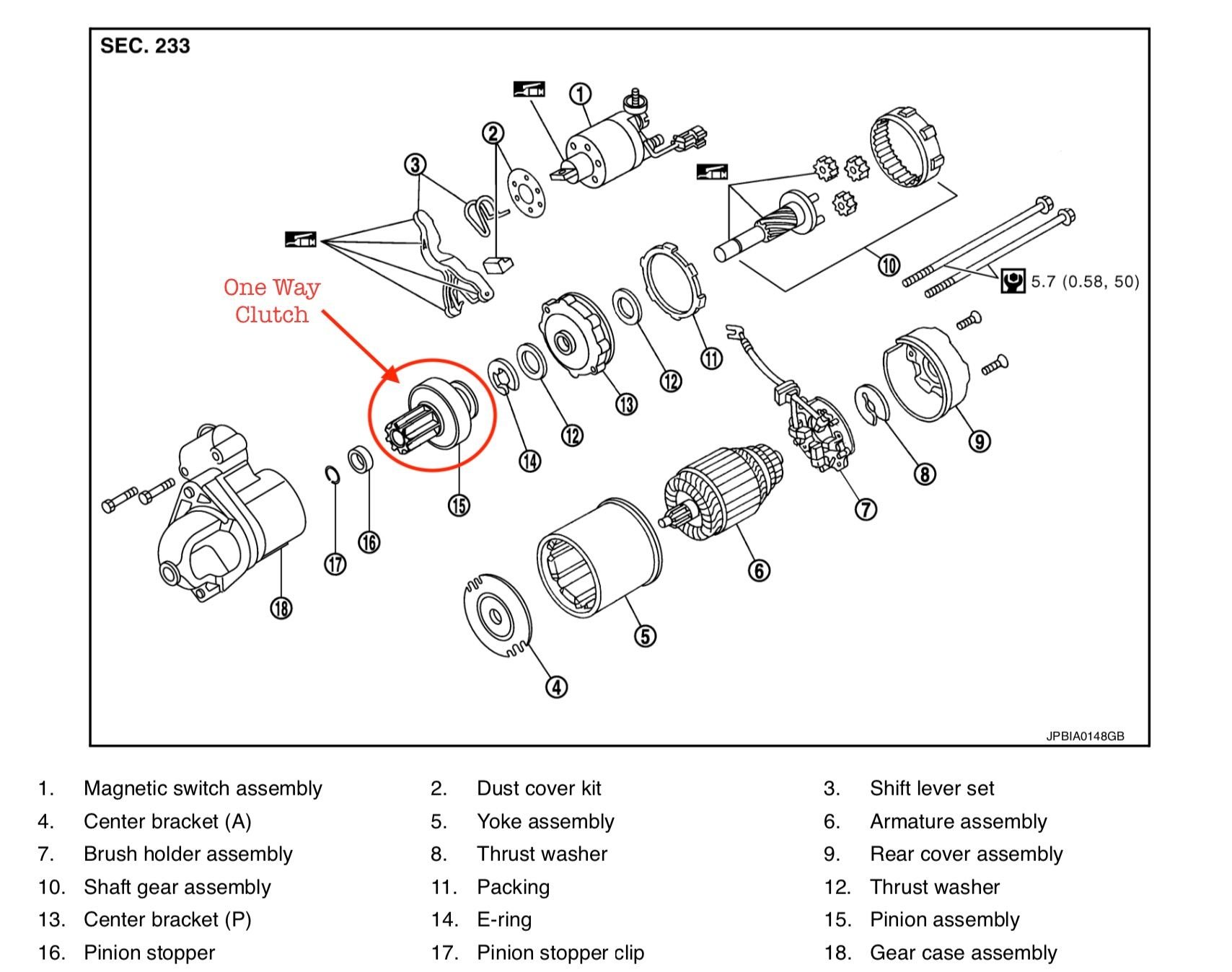

Originally Posted by SonicVQ
I am 99% certain it is your starter pinion one way clutch.
This is located in the gear that contacts the flywheel when starting the car.
When the engine starts to idle on its own, for a moment the starter is still mechanically connected to the flywheel and it overs spins the starter gear, BUT since the "one way" clutch is there, the gear on the starter spins faster BUT it does not drive the starter motor. The torque can only move "one way", from the starter to the flywheel.
Why is it making sound?
Over time, the grease dries out.
What is the fix?
Simply remove the starter, (only simple if rear wheel drive) take it apart, clean and re-lube the overrun clutch.
-OR- just put up with it - you are not damaging anything and you will find the sound will come and go
-OR- buy a new starter.
It's item #15.
After a long aggravating time with the above “fix” I’m 99% sure now that it’s not anything to do with the starter, clutch or any of that. Still don’t have the answer but won’t quit till I find it. I’m not gonna guess. Enough trial and error and wasted time. I did enough of that when I was a kid. Has ANYONE tried this fix with success?
