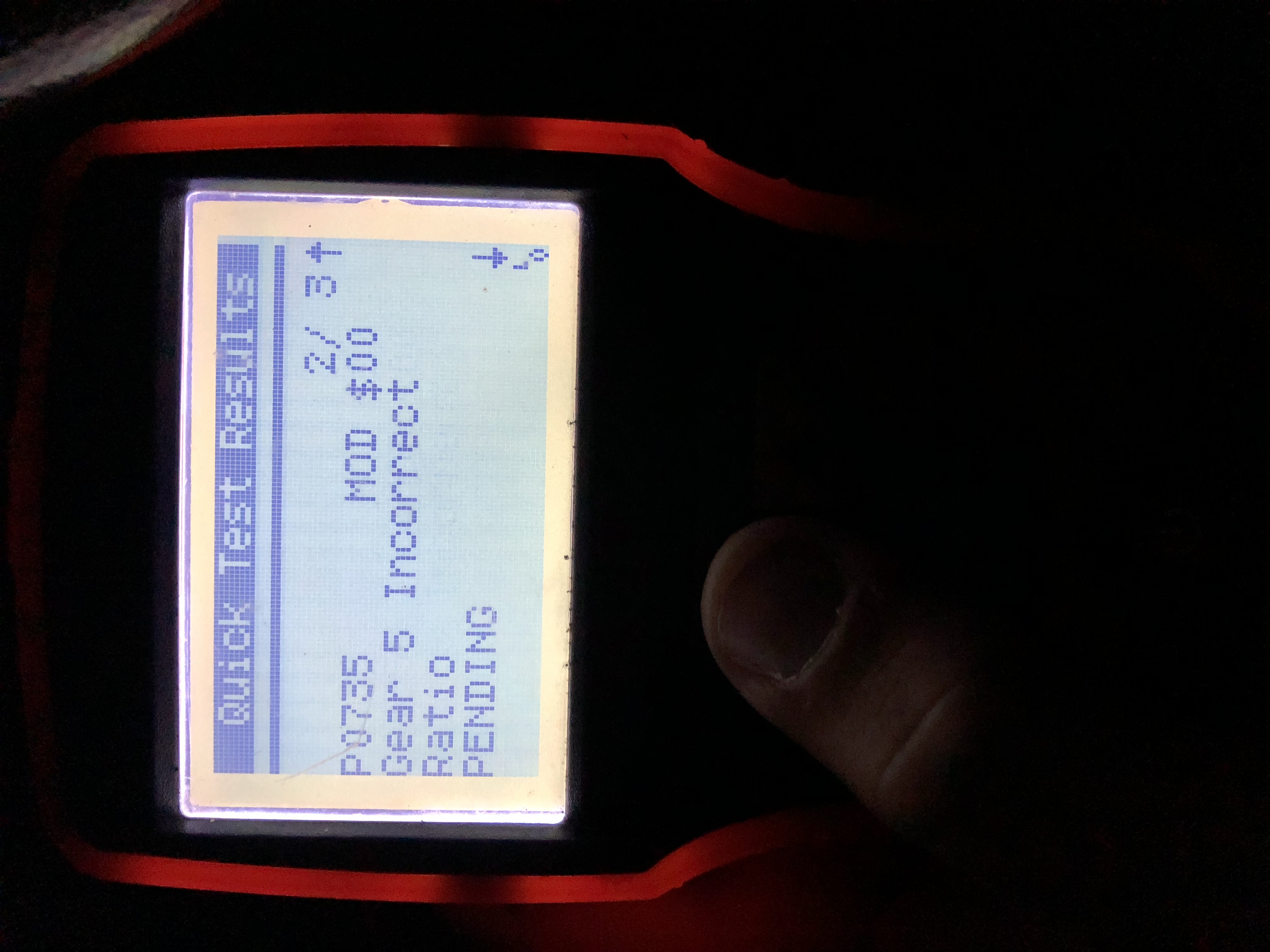

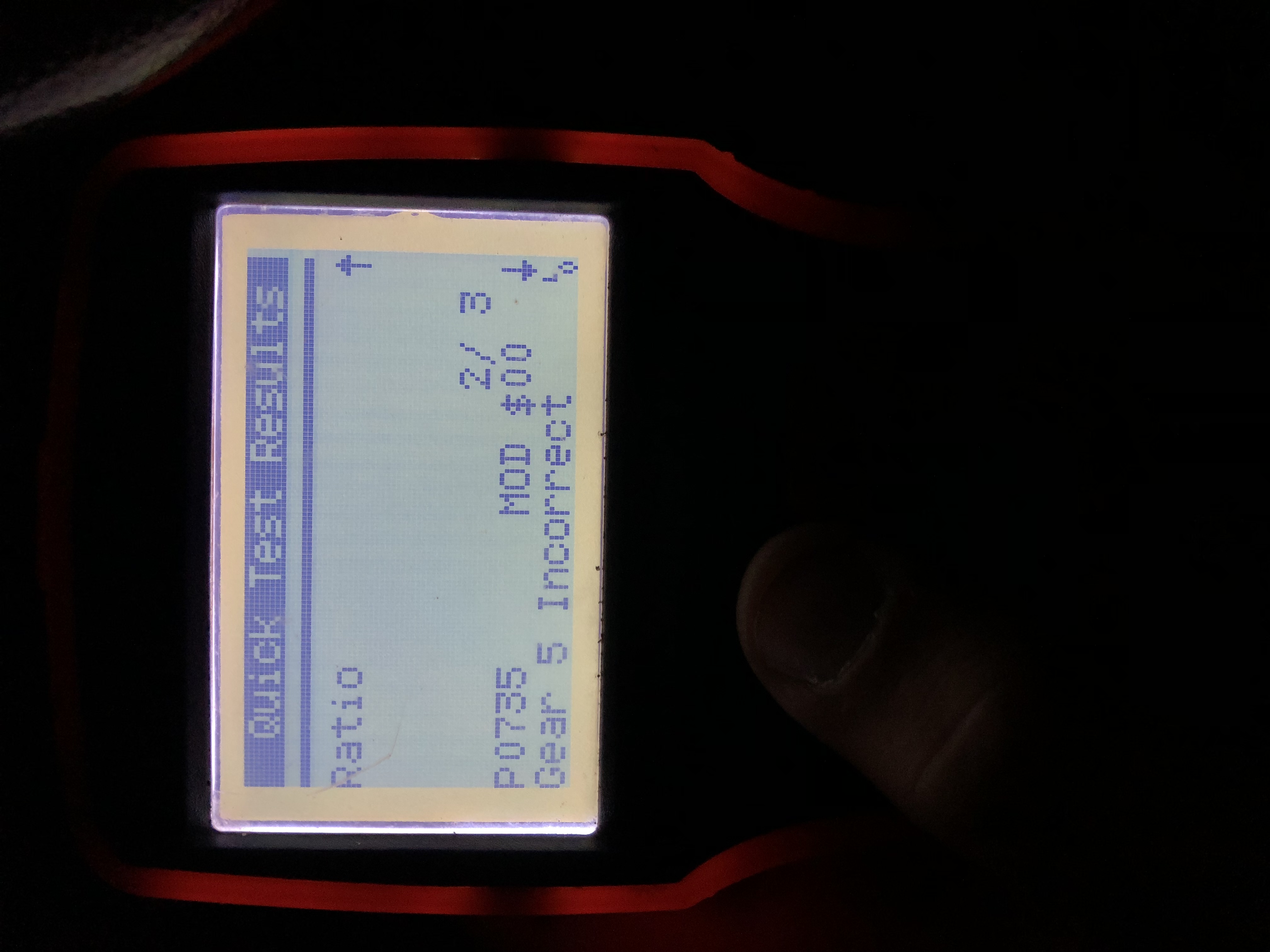

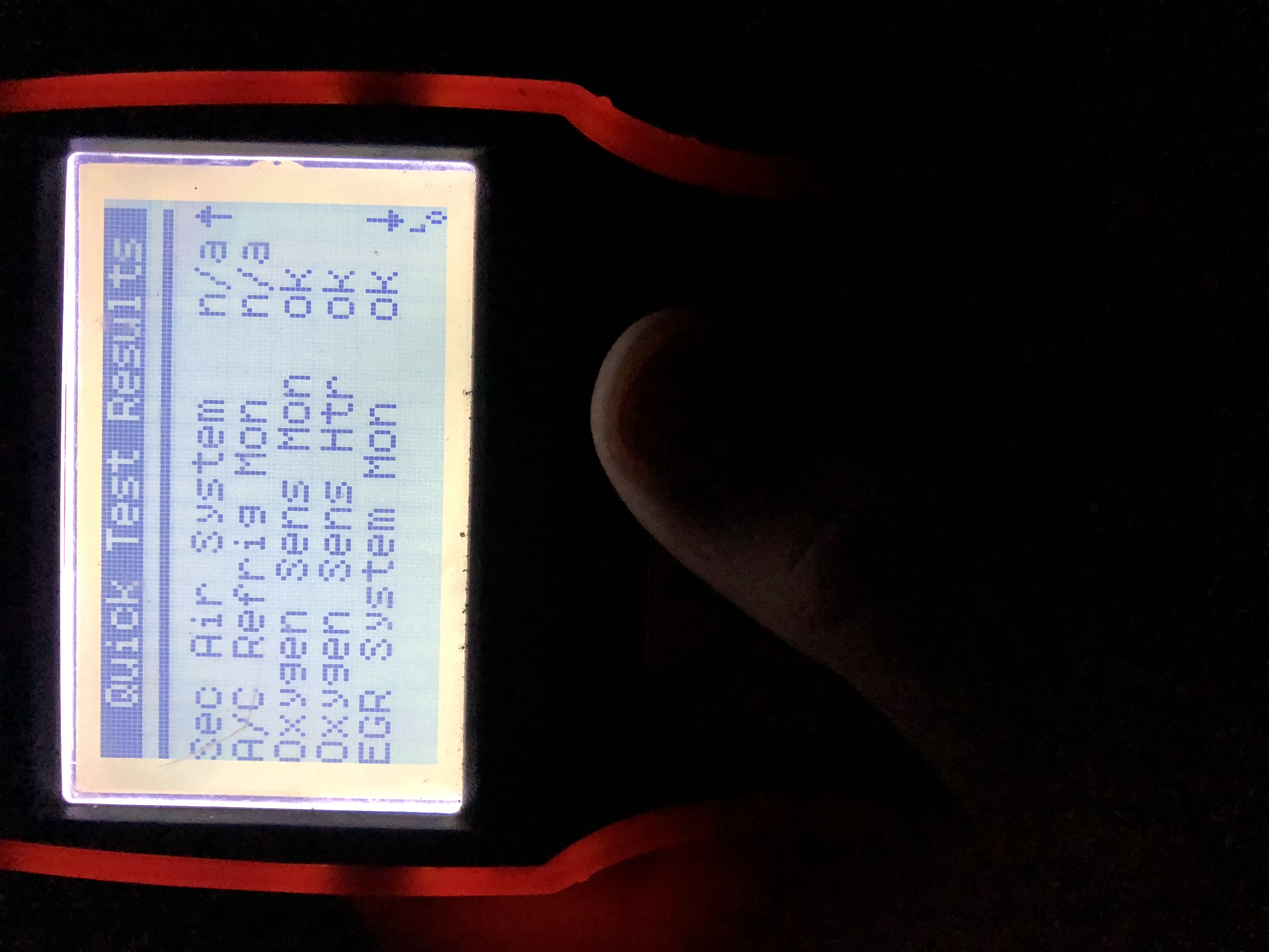

Hey everyone thank you for viewing this and any feedback/advice will be appreciated. I've got a 2011 G37x with Stillen Gen 3/Ark catback and it is tuned, i recently started it in the morning and waited about 5-10 minutes before driving it, as the gears were shifting i felt something was wrong but didnt pay much mind to it as i was getting late to work. When i got on the highway going around 60 MPH my car stopped accelerating and all that was happening was my RPM was going up and down as if i was in Neutral. I didnt understand what it was at first but i ended up pulling over and started to drive manually, i realized the 5th gear is slipping, as soon as it shifted into 5th it would stop accelerating and RPM would only rise. I dont know what to do about this, i took it to a transmission shop and they said they cant see the problem, they would have to open it up and that would cost 1,000 just to open it up. If anyone of you guys have any clue as to what this could be and route i can take i would really appreciate it. Sorry for the long post and Thanks once again! Ive added the check engine codes i received.

2011 g37x slipping at 5th P0735
