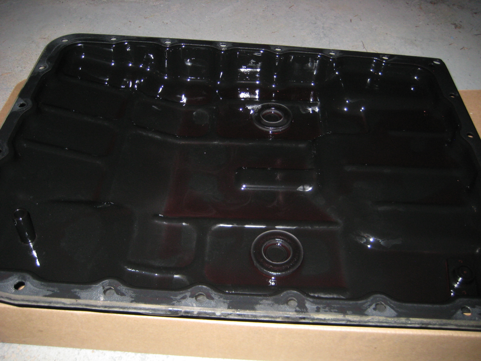

I have a 2011 g37s with 7AT. I have read the DIY and have the fluid etc. I am looking for confirmation of where the fill plug is on the transmission. Am I supposed to use the overflow plug (driver front corner of trans pan) and fill it back up there?

See that tube in the bottom left corner, that's the fill, the other plug is the drain.

OK, got it. Thanks blnewt!
