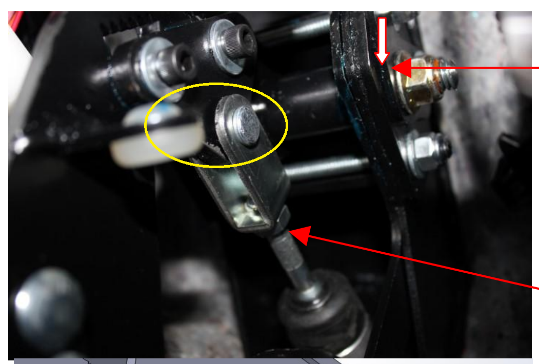

I meant to post this sooner but just haven't been on here much lately.
Ryan probably already mentioned this to you. In any clutch system, there *MUST* be some amount of free play in the linkage so as not to apply any PRELOAD pressure to the slave. This is the same as resting your foot slightly on the pedal. While not depressing it enough to fully disengage the clutch, any preload pressure can cause slight or very partial disengagement. This results in slip, heat and premature clutch wear.
Look under the dash at where the pedal clevis meets the pushrod from the master. As you articulate the pedal slightly, there should be some visible play at this point.
Play should be in the area circled in yellow.

It's been a while since I helped someone install one of these. Going on past experience with clutches on bikes, some play was always required to ensure no preload and full clutch engagement.
Push down just enough to remove linkage slack (don’t drive the MC down),
This statement can be open to interpretation. How much is too much.... I look for a little slack clevis/bolt area. Just a little, maybe a 3-4mm of movement.
