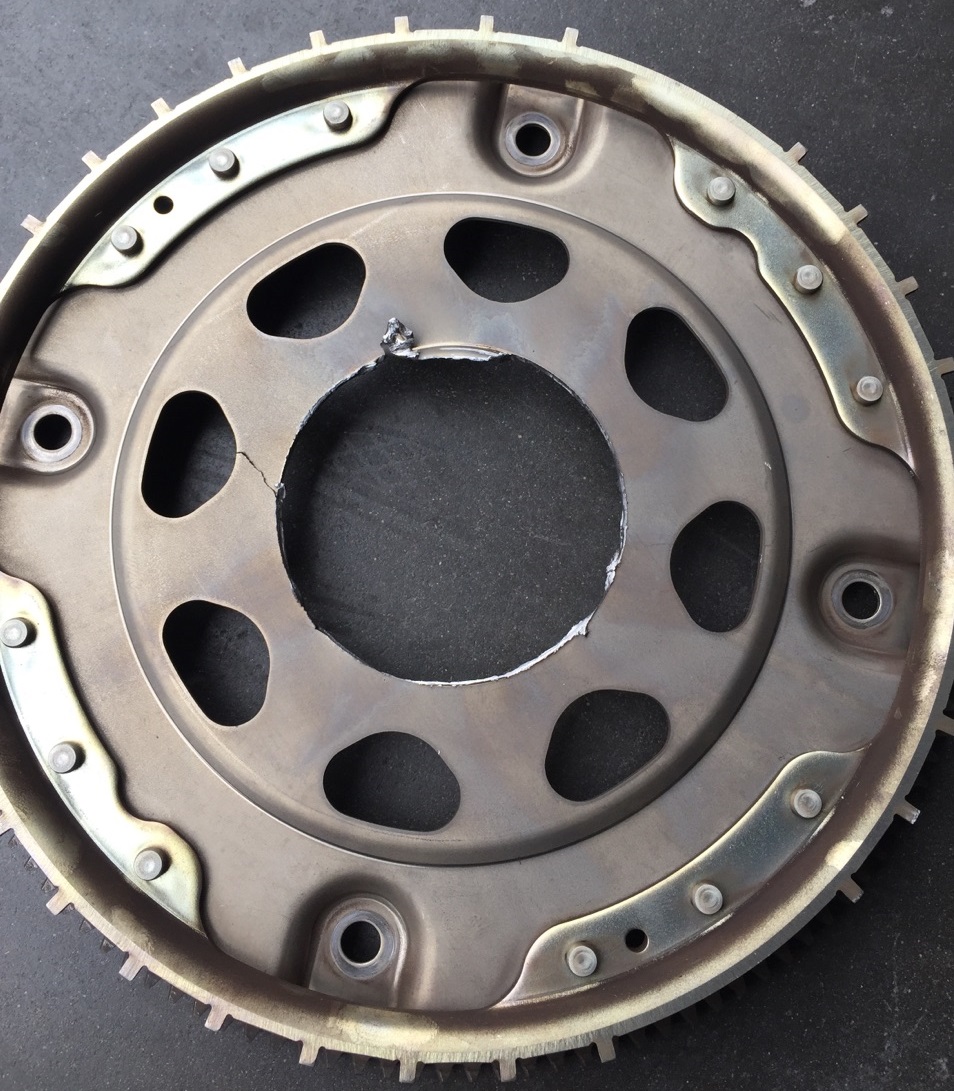

Doh, so it looks like the flex plate completely sheared apart. This is pretty unbelievable to me that i can do that. I'm thinking this can only happen if somebody manages to redline the car in neutral & stick it into gear? The other hypnosis i have is the the flexplate was "flexing" way too much with the new transmission, so it finally gave out.
Otherwise, yes, I do "accelerate" from a stop to 45mph often, but I don't think that is out of "normal" use.

Did you buy it used? It sounds like you bought a lemon. No that is not out of normal use. I dog the hell out of mine everyday and I've had no major repairs as of 69k miles. I redline it everyday, always shifting it and never in drive. I even drive it sideways when there's no traffic and brake launch it often.

So I got a hold of one of the Infiniti consumer affairs, Lauren, Regional Manager, and I didn't get much out of that. Understanding its costing someone money to pay these guys to work, I had offered to pay for the labor and only asked for some help on getting a discount or reimbursement for the parts only.
She was somewhat nice, and pretty much straight forward with me. Can't do anything, and she spoke to her service manager(Steve?), and she relayed back to me this is normal wear & tear. The car only has 64k miles..She said that is normal wear & tear is like the brakes or tires & its dependent on the driver. At this point, i tried to logic a bit more, such as quality of the build, and possible look/misalignment install problems with the new transmissions. She said the car shouldn't have ever started if there was any problems, and basically stone walled me and said no to everything. I don't race, drift, track, or push the car to its limit, so I don't think it the driver... No point in wasting more of my time as its pretty obvious they are not going to help a loyal customer.
Infiniti Corporate, guess they don't care about their older cars anymore, or the quality of their material anymore. I take this as a lost and I'm going to lose more time($$) if i complain more. Probably won't be looking for another inifnti in my next purchase.
The local dealer, they are awesome & have great customer services. I don't blame them for any of these issues! (unless of course they actually jacked up original transmission install )
I attached a photo of the sheared flex plate + what it the other part looks like on the engine crank.
Attached Thumbnails Whats the ball park range to repair g37 engine/tranny?-enginecrack_img_34641.jpg   Whats the ball park range to repair g37 engine/tranny?-shearflexplate.jpg

That is not normal wear and tear.

If they replaced your transmission and it failed in a year there is obviously something wrong with the parts or the installation. I would advise speaking with a lawyer. That is completely unreasonable.
