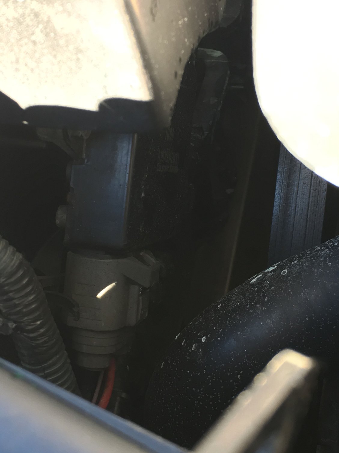

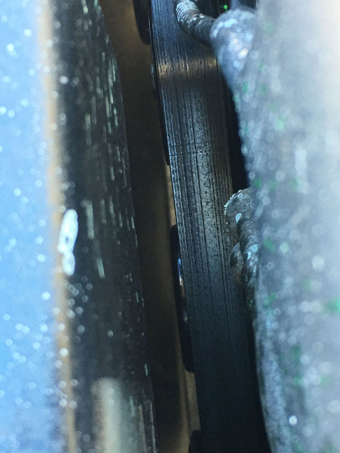

Got a replacement not long ago. The radiator is doing the same thing again. LEAKING! I changed hoses clamps and cap.
This time leaking both coolant and Freon. Awaiting response from Ken@csf.
I dont even even track my car. I’ve spent hours messing with this csf radiator for the automatic trans. Not happy at the moment.
The coolant has covered under hood multiple times now. Stuff is getting stained blue. Very upset.
Old Jan 6, 2018 | 08:07 PM
Mattlorentzoe's Avatar
Mattlorentzoe
Joined: Jun 2015
Posts: 773
Likes: 157
From: Gwinnett County, Georgia
All over everything. Covered the bolts, belt,hood,hoses, engine cover, intakes. Everywhere.........

From my understanding it’s a all in one system. The A/C condenser, dryer, and A/C lines are also part of this cooling system. Not sure how to explain it, but definitely Freon squirting and definitely coolant spraying out somewhere. At first it was just coolant. Tried changing clamps hoses and etc. Still same issue no difference. Sent a email after business hours, csf was great with me last time. Let’s see if I can go 2/2. The car smells so bad, that’s how I found the issue. It still keeps the temps incredibly cold. It just leaks.

Ken at csf refunded 100% of my money no questions asked. They wanted to make it right any way possible. Outstanding customer service.
