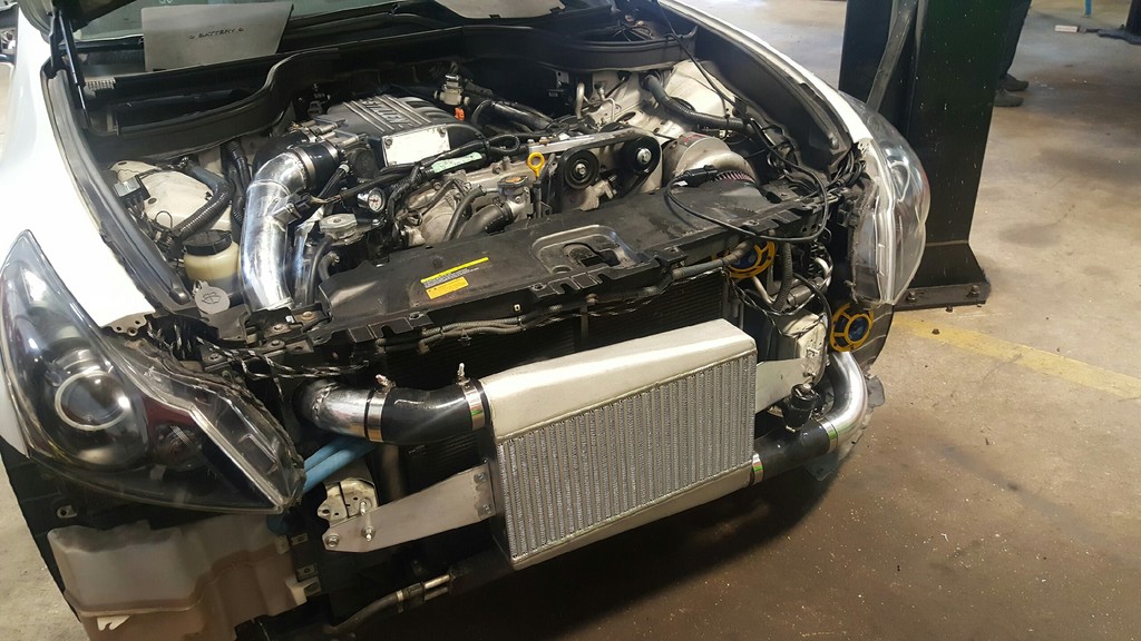

Yup, no sc on there, just the a2a. Only making 527whp. How much is your frozen boost getting ya?

Oh so cooler air doesn't make power? You should write a book. And I have sold that kit to over 20 guys. One of which is making 556whp. You have never heard of over 500 because that's on the water setup. That sucks. Plus it's got the mafs as pull through 7 feet from the throttle bodies. Mine are 7 inches and blow through measuring actual intake temps instead of telling the computer it's ambient when it isn't.

Topgunz knows what he's talking about. There a huge thread on the 370Z board about converting to A2A, and yes, it makes power on the Stillen kit. There are several posts of people who measured the AIT from the actual manifold (post aftercooler), and the IAT's skyrocket when you're on boost - even on the first pull. It's the size of the aftercooler that's built into the Stillen manifold that can't keep up. The FB HE helps (I have one on my car) but A2A is the way to go. If only it was CARB legal, I'd have one on my car.

In bold. What is the air to water subject to? Not Air? What is cooling your water?....yes, the same air that cools air to air. Except your tiny aftercooler is sitting inside of an oven at 200*F just baking away.
